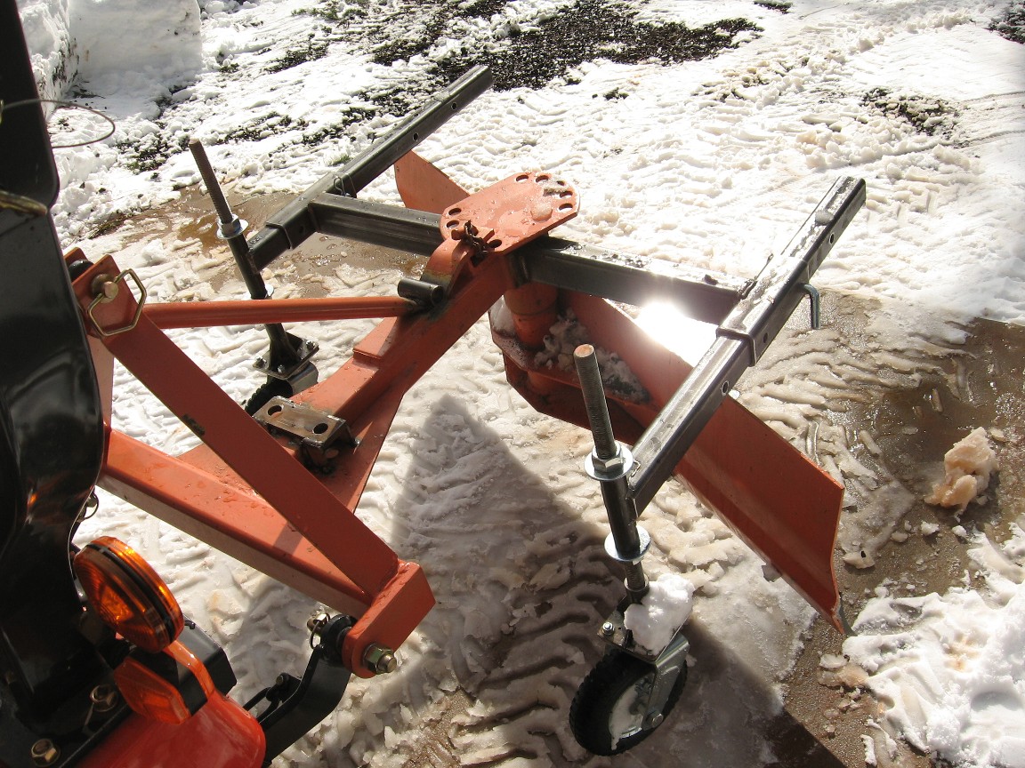

I really don't know what you can do to not leave some snow. If you get down to gravel then you'll be gradually (or not too gradually:() moving gravel when you plow. I use a method though that would let you leave only a very thin layer of snow, a rear blade with grading gauge wheels. What is good with this implement is that in the spring you turn turn around the blade, extend the wheels to the rear and have a wonderful road grading tool. In the photo I have the blade set to push backwards for a big snow like the snow picture (yea I know...not a big snow to some of you guys). For light snows I reverse and run like a regular grader; drive forward over the snow and drag the snow to the side.
With these wheels you can set the wheel height roughly what you need then fine tune with the top link. You could do a rough snow plowing pass leaving a couple of inches then adjust the top link to leave only a fraction of an inch on a second pass.
You run this set up with TPH in float position.
If you are a welder/fabricator I have a post I can find when I built these wheels or you could have a local shop fab a set. There are also alot of other posts on this site regarding gauge wheels. Where do you think I got the idea!
