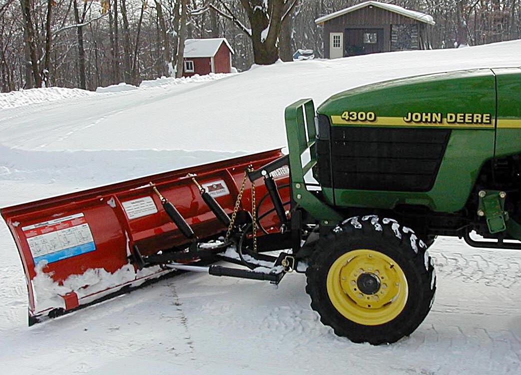

My vote, but only if it works for you.

Is a plow a lot better than the FEL? I have a 4' and 5' and 6' plow for my Allis Chalmers and the ATV and I find it hard to get the snow up over the sides of the pile. Any tips?
The plow should be wide enough to move the snow beyond the wheels when angled. I've seen a lot of narrow blades that don't get that part of the job done.
Tip: With a 7' plow, I can move the snow over even more by raising the plow and taking the top off the windrow (piled snow) and then going back to clean up the 6 or so inches left.
However, I'm working on a wing plow to do that for me, as well as push the snow over the edge of the drive and into the ditch. That should help avoid some of the serious drifting that happens.
Is a plow better than a FEL? A whole heck of a lot better. Night and day difference. Like going after it with a teaspoon vs. a scoop shovel. (grin).
