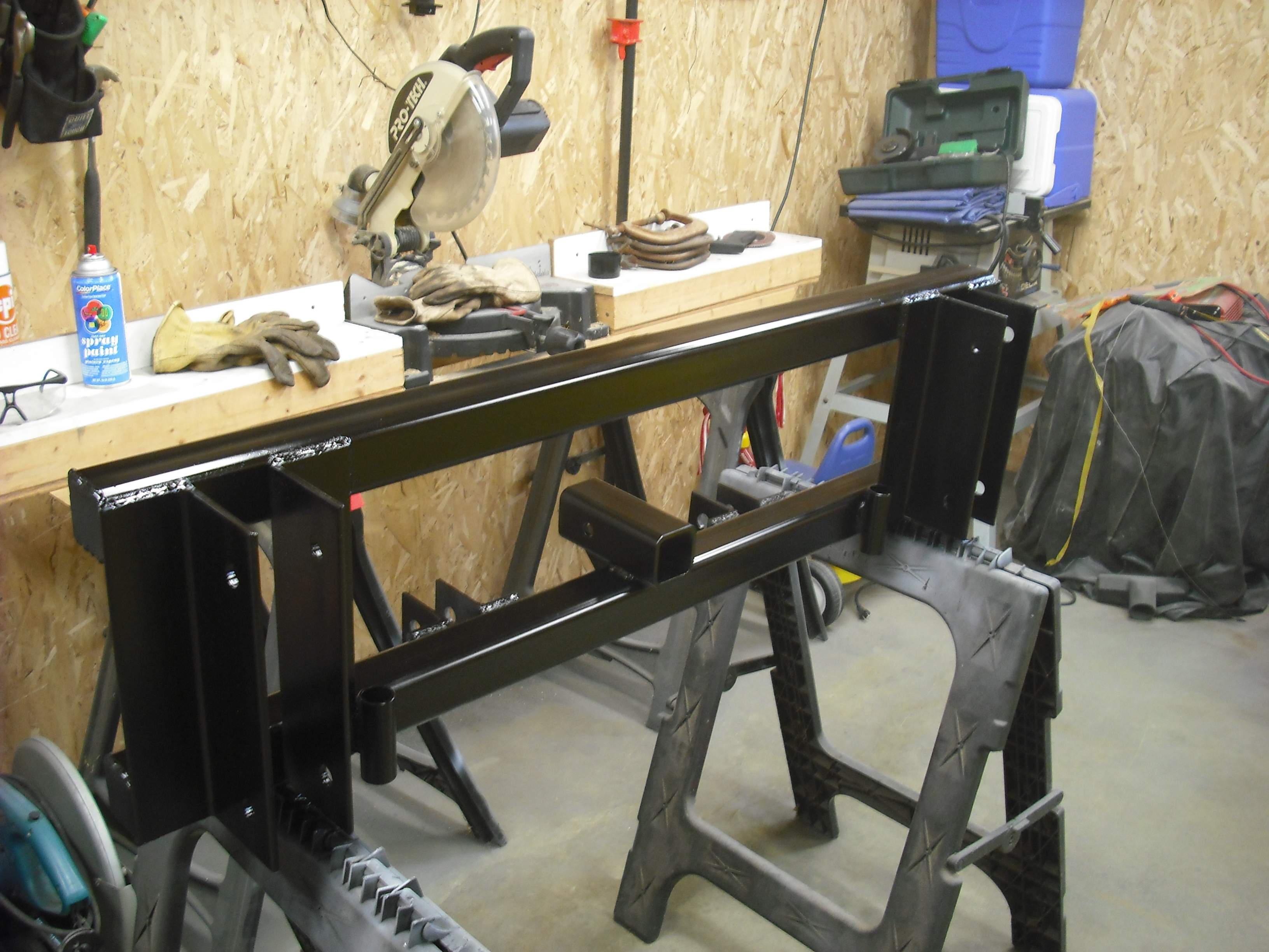

I think there are shoes on it. They may just be cut off in the picture.
I said: "I don't like the shoe-less plow mount. I think the frame will dig into the pavement."
You know....the big black thingie the snowplow mounts to on the tractor?
You need to read more carefully. :cool:
   / Snow removal quandry #42
I have never seen shoes on a mount. Thanks for clarifying that. ;)

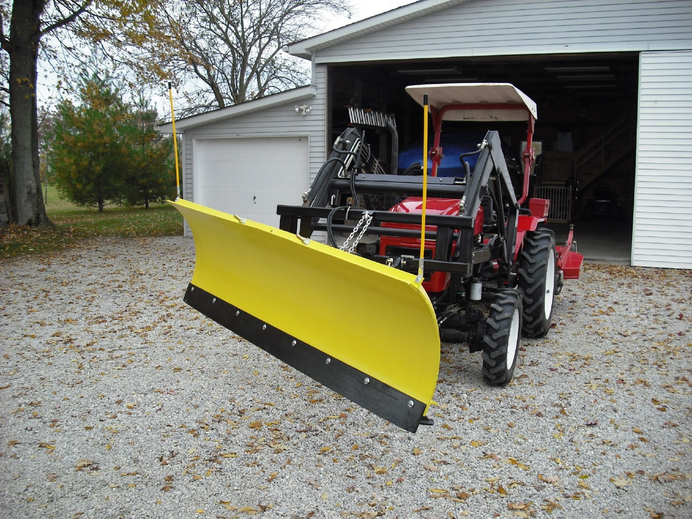

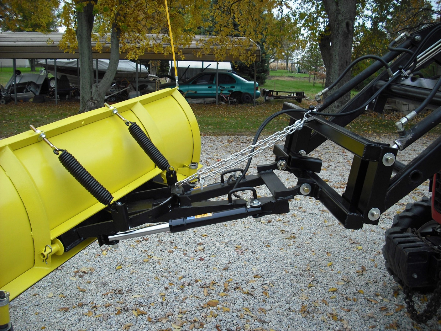

If you guys are talking about mine I did make provisions for shoes but do not have them on it now. When I made the mount I welded 2 pieces of tubing the appropriate diameter and about 4" long on the ends of the lower cross tube to accept them. You can see them in this picture along with the hitch tube I put on also. Have to admit I stole both ideas from others setups like Builders.

Is that an old Myers plow?

   / Snow removal quandry #48
Yes, got it off CL for $80 and rebuilt it this year. Used it last year as is. Here is a link to the steps and cost associated with the rebuild.
http://www.tractorbynet.com/forums/customization/155271-meyer-plow-my-tractor.html
Chris
Thanks for the link. I thought it looked familiar. I have one that I bought new back in 81 or 82. I used it on my Toyota Landcruiser to plow my parent's driveway. You see, I had to shovel it by hand from the time I was about 8 into my 20's and it was quite long. :rolleyes: After high school I had several jobs while living at home and paying my way through college. Since I had some extra cash, I bought the plow to make some side money and get my home chores done faster. I still remember the feeling I got the first time I used it and had the driveway done in two passes. 5 minutes with the plow VS an hour with a shovel. Zip zip and done! :) After I moved out, my dad bought a snow blower. I asked him why he waited so long to get the snowblower and why he didn't get one sooner. He said he had one... his son! :D
