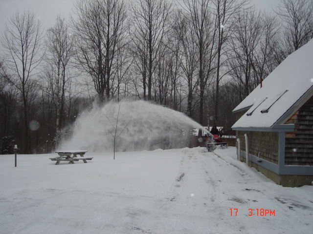

Without a doubt- a front-mount blower. Quite a bit more expensive than a plow or a rear-mount blower, but once you have it....
No snowbanks; one pass does it; blower keeps roadway clear for traction as you move forward. The distance these things throw, even on a SCUT, is impressive.
