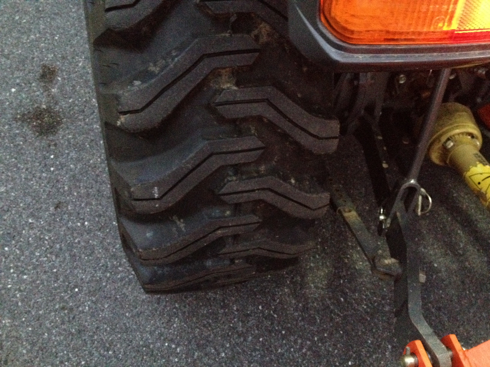

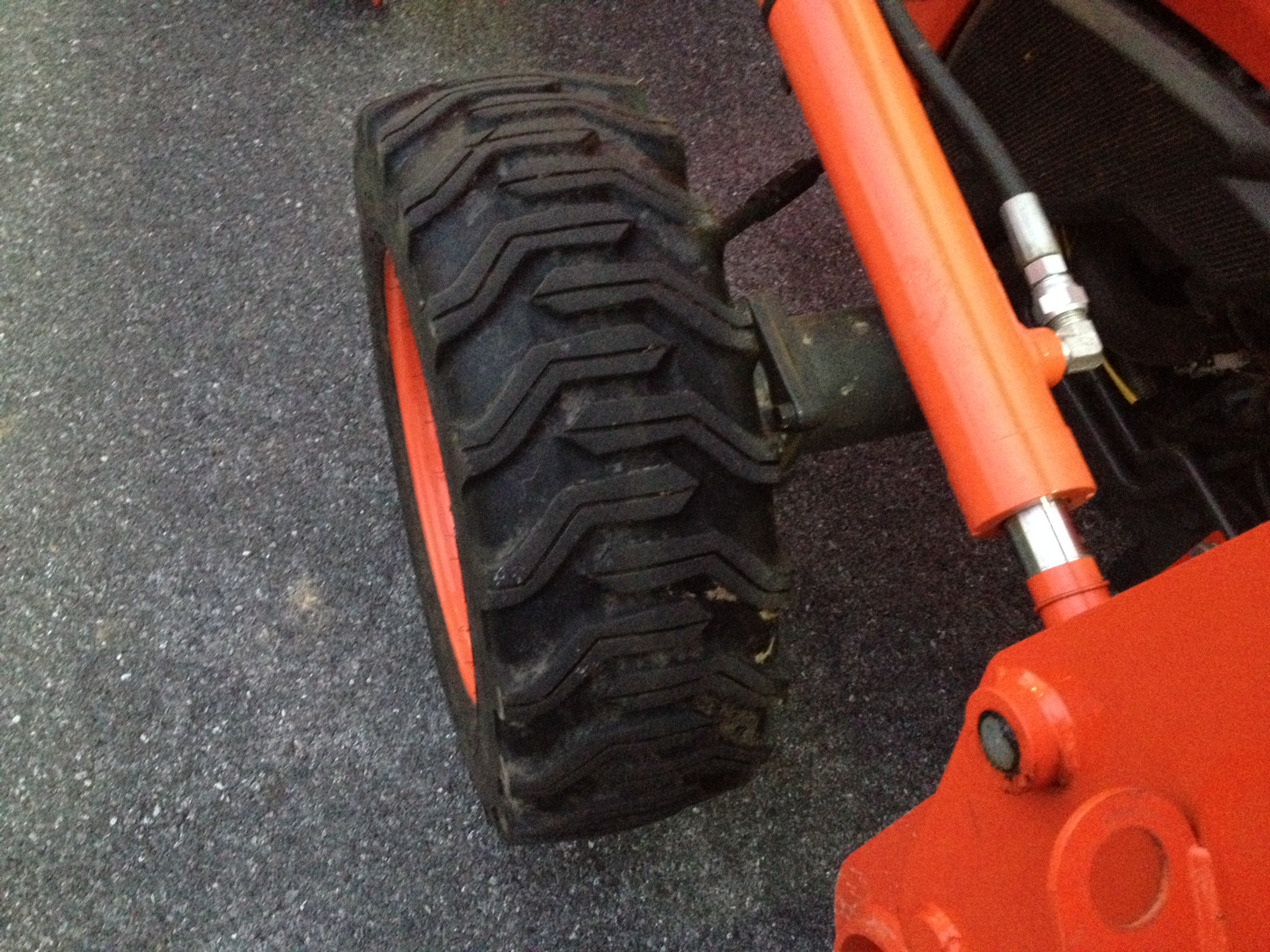

My Ford has R1's and it has handled a 5' rear blade just fine since I bought it in 1992. When the tread wore to nubs - particularly the front - I found replacements. That was back around 2002 or so and it was difficult to find "real" R1's that had the same heavier and taller ribs as the originals. Rears were found about 1//2 hour away and the front tires necessitated a day trip to the other end of the state. A few years ago we decided to do our own snow removal at the church, so the Ford spends its winters there. This past winter it did just fine with a 6' rear blade.
The 2002 B7500 and the 2012 L3200 that replaced it have done fine with R4's. Last fall I grooved the R4's on the L3200 and it seemed to do even better. Last night I mowed with the Kubota (6'RFM) and the grass was wet. I went sidehill/up/down on a pretty good slope in 2WD and it was sure-footed regardless of what I did.
Here's the Ford with the R1's and the grooved R4's on the Kubota. (Still have no idea why some pics don't show as thumbnails)
