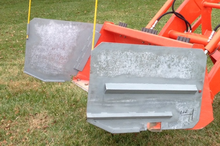

I also made side extensions that lock on the loader bucket and are each held with one bolt. They make a difference when pushing snow.
Do you have a picture of the extensions?
They're 10ga with angles stitched on for reinforcement. They attach with one bolt each and a couple sandwiched pieces of 1/4" flatbar. The stepped flatbar creates a pocket that slides over the side edge of the bucket. The location of the bolt forms more or less a triangle between the two ends of the flatbar pockets and the bolt. That locks the extensions into place so they can't move. They have worked well and there's no evidence of damage to anything but the skids.
The bottoms of the extensions have small skids made of light angle iron. After using the extensions this past winter, the skids proved to be the one part that needs attention. The angle iron has worn quite a bit and should be replaced. I'm thinking about trimming the bottom of the extensions an inch or so (forward of the bucket only) before replacing the skids so they only make casual contact with the pavement when I have the bucket tilted a little too forward.

That looks simple enough. Thanks for sharing.
I find the bucket to be very useful for cleaning up after the driveway is plowed, except for when the snow dribbles out the side.

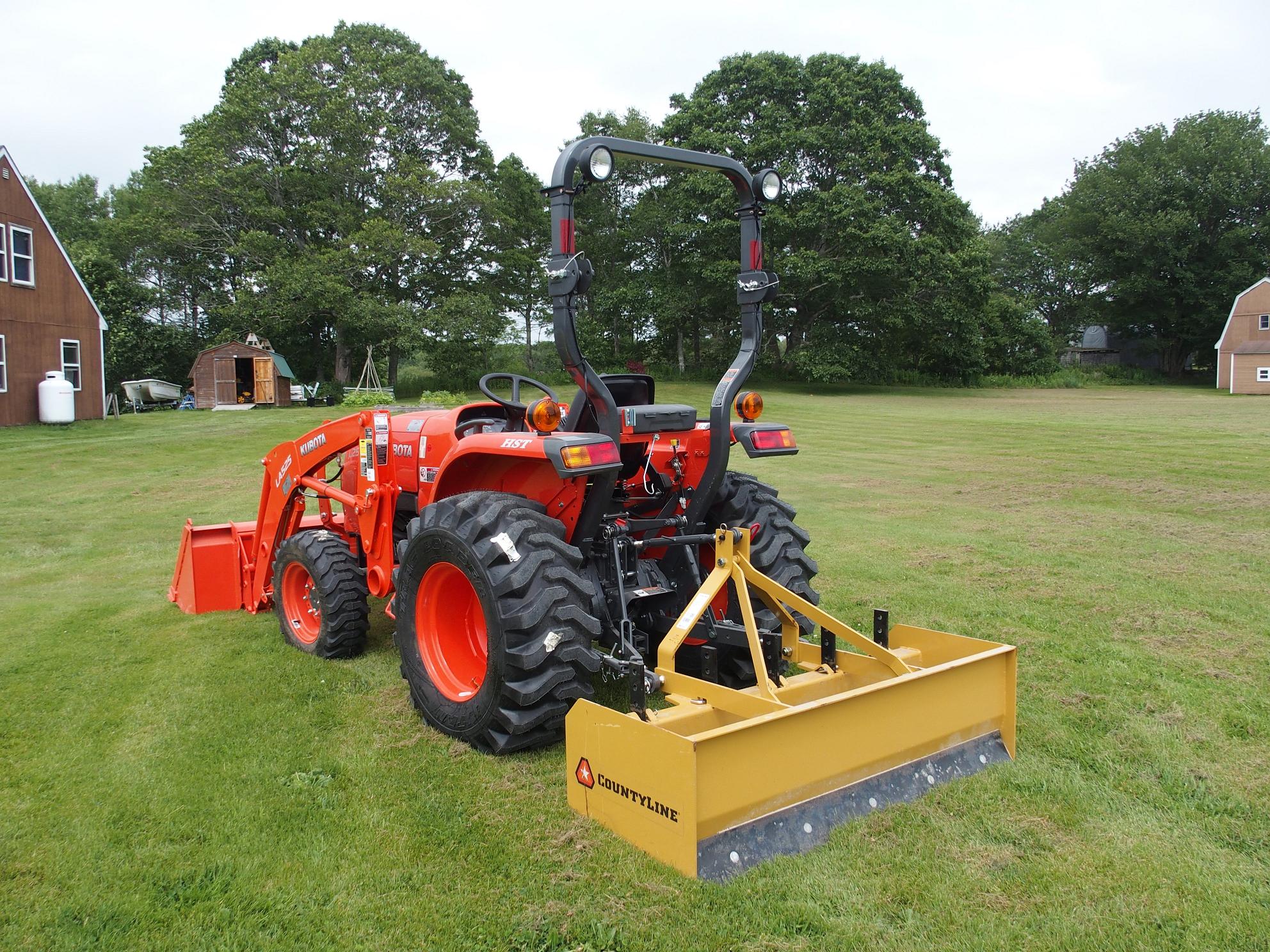

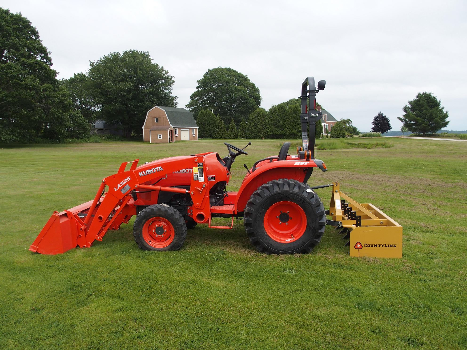

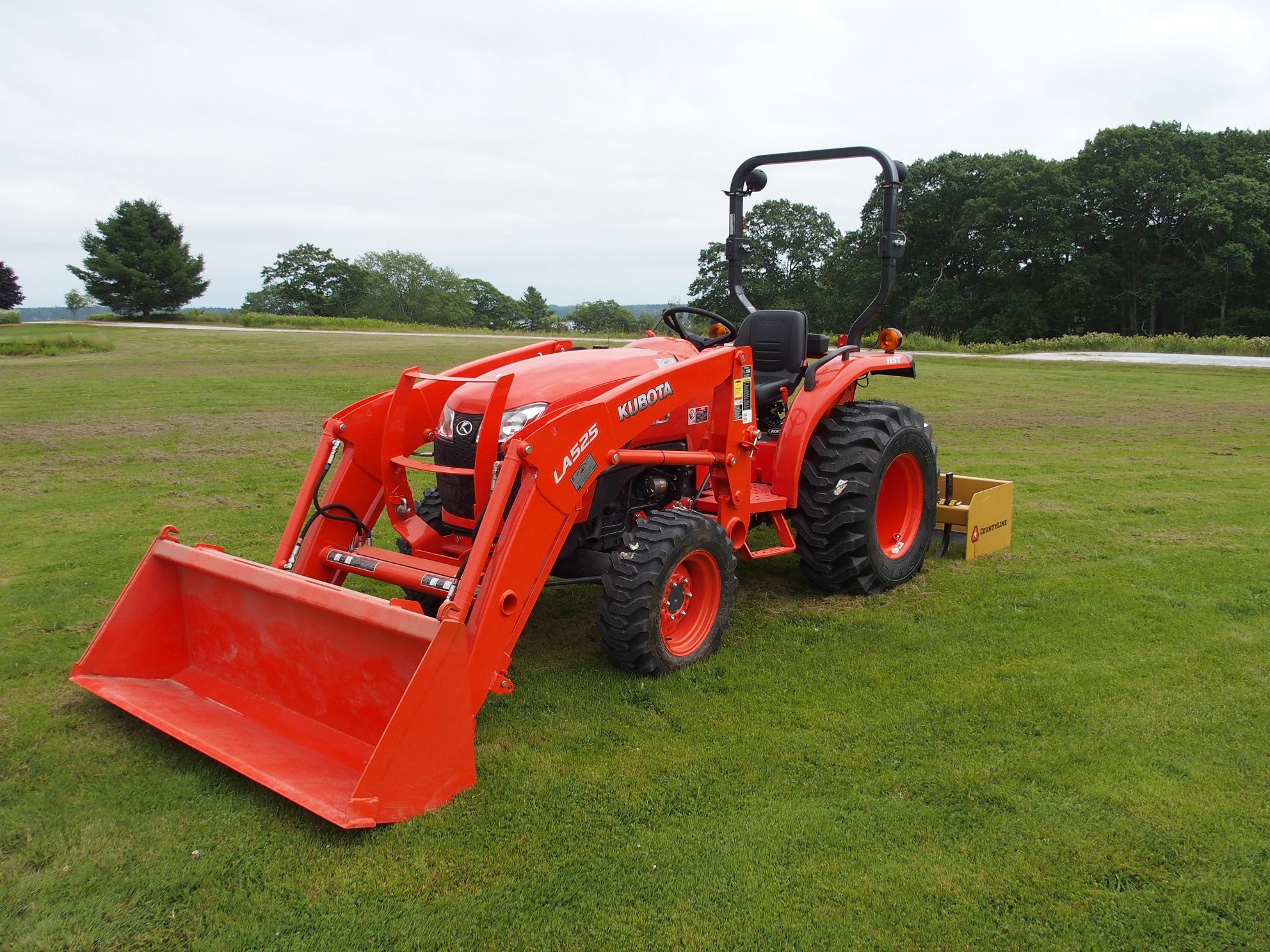

The power for the snowblower arrived today. Blower itself on order. Lovin' the ssqa bucket and forks. Gotta' order chains next.

Nice looking tractor.
   / Snow removal tractor setup questions. #29
Congrats on getting your new tractor home!
