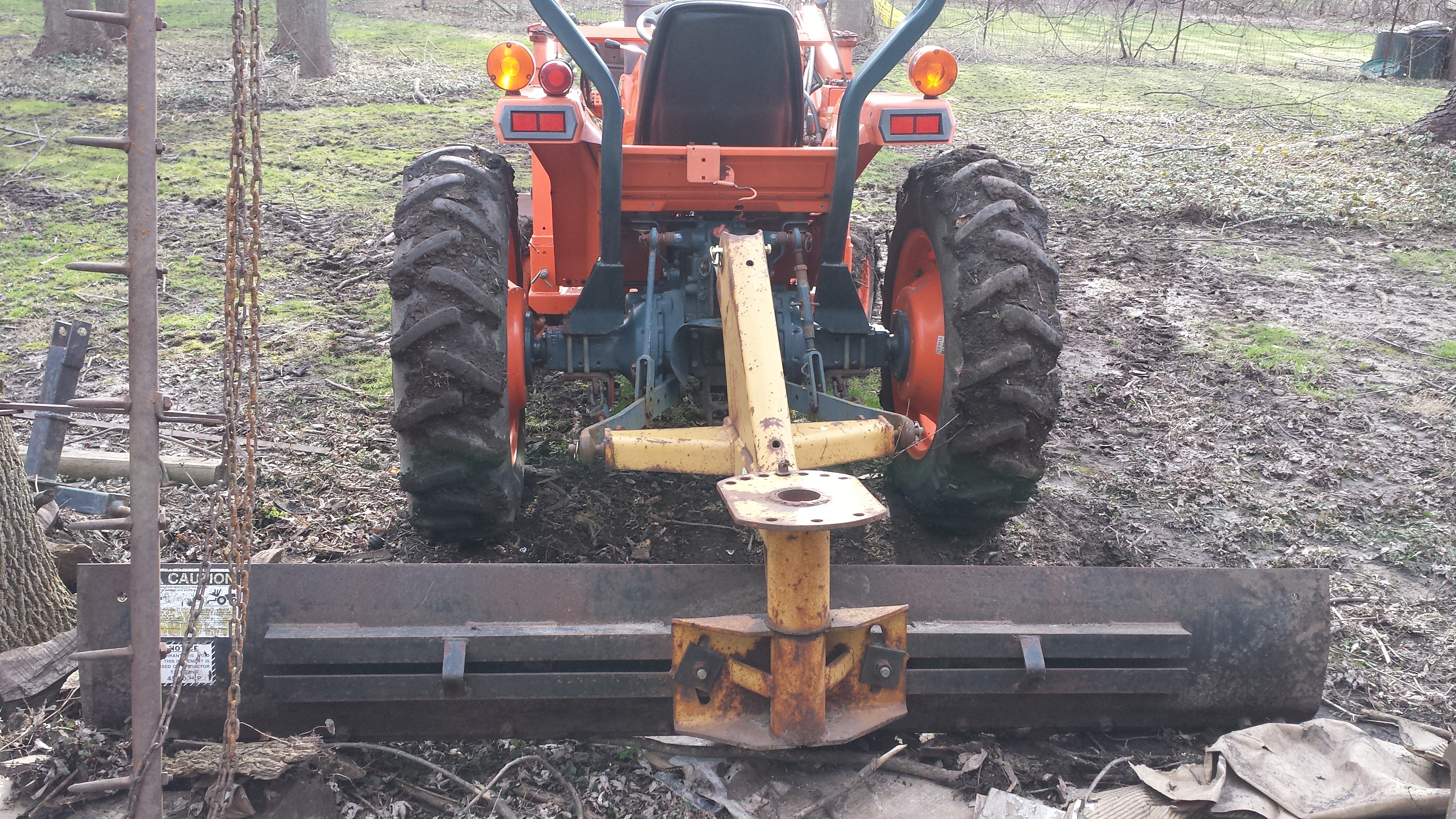

I bought this today... it's an 8. I really was looking for a 6. Should I cut it down? It seems like it will be too big for the tractor, especially when I get a load in front of it.
View attachment 461393View attachment 461393
It needs to be at least 1.15 X the width of the rear tires, so that it will cover your tracks when angled. I wouldn't cut it down without some measurements first, and then not until using it for a few times. May be just fine.
bjorn I have a buddy that lives up there, Skip Myers. I visit him now and then.
Anyways with the rear blade, at the most angle it should cover you tire tracks. You may even want it a tad wider if you ever have install rear tire spacers or you have reversible rims for extra width. Dont know if your model actually does that.
I can also completely swing my blade around-180 degress if and when needed, rarely, but nice.
You could carefully measure and make your marks, but use it awhile to see where you stand before cutting it down. Then give it a nice coat of orange paint!

My tractor is 65" wide.... that's 1.47x my width. The rims are pretty deep offset, wouldn't be able to reverse them. The blade does swing around 180 degrees. I'm planning to put rear hydraulics on the tractor, an angle cylinder for this blade may be part of that install.
I would keep it at 8 for now. Give it a try. With the 8 footer, you could have a much steeper angle on it to help it scour the snow better. With the steep angle, you could let it clear only 6 feet of width. You can always cut it down later.

bjorn, I would guess that after you use it in a real snow, you'll find that the wide blade will push the tractor to the side when a load of snow gets built up. Using rear chains will be a big help (sorry if I am repeating someone's earlier advice) in controlling that- and providing traction in snow.
You can always cut it down later. I suppose you could always weld the cutoffs back on, as far as that goes. I found that my biggest problem with a rear blade was leveling it for sloped or crowned surfaces- now, our front plow floats from side to side, and is heavy enough to follow the surface, so no problem.
