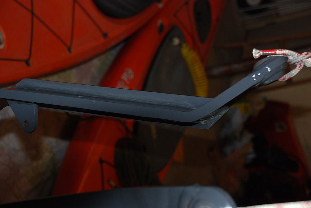

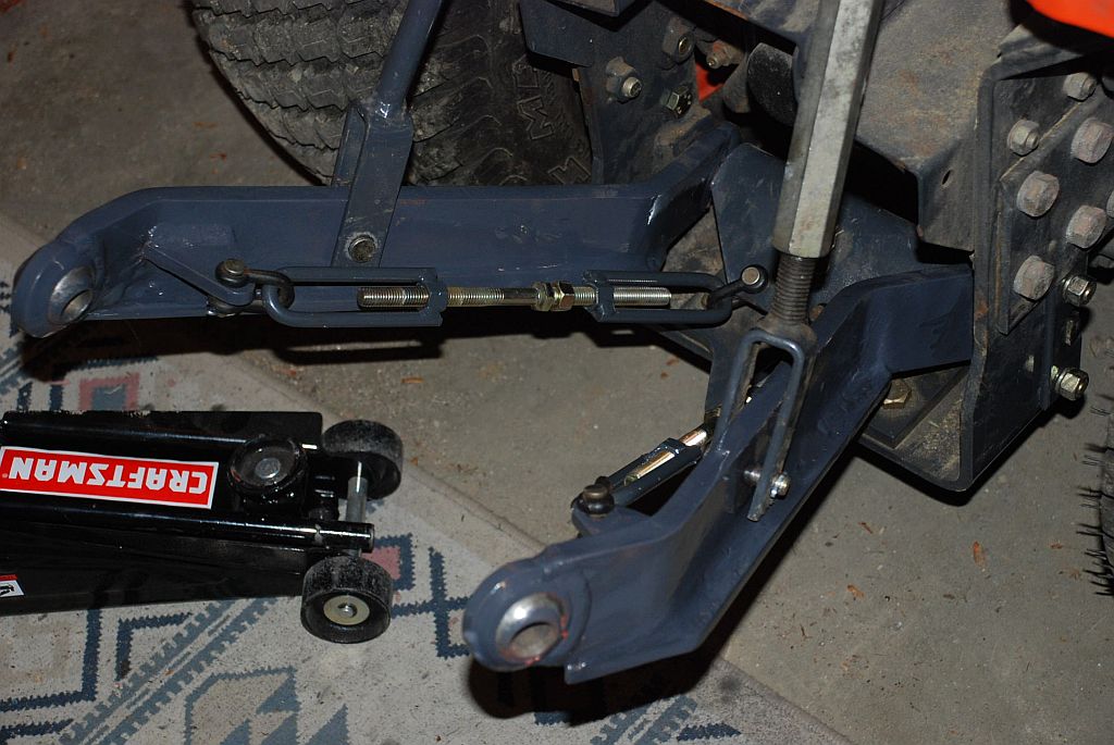

I would go slow pushing the blade like a plow in reverse....I hit a frozen snowbank last winter and bent one of my drag links (lower lift arms.) 3RRL suggested a reinforcement for the lift arms that I went with and have not any problems since. You can search for 3RRL's thread on the topic, but don't be surprised if you get sidetracked reading any of his other threads...very creative and interesting stuff. If you decide that you are going to be pushing the blade backwards a lot, I wouldn't wait for the links to bend, they are amazingly hard to straighten in a ill-equiped home shop, ha! I've included pictures of the link reinforcement I added on the bottom of the drag links. Have fun with the new rig and keep us up to date on what you settle on for snow removal. Dyer, retired
