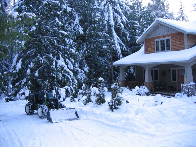

We've just suddenly gotten dumped on out here in the PacWest. In the past three years this is the first time we've gotten anything but more than a couple of inches (that stick) where we are. Not so this time around.
The season started off with a couple of very light snowfalls. The PT425 cleared our drive and straight up our steepish hill without a problem. Heck, I had so much fun I even cleared 800 or 1000ft of our community road using nothing but the big bucket--since it never really snows here I didn't bother with getting a blade but that would be the right thing and would make a PT425 quite a snow plowing machine. Except for one thing: traction.
On snow that packs really well, the PT425 with bar tires starts to slip quite readily. Despite it's quasi-4WD system, one wheel will spin away happily on its own. I guess chains would stop this to some extent but as soon as there's one wheel with less friction than the others the PT425 will always struggle. If this thing only had some sort of limited slip it would be so much more awesome.
Even with these shortcomings the machine made it up at least half of our drive before starting to lose grip. I actually couldn't go up forward, I had to go up backwards up. I figure that's because the weight of engine helps out quite a bit (the other part of the problem is the PT is such a lightweight). Sadly, if it's not traction on its own that gets you, it's the fact that the PT threatens to stall on the way up as it furiously spins its wheels. Sigh.
Just so you know what I'm dealing with...we had about 8" on the ground when I started to plow. It's still snowing.
On reasonably flat ground I would heartily agree that the PT425 has lots of snow clearing ability. Get chains. Get a blade. After that, you've pretty much maxed out this system and should consider something more capable.

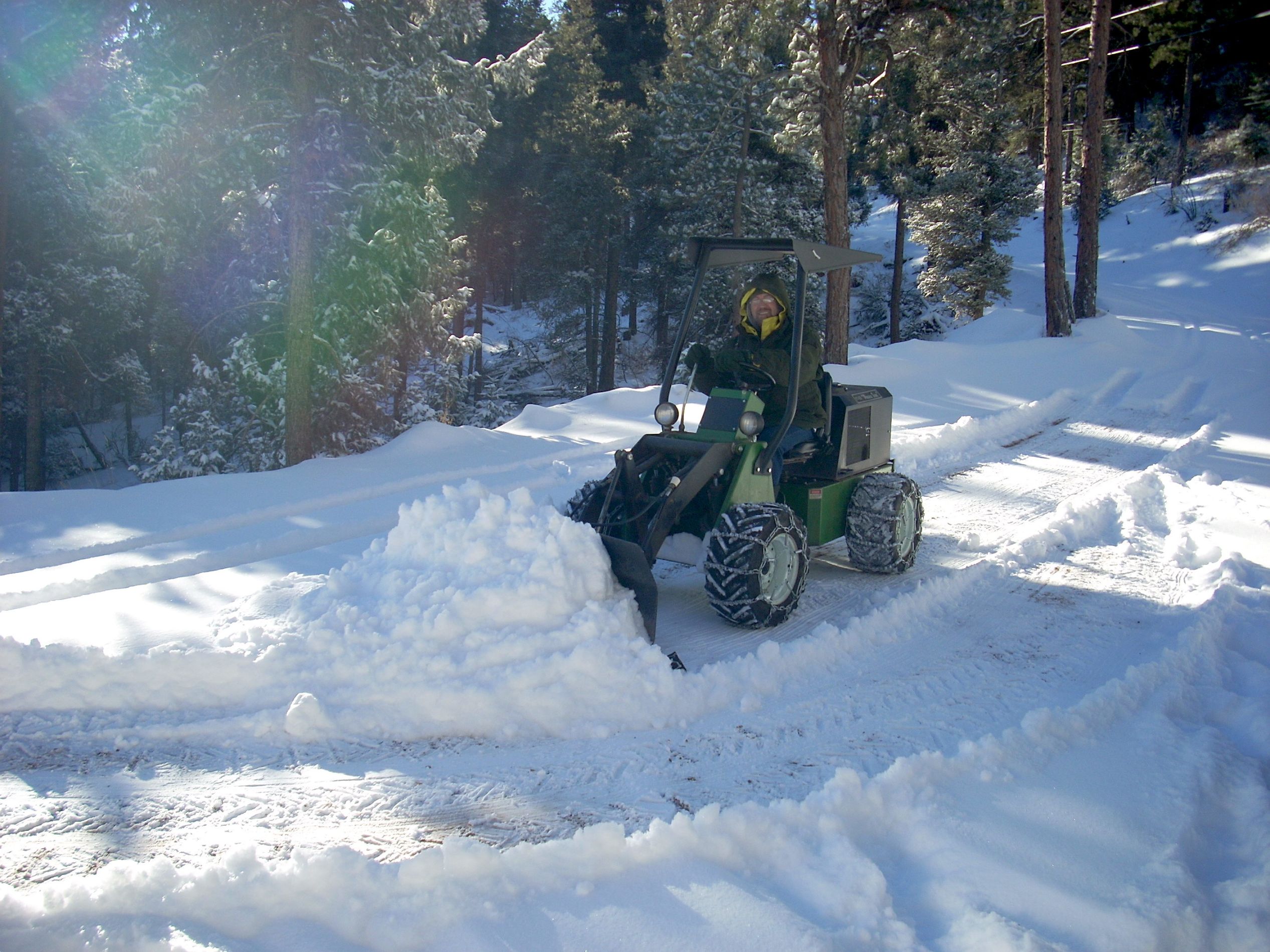

Here's a photo from fall of 2007 when I first got tire chains for my 425; since then, I've discovered that with chains I can move a LOT more snow without "crabbing" or sliding.
Previously, I couldn't get up the steep part of our driveway (800' long) with the plow up. With chains, I can plow uphill!
Too cold so far this year to take any snow removal pictures, but I will do so if we have another 3' or more snow or two in a row.

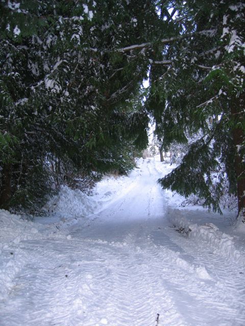

I finally managed to clear my driveway all the way to the top. Then I threw 3/4 minus on the steepest bits and dirt on the rest. Got the Ridgeline up to the top without any slippage whatsoever. Then it snowed another couple of inches the very next day! And then another four inches this a.m. 'Course I left the truck at the top once I got it there.
Funny how the amount of snow and the steepness of the driveway aren't reflected that well in a photo.
