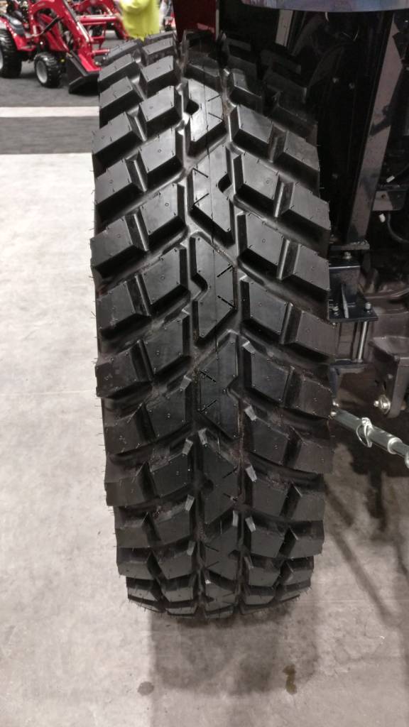

If I am not mistaken, this thread references tractor "winter" tires
   / Snow Tires by Massey Ferguson? #26
With the extra sipes in the tread blocks, I bet they are wonderful on icy conditions.
those look like standard snow tires like you'd see on a car or truck, a lot of rubber to reduce wear on paved roads, a compromise..

I just got back from the farm show in Syracuse, NY. Massey Ferguson had what they said were radial "snow tires" on a 1760M. The dealer I spoke with said he knew nothing about them as they just came out.
Has anyone heard/had any experience with a tire like this? It seems compelling for primarily winter usage, which would be applicable for most of my use.View attachment 593100
I just got a set delivered today, I just had to put them on (before I painted the wheels) to check them out. In the snow at least they seemed to behave equally with pulling power but was better steering. Better means than the regular ag tread with studs. As far as I can see they are fairly equal so far, and should far out last them with all the rubber contact.
I see a lot of them now on backhoe's & road graders for better road service life. It's early but I can see a pair of them on the rears when they need replacing. From my limited "shopping" for this style tire, I did well @ $1400/pr. delivered and on wheels. They are new "take offs" from a sprayer but still had the fine rubber "hairs" on the sidewall & tread.
