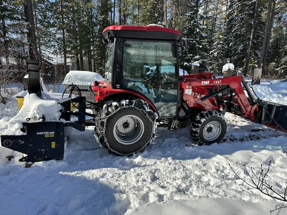

Thanks for all the advice. The problem is here that for the first month of winter we get a big dump of snow when it is still hovering around 0, then it will warm up and melt etc. Not like the prairies. But I am going start with some of the advice here before I go making modiciations to the blower:
  • do a run with bucket at upward angle to create packed base
  • adjust the attack angle of blower (I noticed that it is currently pretty aggressive)
  • If the above don't work, I'll try welding a big of pipe on the shoes/slides to make them float a bit better.
Thanks!

Same thing here today. Only thing to do is raise the blower and leave enough snow to pack down with driving over it. Anything that I have tried has not helped. Ground is too soft and any interaction with it just digs down.
These early snows, we got about 14”, I use a back blade to cut off the top 10-12”, leave 2-4” to pack down. Blowers is way too heavy and digs in.
this, Colorado also. I only put the blower on if we have a big snow and/or I have to do my neighbors switchbacks for them. The blade creates too much resistance and side slope on the uphill run to their house trying to push me down a very steep slope.

I maintain a couple driveways and when the real snow comes, about 1/2 mile of gravel road. We get 220-270" per season, and I use a Frontier 74" PTO (rear) driven blower. I adjust the tilt so the skid shoes are slightly up early in the season to build a snow mat, and once the mat is established, adjust the top link for a level or slight down bias on the shoes. I put a hydraulic top link on this year, so making that adjustment from the warmth of the cab is awesome.
Another commenter said he doesn't rake stones out of their yard because they don't shoot any with their equipment. I don't rake stones either. My wife does it...........division of labor! Maybe someday I'll be good enough that she won't have to.
FYI- I run 10mm square alloy chains on the back (over filled tires) and diamond style 3/8" studded chains on the front.

Had the first dump of the season, so i got to try out the ne (to me) snowblower. I threw a lot of rocks. It was only 0c so the ground was soft and the shoes sunk. I tried to control the sinking with the 3pt hitch raise/lower but it was tough to get it right. The driveway is slightly higher in the center and so I think I was picking up rocks there. I was thinking of a couple solutions. 1. Weld a 4-6" plate to the shoes so the dont sink so much. 2. Weld a 4-6" plate to the center to prevent the center from getting too low when side shoes hit the soft ground or low ground. 3. Do both of the aforementioned options?
How have others solved this?

It isn't necessary (at least to many) to remove every flake of snow. I bolted some 1¼" square hardwood 6" long with 45° cut on each end to the 'shoes'. Works for asphalt too to keep from wearing out the 'shoes'. No rock throwing ever.

Loaders and snow blowers have the same problem. They work much better after the ground is frozen. I generally leave that first couple inches of snow and drive it down so the rocks are covered and let the ground freeze then you can let it down and go without worrying about taking the driveway gravel with it.
