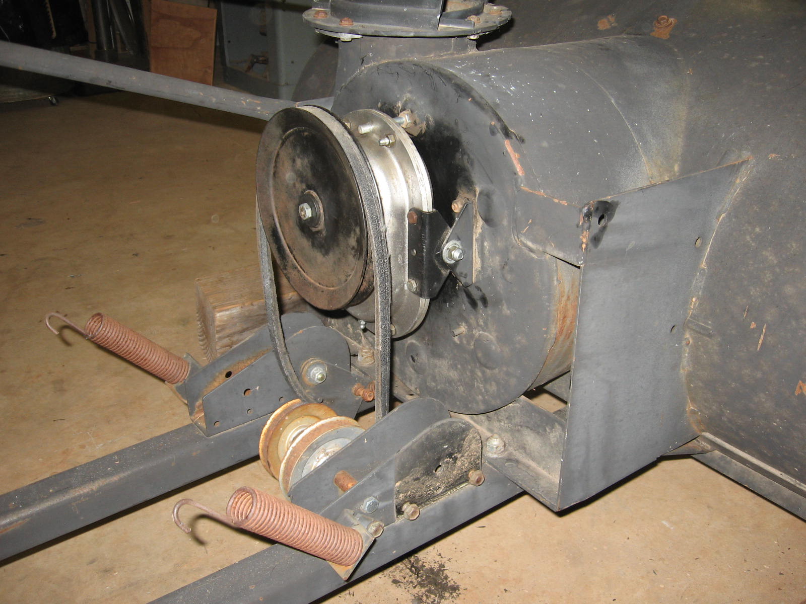

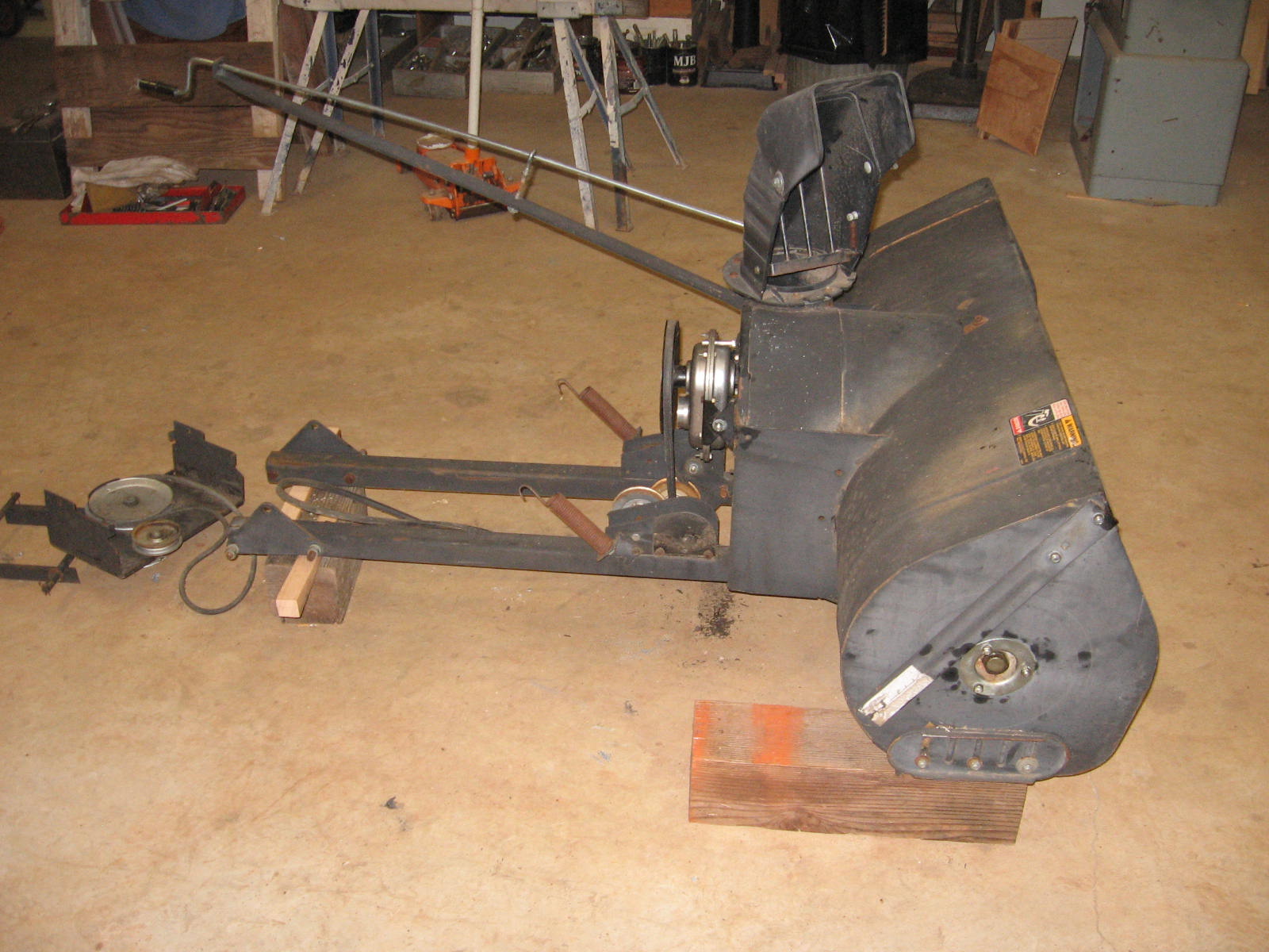

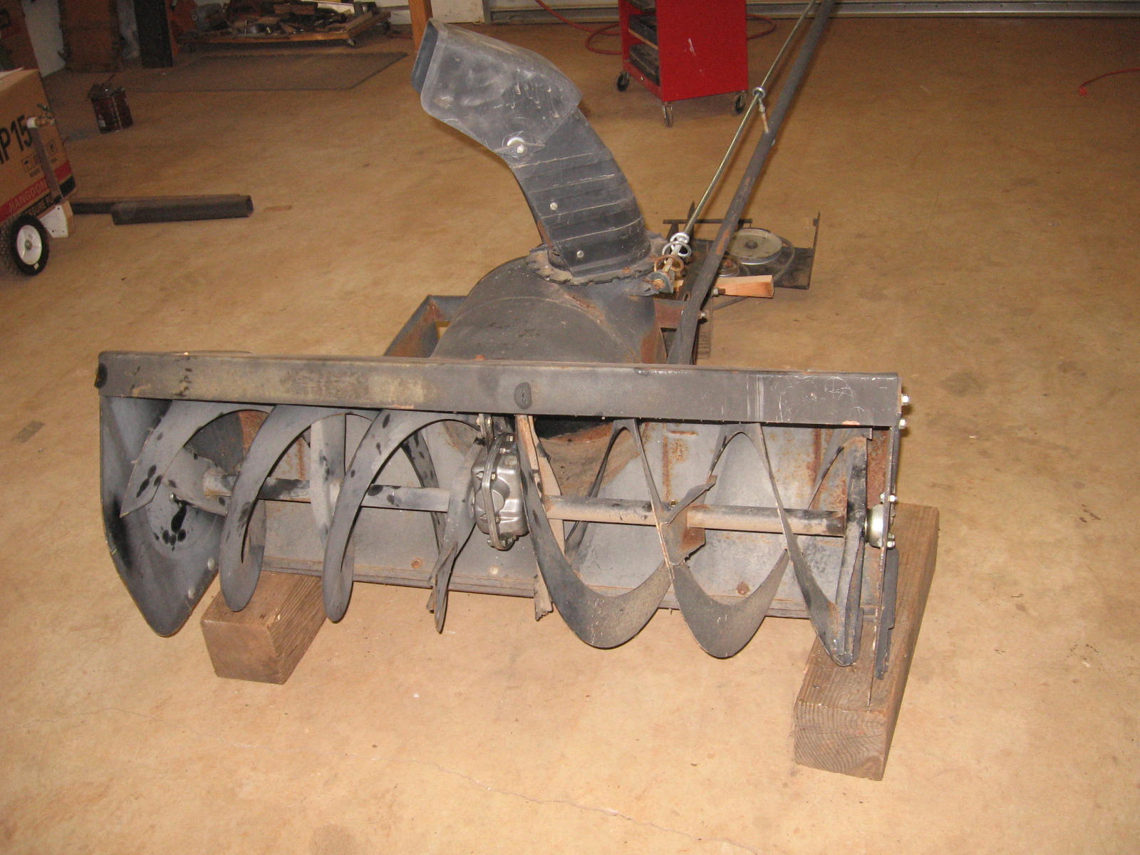

This is what I started with:
The unit was built for the front of a small garden tractor and was belt driven from the mower deck pulley via a chain drive gear reduction box:

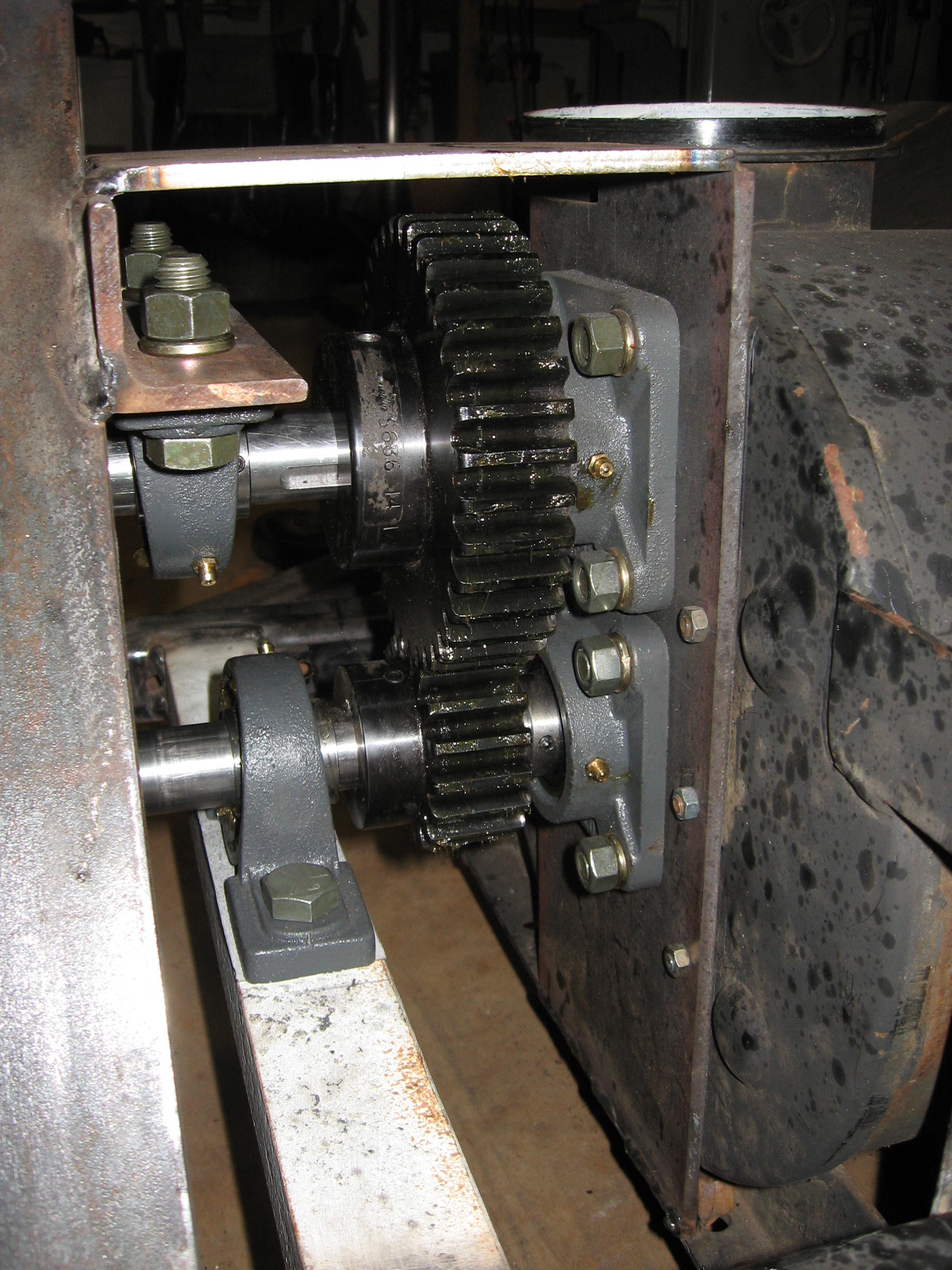

You will notice the rotation of the impeller is opposite of that normally found on a TPH machine. Not only did I have to reverse rotation I also had to change the gear reducer to a speed increaser. Belt drive would have been the cheapest method but although I could get the rotation reversed fairly simply or the speed changed as individual drives I had difficulty designing a combination belt drive that would do both efficiently and compactly. I considered a sprocket drive but it became rather cumbersome. I finally chose a gear drive.
Gears are expensive and they got more expensive when I learned enough about them to pick the right ones. Rush Gears.com has a great engineering tool that helped considerably.
My post regarding impeller speeds led me to look at impeller tip velocity rather than RPM. I was designing around a 4000ft/min tip velocity. To get this from my 14" dia impeller and 540PTO speed I needed a 1:2 increase in speed to get 3953ft/min at the impeller. Using the Rush Gear tool I chose a 6"dia PTO gear and a 3" impeller gear. These are #6 gears with a 1 1/2" gear face to withstand the 16HP PTO.
It took almost a month spare time to research various designs, draw and reject several plans and come up with a final design. Here's my plan. The bottom right drawing is the blower in working position. I was trying to keep my lower and top links fairly flat as well as keeping a small PTO shaft angle. The Upper right is the blower raised. I don't know if I'll ever need to lift it this high but I was looking to see if there was any binding in the linkage, specifically the top link. This view primarily showed me where to place the tie for the TPH "A" frame. The left drawings are the bearings and gears viewed from the tractor. The design added a 1/4" plate to the back of the blower housing to add strength to attach the two flange bearings. The cross members carry pillow bearings. The shafts are 1 1/4" dia.

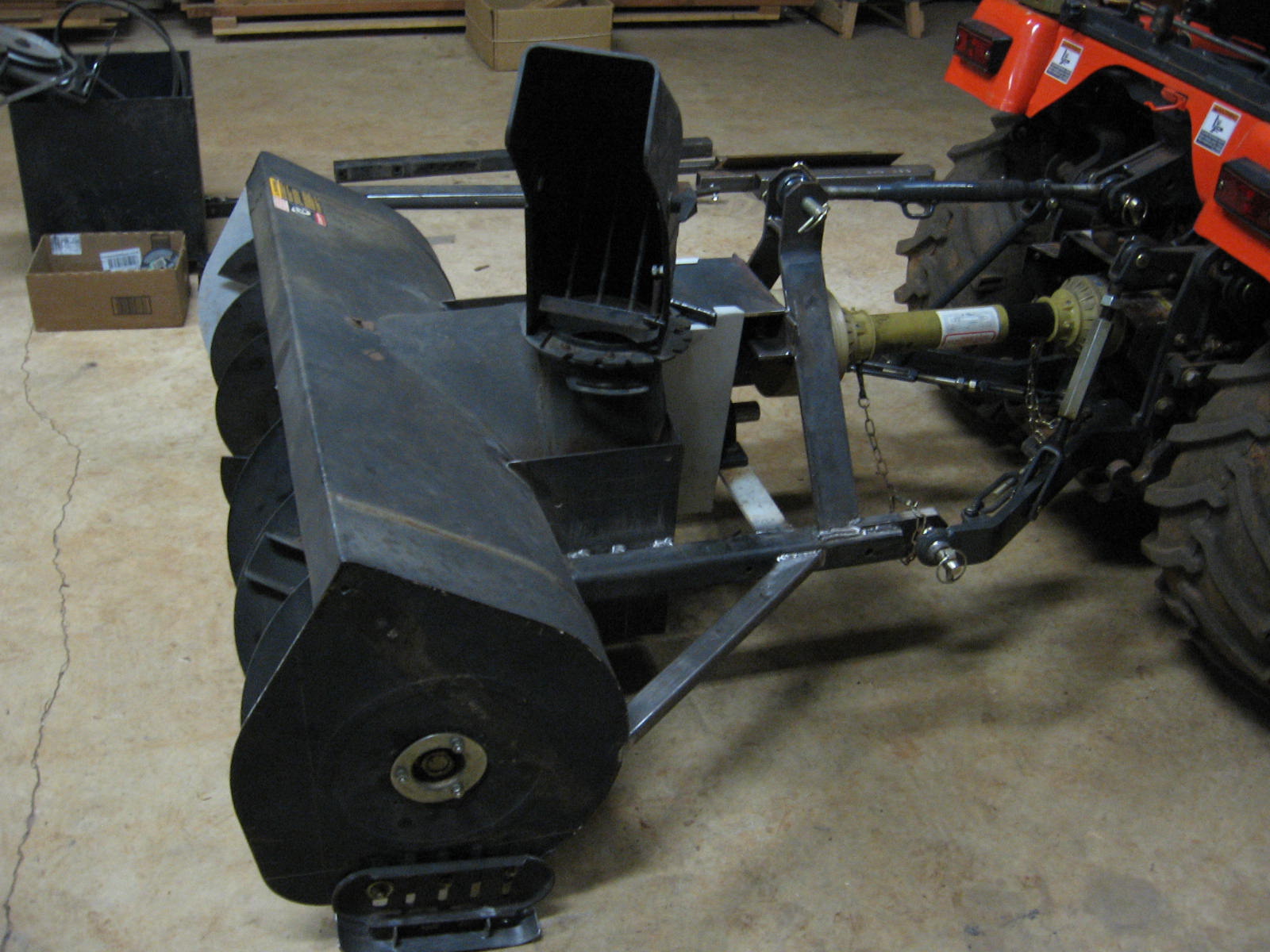

Here is a pic of the almost finished conversion. Next posts will go into the conversion in more detail.

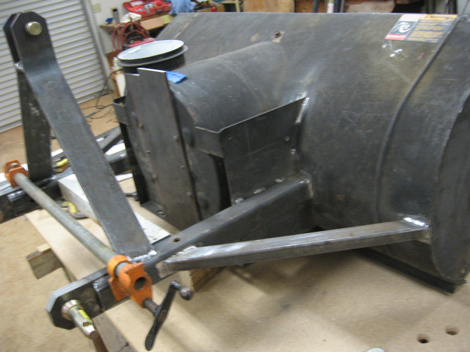

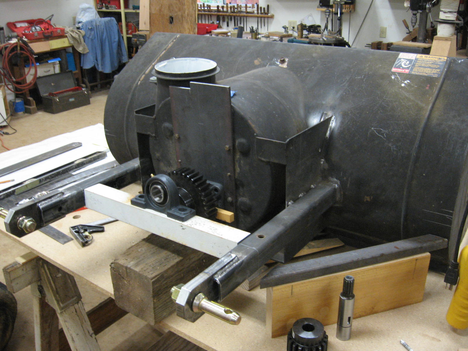

I ordered parts and started on the TPH conversion while awaiting their arrival.
Once gears and bearings arrived it was time for the milling. My good friend and former college shop instructor graciously offered me his fine machine shop and services. I mostly watched. We needed to lengthen the original chain drive shaft so it would extend to the pillow bearing. He machined a "V" groove in the original 1 1/4" dia shaft and a 1 1/2" dia extension piece, welded them together, then turned them down to 1 1/4" on the lathe. Then he bored the two gears to 1 1/4" and cut keyways in the two shafts.
Next we had to mount the four bearings for the correct pitch diameters and gearlash.

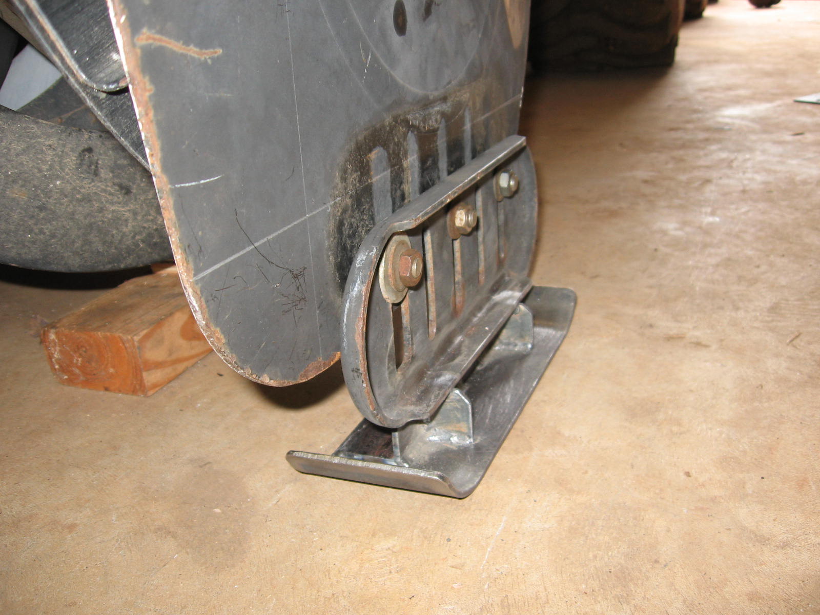

Owen did not have a keyway broach large enough for the 5/16" keys and 1 1/4" bores so the gears went out to a commercial shop for this work and I took the blower back to my shop where I fabricated gear shields, cut and fitted the PTO shaft and modified the existing skids.

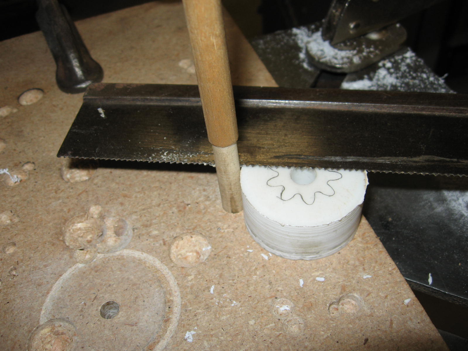

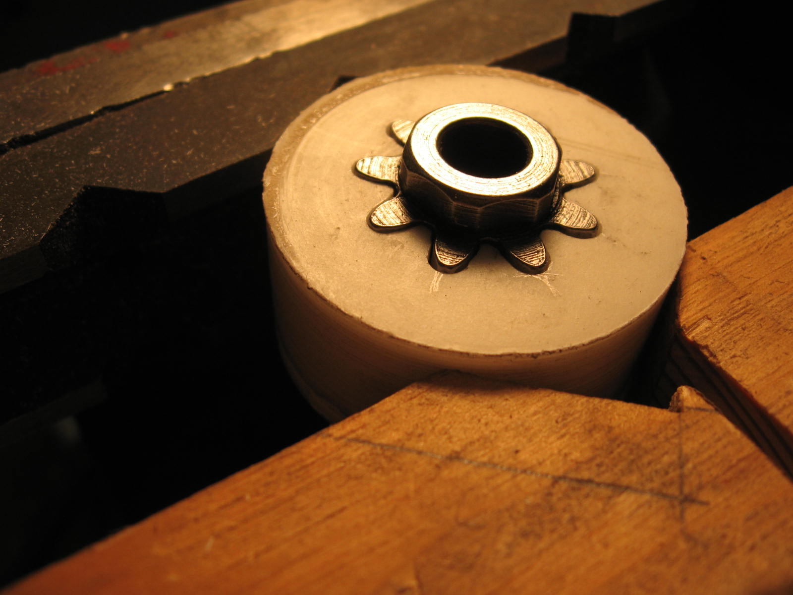

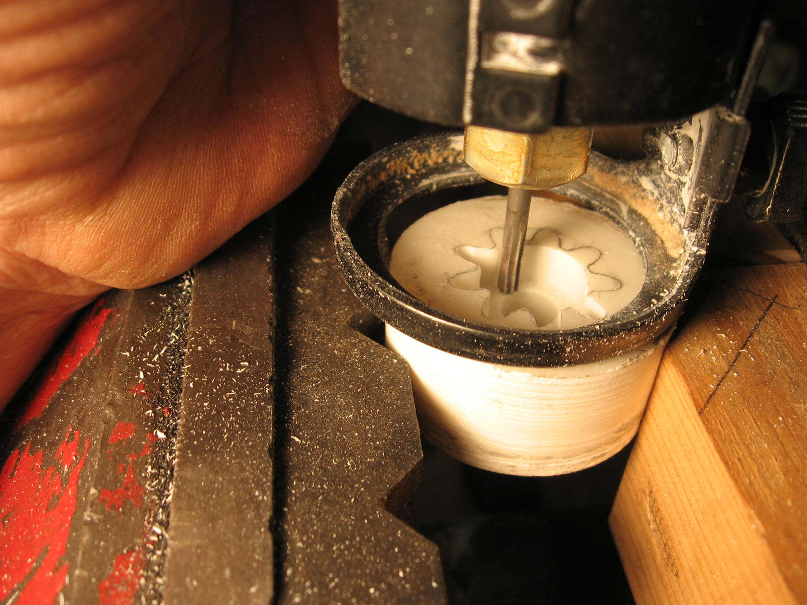

The original blower used hand crank to a wire screw drive. I had thought to use this while testing the blower then convert to a powered rotator later. The screw drive had a terrible fit and would have taken considerable work to have it run well so I went ahead with the power drive.

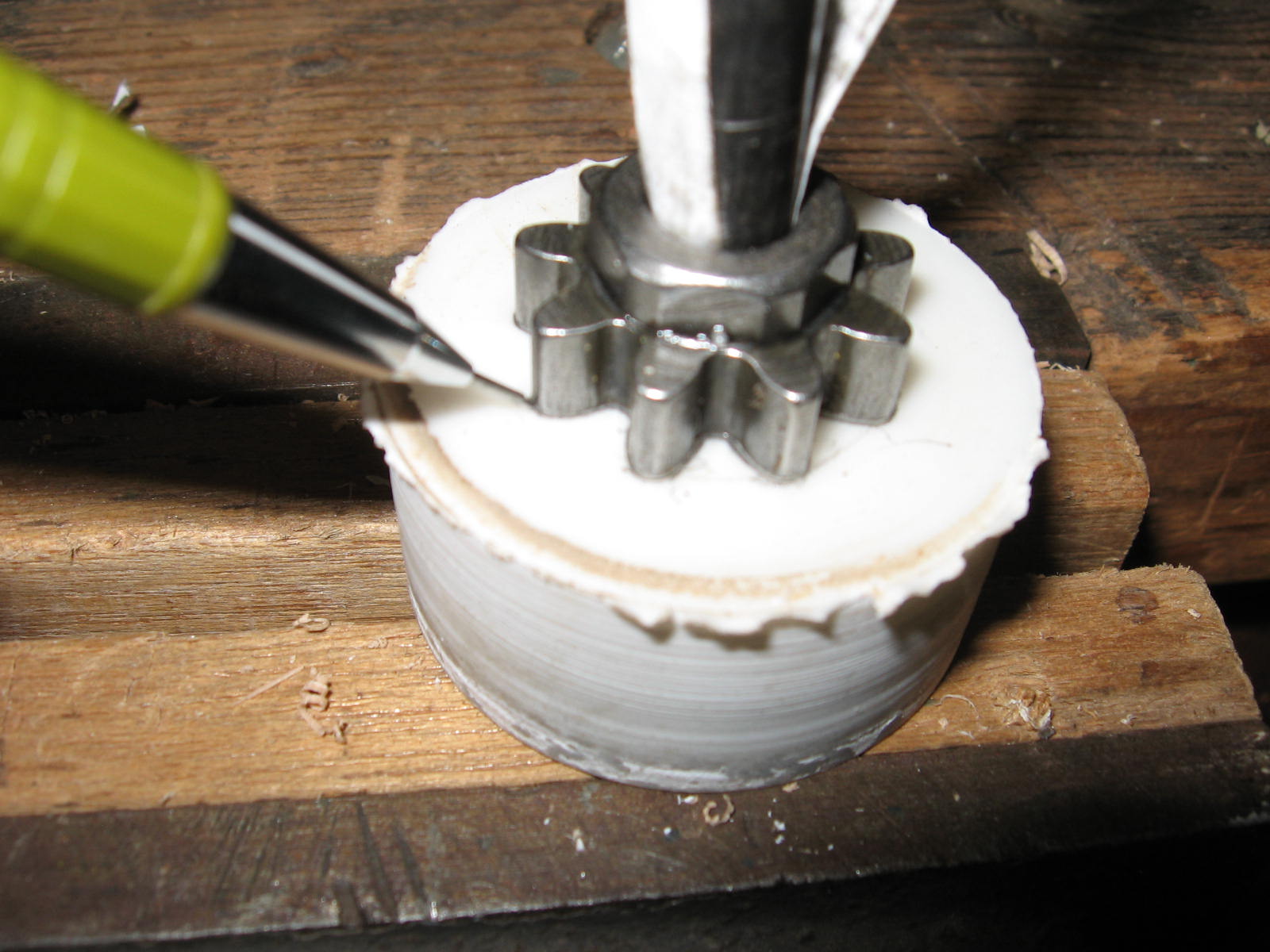

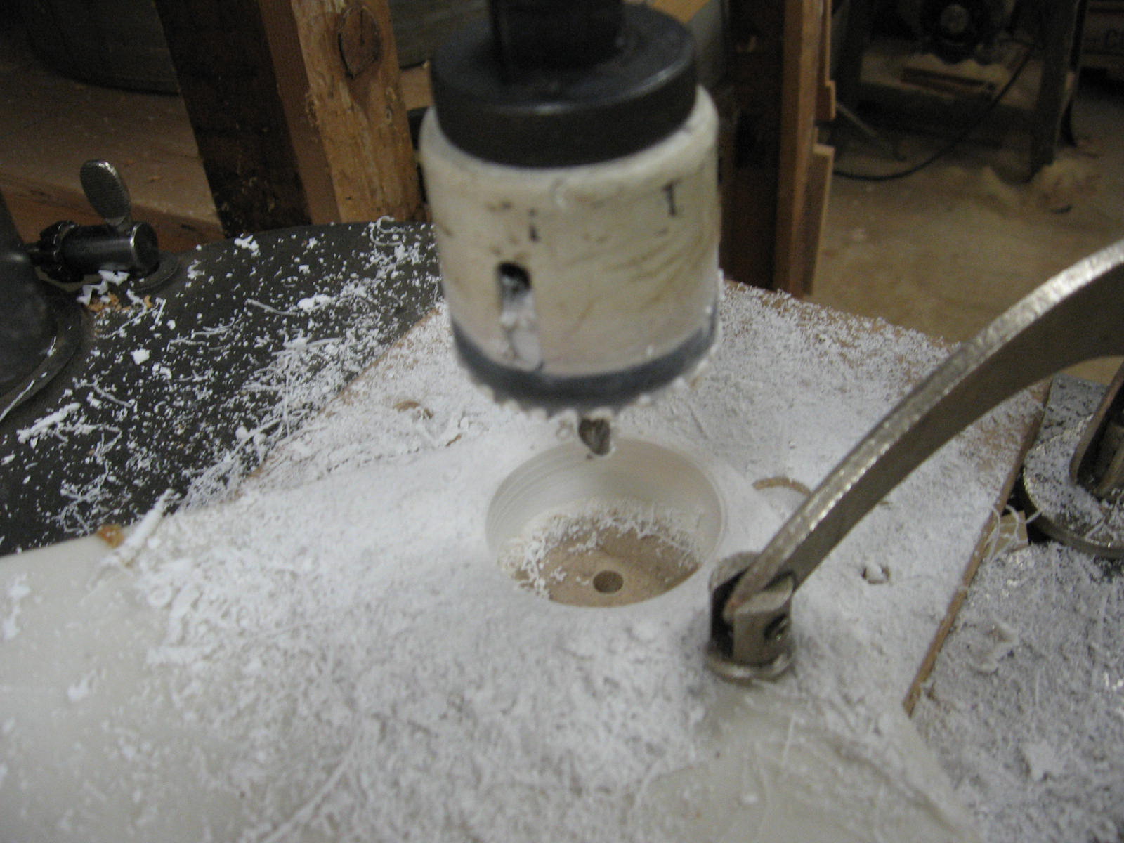

Borrowing a fine idea from TBN members I bought a new car window motor from ebay for $20. The challenge was to convert the attached gear to a pulley for a cable drive system. I chose to build my own pulley from a 3/4" thick sink cutout scrap of Corian.

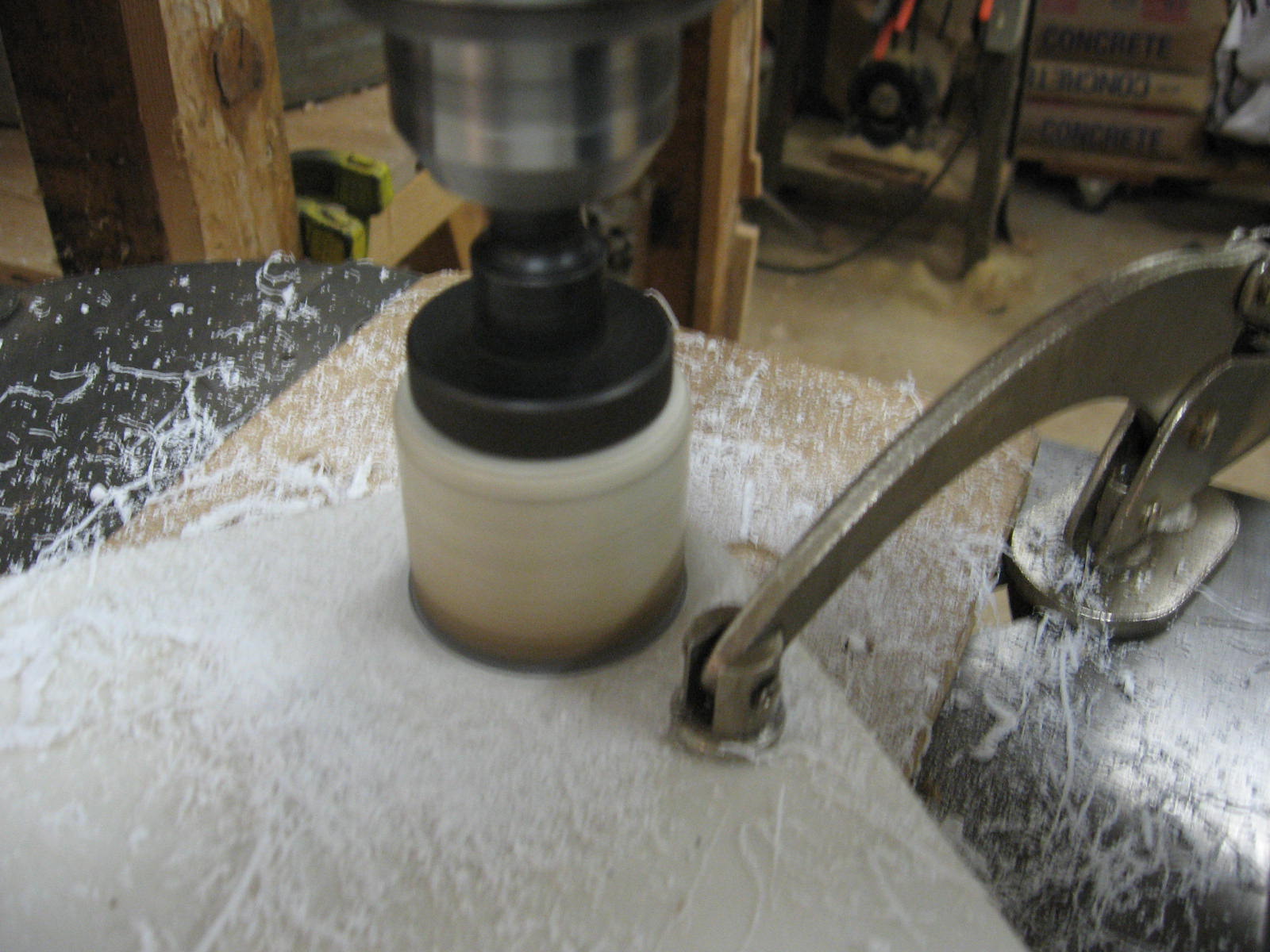

I cut a 1 1/2" dia plug with a hole saw. Then I needed to bore the pilot shaft from 1/4" hole saw shaft to 5/16" motor shaft.
Next I traced around the gear with a 3mm drafting pencil.

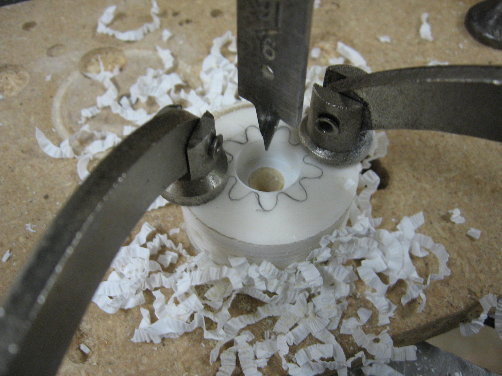

Now I wanted to counterbore with a spade bit the depth of the gear to remove most of the waste. The problem here is keeping center with a spade bit so I modified an old woodworking trick. I secured a flat plate to the drill press table and bored a blind 5/16" shaft hole int it. I did not have a 5/16" dowel so I spun a 3/8" dowel on a disc sander to make a tight hand press fit. I pressed the dowel into the hole and trimmed for height, placed the pulley blank on the wood shaft, set depth for the spade bit and counterbored the gear.

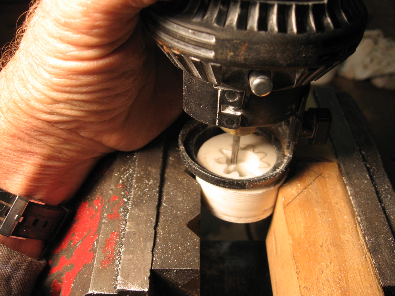

Next the tough part. Freehand the remainder of the recessed gear profile. My Dremel does not have a "router" attachment so I used my RotoZip and a Dremel bit. It took a steady hand but I was pleased with the fit.

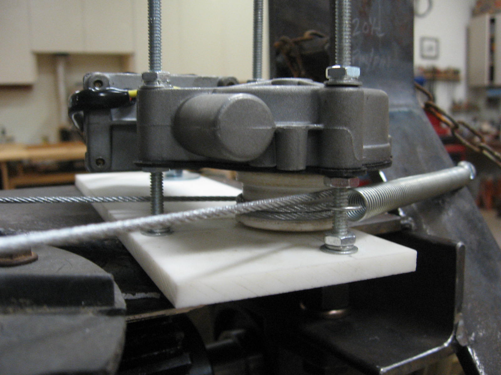

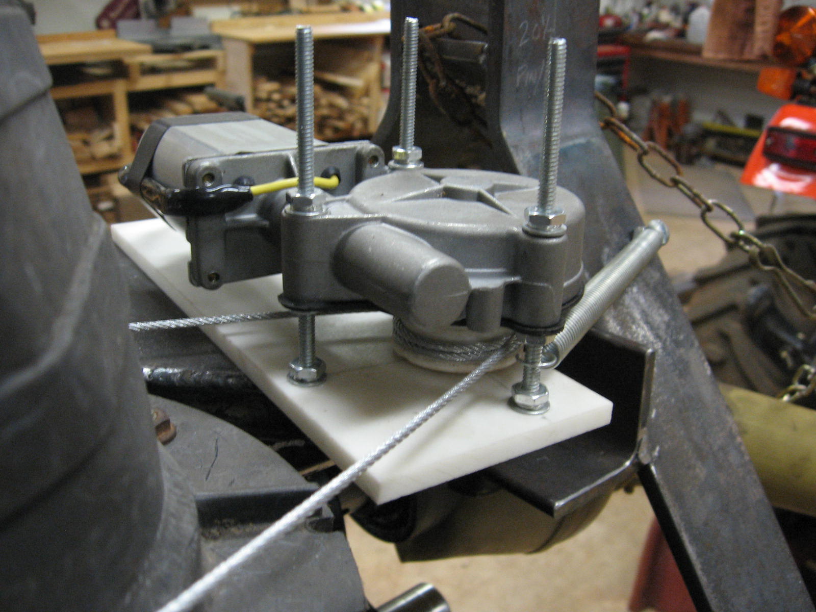

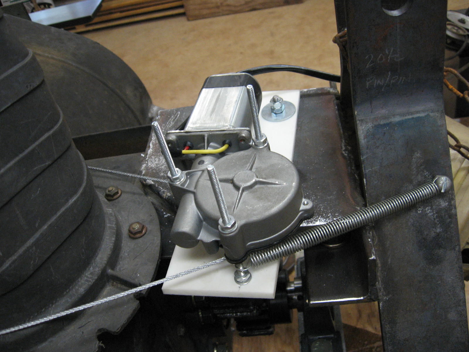

Here is the motor assembly and cable drive attached. The motor base plate is a 1/4" thick piece of Corian giving me a flat, rust free, fairly slippery base. The baseplate pivots on one through hole and the drive cable is tensioned with a spring.

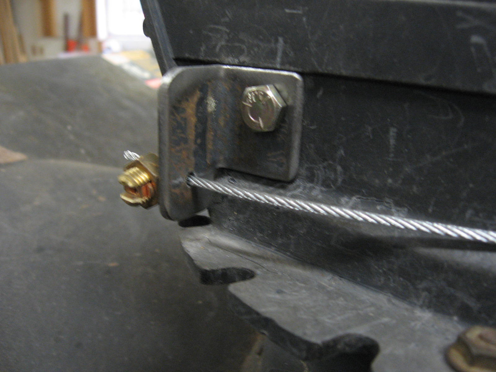

This is the cable attachment to the chute
And finally, a cover for the motor.
The chute rotated just a little faster than I wanted so I wired in a pair of Radio Shack 1ohm resistors into the circuit and now it seems just fine. If I find I want to rotate faster later I can just remove one or both the resistors
Tomorrow I'll trim those long bolts at the chute motor cover and use the acorn nuts. Then I just need to drill and tap a few holes for thumbscrews to hold the gear covers in place and I'm done except for painting. I'll probably just prime for now and topcoat in the spring when it warms up.
Now I need snow! The machine powers up to full PTO speed with no vibration. There is a little gear noise but it is not sever and was expected with square cut spur gears. It's hard to wait to post pictures of snow a'flyin but that's all I can do unless I trailer upcountry.

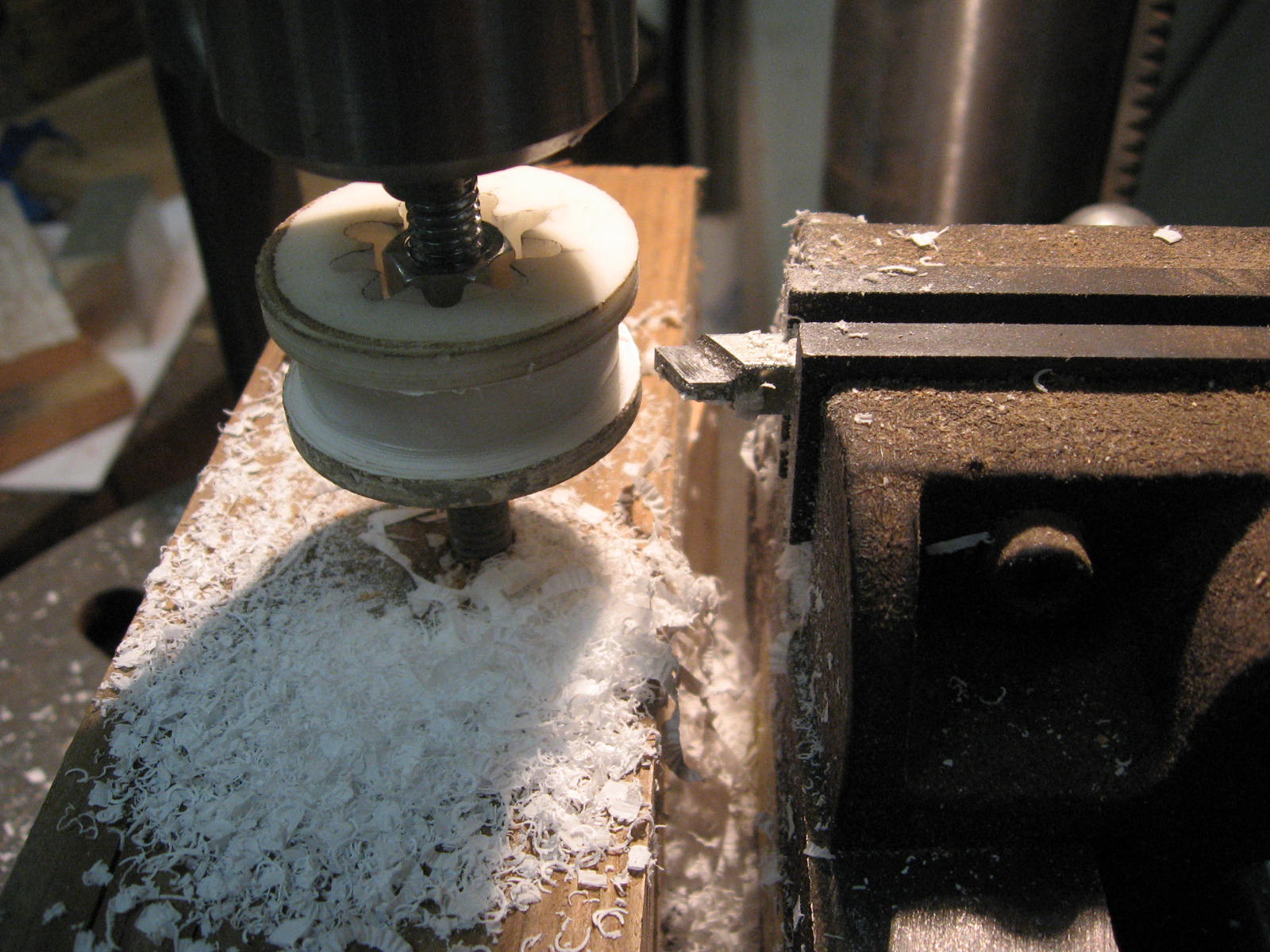

In review I see I forgot to show an important step in making the chute motor pulley. I can't see a way to add an attachment in edit mode.
I needed to cut the recess for the cable in the outside diameter. I don't have a lathe so I chucked up the blank in the drill press and used a makeshift lathe cutter in a cross travel vise. It worked.
