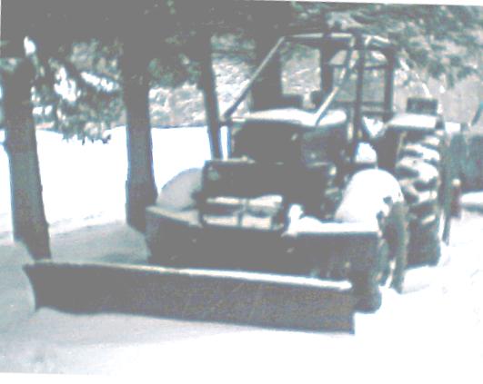

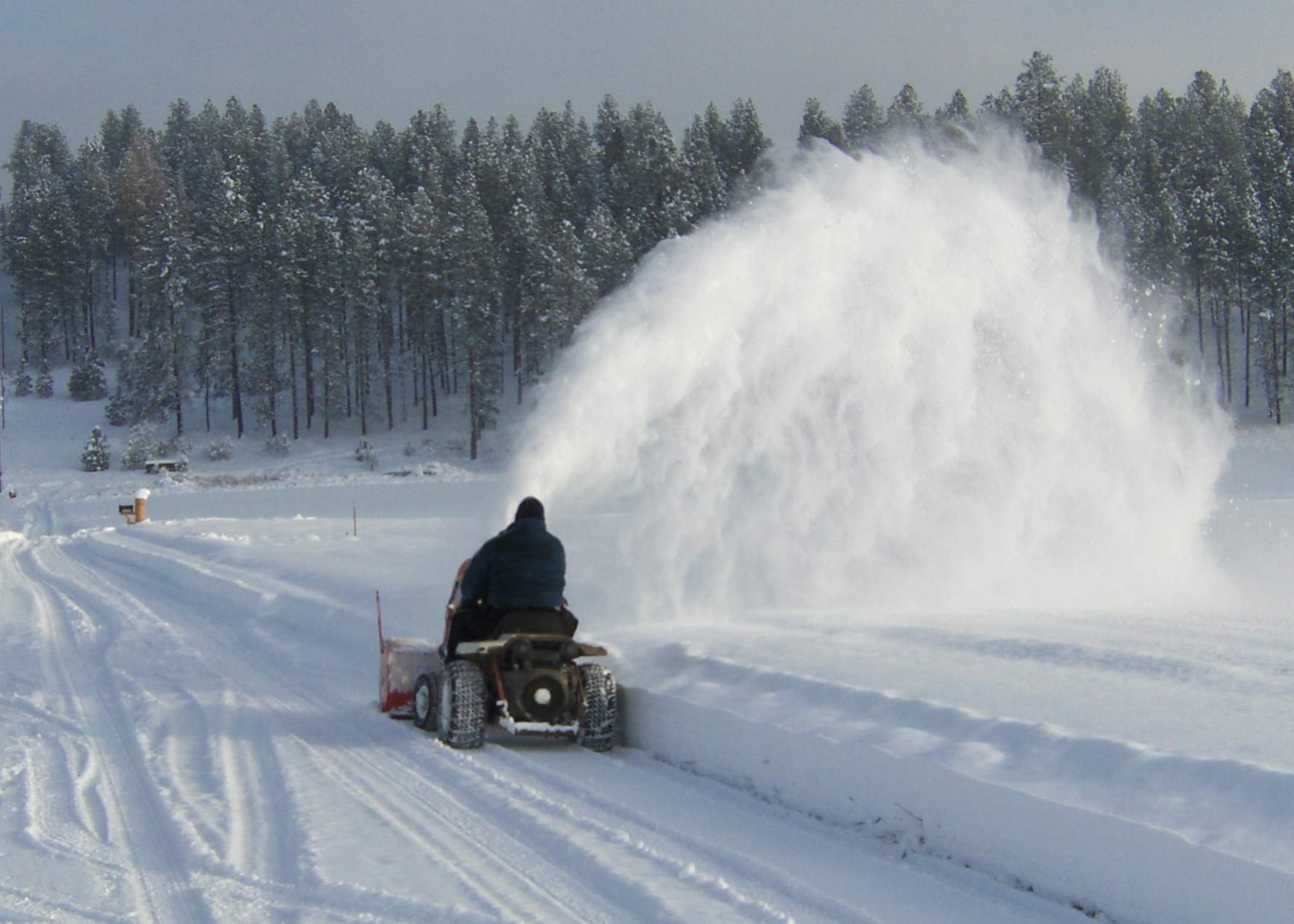

Gravely 816 tractor, 48" blower, ~20" snow. I did about 1/2 mile of road several times, and several driveways. Was fun to really use the blower. the "tunnel" had been ballooned out from previous owner, impeller worn. I took and cut some old tire tread and bolted to impeller to reduce tip clearance. It blows what ever snow I encounter now.

So do you get a wrenched back from driving the tractor in reverse?

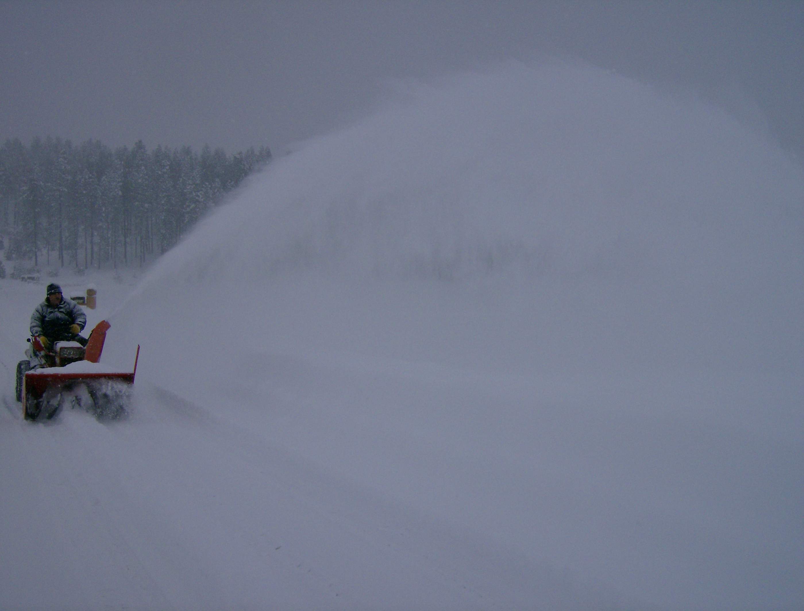

Gravely tractors have blowers on the front. No 3pt available. Hydraulic lift to raise it, crank easily reached sitting down to change chute direction, cable pull to change chute distance.
