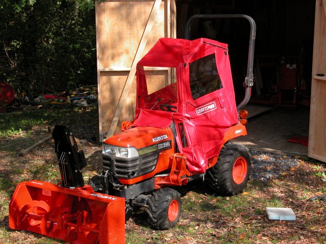

Tom:
I did a lot of digging for cabs and found almost everything was way too expensive for what I wanted - a shield from blowing snow.
Finally I stumbled on a plastic/vinyl one from Sears. Just what I wanted. The price was $ 199. Low and behold about 6 weeks ago I was getting ready to buy it and I noticed on the Sears site that it was on sale for $ 119 "while supplies last". I went and got one. Took a few hours and 4 holes to fit it to the Kubota.
I am not sure of the current status. I checked the Sears site and it is still shown. You can check it out. The Sears item is #07124274000
I have attached a picture taken when I fitted it up.

Techman,
Does it have a back to it, I have a 3pt snowblower so need the protection in the rear. Does it have a door? I see it is back to $199. What did you have to do to get it to fit? Do you think it will fit with the FEL?
Thanks
Tom

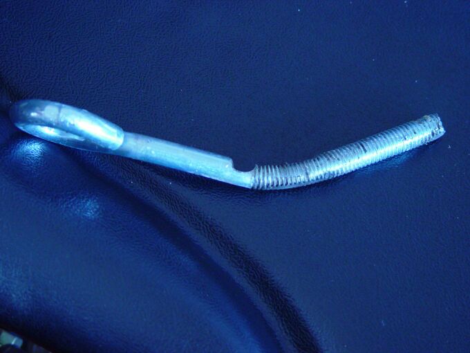

Ran over what I knew was a bolt that I had lost from the tractor a few nights ago - broke the shear pin in the blower auger. Decided to wait until today (Sat) to fix it since I it was cold and dark and the auger was packed with snow.
Cleaned it out today and found the attached.
Was wedged in there nice and tight. Almost bought myself a grinder last summer to sharpen the mower blades; was forced to go ahead and buy it today. No other way to get this out other than grind it down.
   / Snowblower Experience #9
picture didn't attach to previous post
