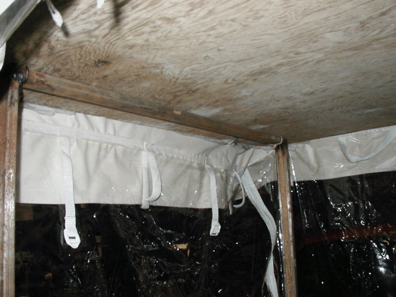

   / Snowblower Experience #19
front roof support for plywood.

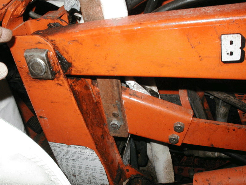

   / Snowblower Experience #20
This shows where front frame bolts onto FEL frame.
