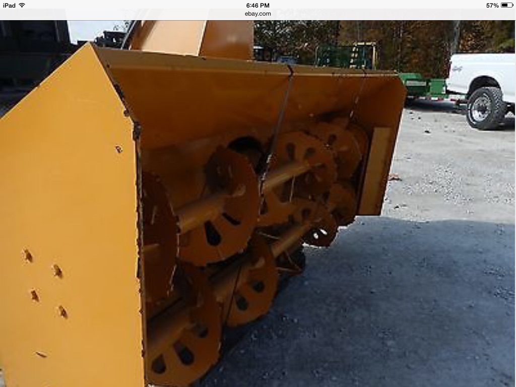

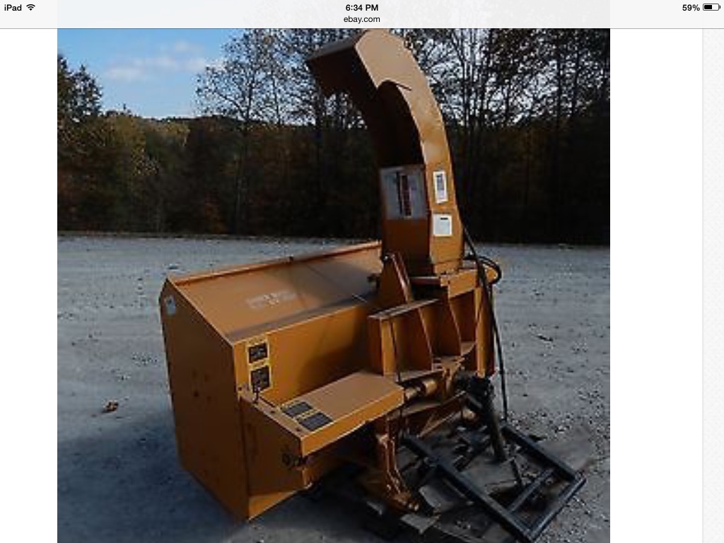

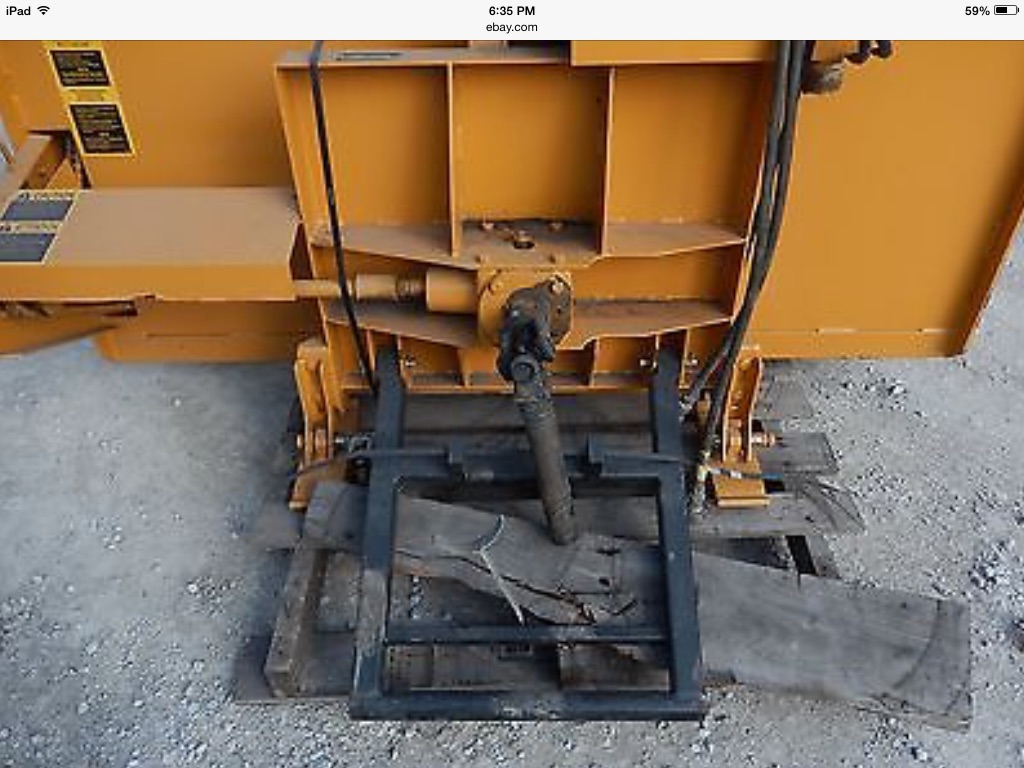

image.jpgI was thinking about fabricating this snowblower to work with my kabota tractor I would need to buy a four ft drive shaft and fab up some sort of frame and than a short shaft to the shaft of the blower I can't afford 10,000 and I don't want a rear blower any thoughts image.jpgimage.jpg here is a picture of the 60 inch blower I already have a mid pto it can't hurt to give it a shot should pump out some serious snow

Looks like it will make a nice blower for sure. Check to make sure you have the proper direction rotation(s) before you buy.
/ Snowblower fabrication #3
I don't think it will work for you at all. I'll be happy to remove it from your yard.
Seriously, that looks like a nice double auger blower. Shouldn't have too much problem fabricating a mount.

The mid PTO is either 1000 or 2000 RPM, a lot faster than the standard rear 540 RPM & usually in the wrong direction. Nothing that can't be fixed with the right gearbox. You have to watch the clearances & drive line angles carefully.

Looks like you have "all the toy's" now.:laughing: You can change rotation direction with additional gearbox's or chain & sprockets but it takes up space. Do you know what the blower was used on? With any luck, your mid mount turns the opposite direction from your rear PTO giving you both. I'd rather run a driveshaft to the proper rotation than fool around with adding a gearbox.

The blower came off a trackless machine look it up I'm hoping I don't have to fool with gearbox I will make it work got if I get it it's original cost was 16,000
