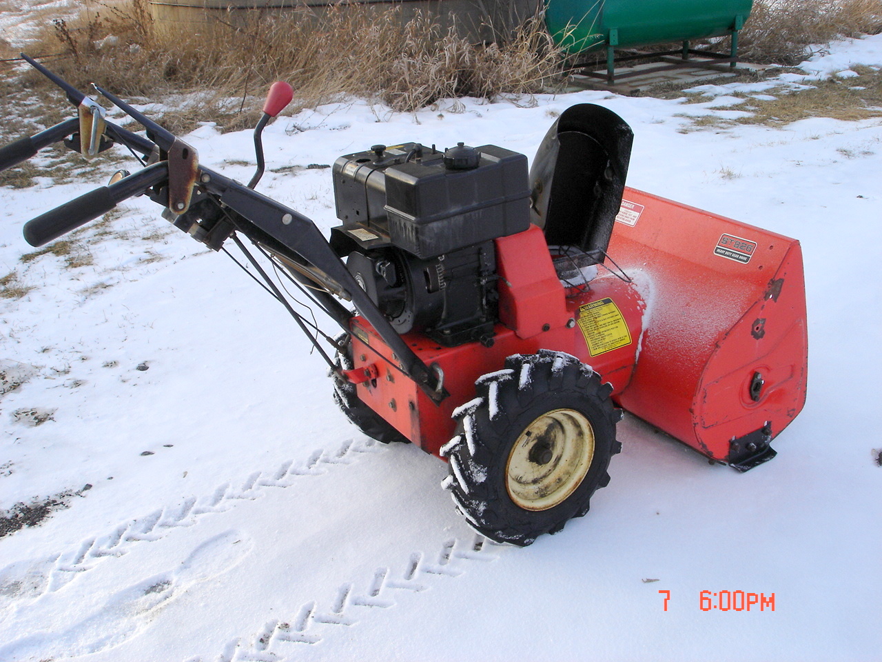

I just brought home a Gilson 826 snow blower. It was on Craigs list for $25. The owner said the motor just siezed up last year and wont turn over. It is an 8 hp Briggs & Stratton. I assumed that the motor was junk, but because the machine is a 5 speed gear drive transmission I thought it would be worth the effort to mount a new motor to it. It seems to be very heavily built. I have a couple of rotor tillers that have motors that could be used as doners, they are not used much in the winter time.
When I got the machine home I pulled on the recoil starter and could not move it. I then pulled the plug and poured in a little transmission fluid to help free it up in case it was just rusted. It still wouldn't budge. Then I got the 18 inch pipe wrench and put it on the output shaft and got it to turn. It made some very bad noises and turned hard. Not a good sign.
I then pulled the head and used the pipe wrench to move the piston up and down, everything looked good. I pulled the recoil and noticed that the rope had gone limp and had wadded up and made a loop around one of the mounting brackets, making it impossible to pull! It acted like it was seized up.
Also the two lower mounting bolts were missing allowing the housing to rub on the flywheel.
I pried the rope loose and got the pully working correctly. I removed the recoil mounted on the flywheel and noticed that one of the 6 ball bearings was not where it was supposed to be, preventing it from free wheeling.

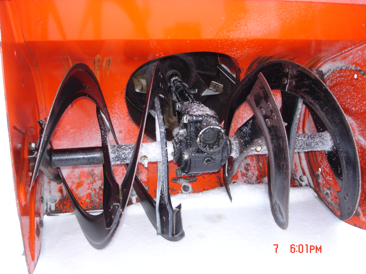

I put it all back together and I got spark when I pulled the recoil starter handle. I think I am just a carb cleaning away from having a very heavy duty electric start 8 hp snow blower. This thing is is made of very thick metal and has a peerless 5 speed gear drive transmission, there are no friction wheels to wear out. The gear box on the auger is about twice as large as the ones you find on the new machines. I will post some pictures if anyone is interested.
I have been out of work for about a year and have more time than money. I am tickled to death to have found this great machine and to be able to bring it back to life. They truley do not build them this stout any more.
Our domestic engine manufacturers got behind the eight ball about 30 years ago and at that time Honda and other small motor manufactures were probably a much better product. I think the gap in performance and design has closed since then. I have several machines powered by by Briggs & Stratton engines and they have worked great. If you are buying a new machine and you can get a domestic engine on it just do it. They are good products and will help us all get back to work.

I don't have pictures yet. I removed the engine and pulled the head and carb. I flushed the motor with diesel fuel, Cleaned everything up and put the motor back together and put new oil in it. I had to replace the fuel lines. I put it back together and it started on the second pull while clamped to my work bench.:D:D
I should get it bolted back on the machine in the next day or so. Then I will take some pictures of it. It is a very heavy built unit. The front auger drive gear box is twice as large as any of the newer units and it has very stout construction everywhere on the machine. If you google Gilson ST826 you can see what it looks like. It is one of the few machines that use an actual oil filled 5 speed gear box rather than a friction wheel.:cool::cool::cool:
If you google Gilson snowblowers you can get a lot of information on these machines. They seem to be very highly regarded.:D:D:D

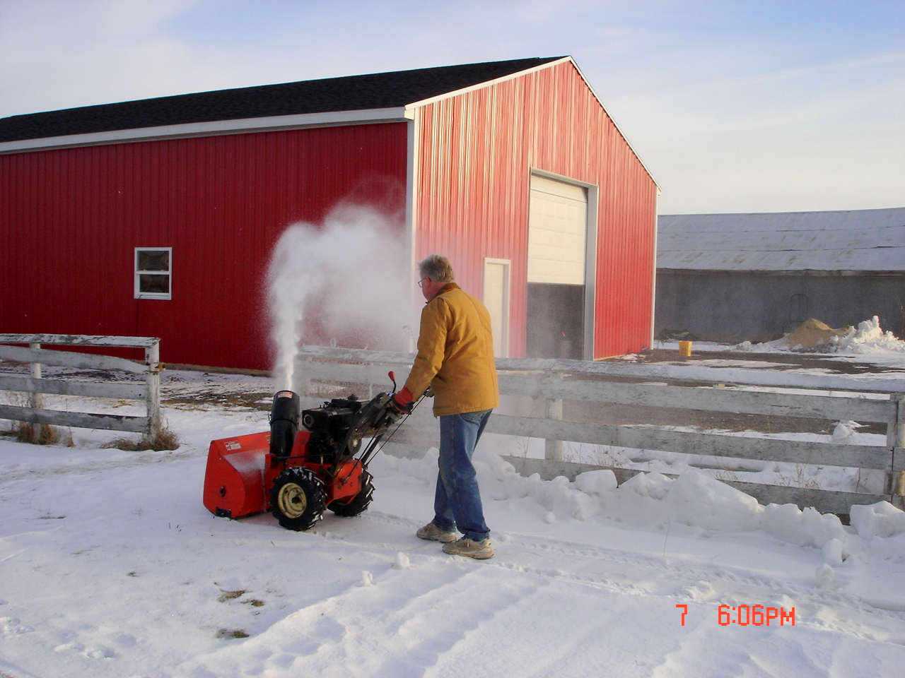

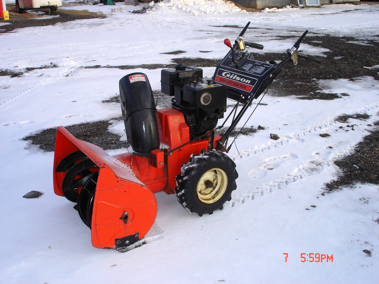

I got a picture of tyhe Gilson in action.:D:D
We don't have any snow to work with, I had plowed it all away with the tractor last week, but if we get some new snow I now have a machine for doing walking paths instead of using my 7 foot back blade and tearing up the grass.:cool::cool:
It feels good to have saved the old machine from the scrap heap. When I get all my projects caught up I will give it a paint job....probably 5 years from now....
