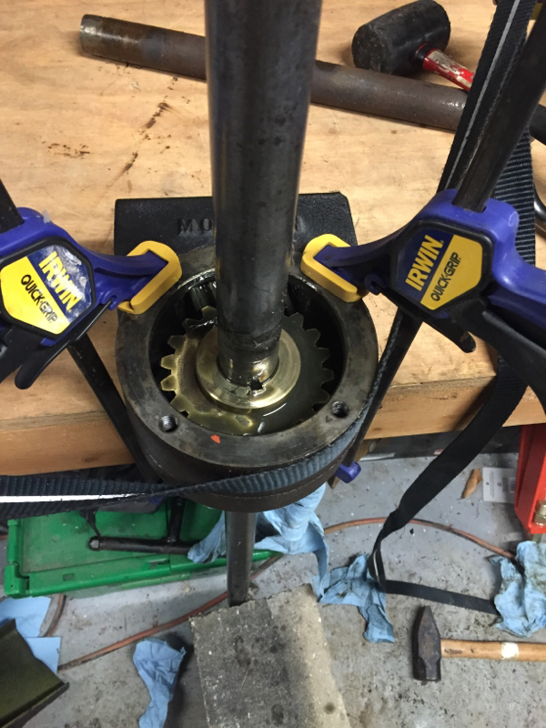

Here is where I am. The manual says to now pull the long shaft along with the gear out. Well I guess im missing something cause the shaft wiggles a bit but will not pull out. I can rotate it easily though. Last night I got the whole fan assembly disconnected.

Well I have the next 2 days off so I called my father in law and he is gonna come over and help me. He has been around tractors his whole life so it should be back up and running by Wednesday night.

Did you pull the circlip on the other side? If not, I would pull that to let you get the gear out of the gearbox,
If you dont need to remove that gear from the shaft, I wouldn't. One less thing to put back together.
Aaron Z
   / Snowblower gearbox #48

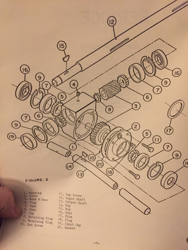

Say, do you even need to pull that long shaft?
You are only needing to replace the short shaft that broke and I believe it can be persuaded out by prying while twisting (unscrewing motion). There might however be a circlip that holds the screw shaft in place, if so it would be located inside the bearing where the broken shaft enters the casting.

Say, do you even need to pull that long shaft? You are only needing to replace the short shaft that broke and I believe it can be persuaded out by prying while twisting (unscrewing motion). There might however be a circlip that holds the screw shaft in place, if so it would be located inside the bearing where the broken shaft enters the casting.
Yes there is a circlip holding it in place. According to repair manual the long shaft and big round gear have to come out before I can access the rest so I can remove the broken shaft.

Here is a diagram of it.
