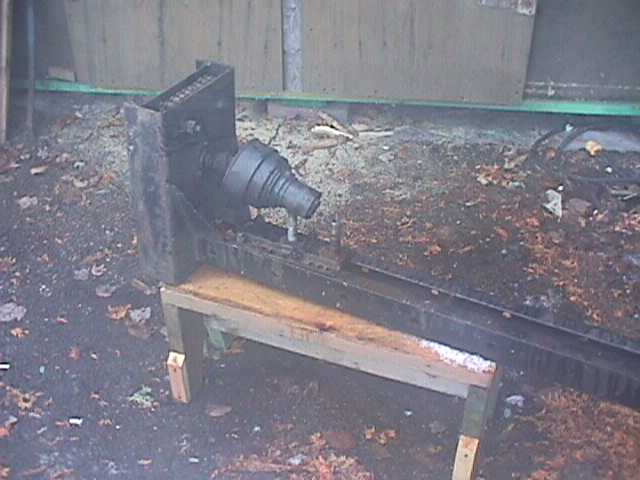

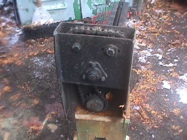

.............. I need to reverse direction and this is a challenge mechanically.......
Yes - I noticed the chute was on the opposite side from most machines. In past years Bervac made an interesting adapter for putting a rear-mount up front - they used an extra sprocket to change pto direction. There would be some opportunity to change speed with sprocket sizes. pics below. Erskine's chain box is enclosed running in oil. But for homeowner use an exposed setup might hold up well enough.
