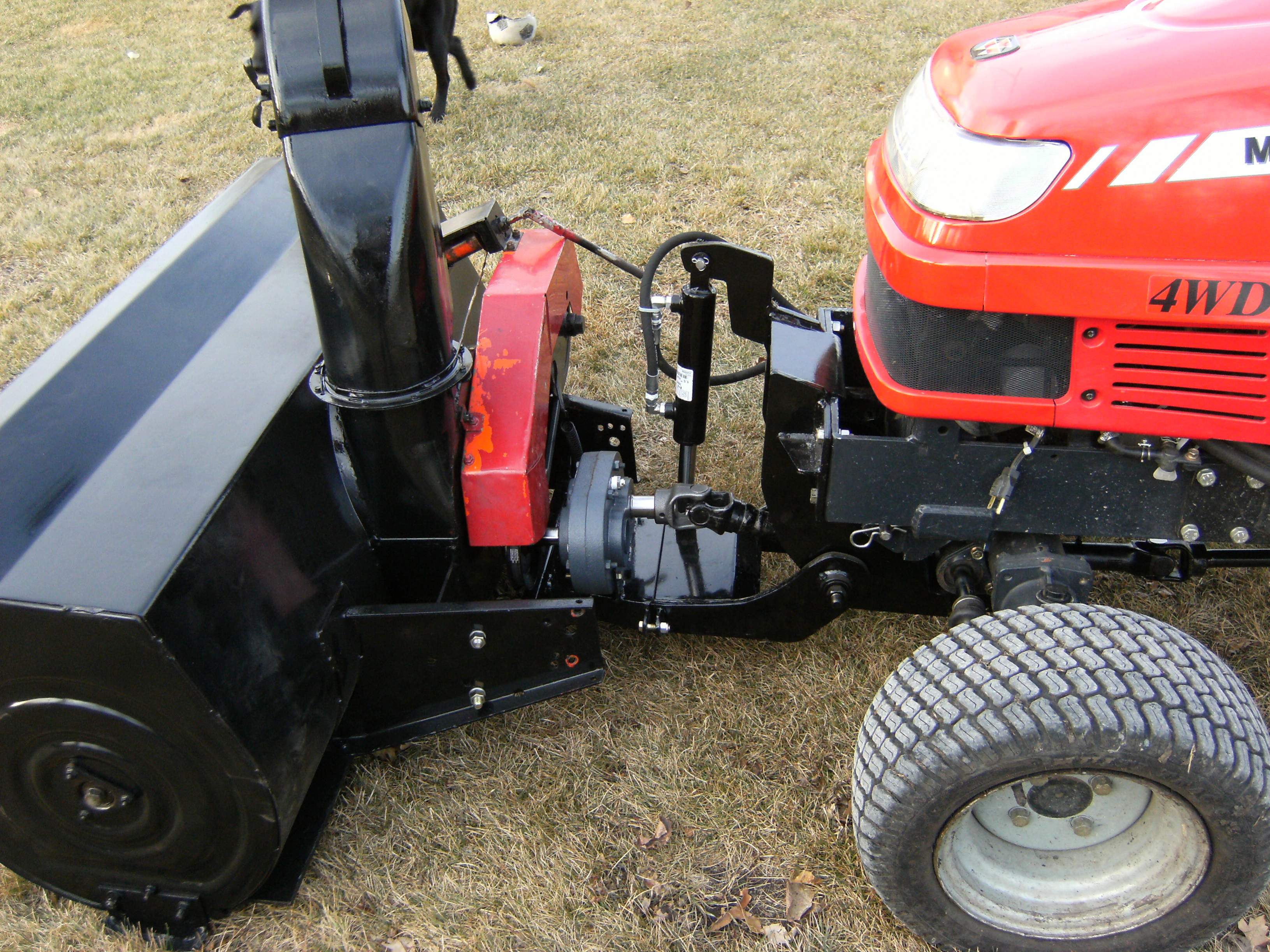

hey there red dirt did some measuring for you.I have a older 48 ariens blower that I'am using on the front of my MF gc2300 it used to be on my old MF 1655so I measured pulleys etc; for you.I also had to put in a parellel shaft drive as the motor in the 1655 faces different then the g2300 so had to reverse direction as well,Hub city makes these things I live in Canada so had a place get me one.Anyway heres the facts.Main gear box inpeller and augers are running at 10.5-1 ratio now from the parellel shaft drive the first pulley is 6" running to a double pully so the 6" first pulley runs to a 9"part of the double pulley and the second part of the double pulley is 6" and run to a 10" pulley which drives the shaft into the main gear box this set up works just fine however can't tell you the tip speeds but it blows snow just fine.

That looks like a fine unit. Thanks for the measurements. I think I get your pulley assembly and ratios but not quite sure where the 10.5:1 ratio comes into play. Is that the Hub City gear box ratio? Are you slowing down your mid pto rpm at the Hub City gearbox and then increasing back up to the impeller (or blower "main" box?)? If this is the case what rpm is the pto running at (and blower "main" box? Main box speeding up or down?)?
Or is is the 10.5 from pto rpm to impeller rpm including the belt increases?
The easier answer for me would be: Do you happen to know your calculated rpm at the impeller and the diameter of the impeller?
BTW tip velocity is calculated at impeller diameter inches / 12 = impeller dia ft X 3.14 = impeller circumference ft X impeller rpm = tip velocity ft/min.
Is that a Model 22 Hub City gear box? I am looking at their Mod 22, 2:1, 17hp, service factor 1.5 model. I'm checking to ensure it can be used as a speed increaser. Some reducers and be run backwards, others cannot.

Red Dirt I did some more measuring for you and a better picture of the pulley system.The 10.5-1 ratio I was talking about is the one built into the blower.The blower fan turns 10.5 full turns to 1 complete turn of the auger bringing the snow to the middle of the blower.The fan [blower dia = 14"with 6 blades on the fan] and the auger[dia.= 16"] Your also right about the gear box from hub city its a Model 22 -single reduction style A and its ratio is 1:1.Thats what I needed for my application.My pto input is from the mid mount pto so its speed is 1750 rpms. also 17.5 hp pto. your right about costs adding up on projects. I had this snowblower from off the other tractor so I wasn't about to buy anything else. again pulley on gear box 6" driving double pulley 9" which then turns into a 6" that runs to a 10" pulley.What it used to be was a pulley on the stub shaft sticking out of the 10" pulley there was a 4" there that then drove the 9" pulley it was direct to the pto.However because of the different rotation I needed to put in that parellel shat drive.I also had to speed things up a bit due to the other tractor having a almost direct drive to the blower so it was probably running at 2500rpms anyway this is what I have done with mine to get it to do the job that I need.The only other thing is that I'll say is we had a bit of snow here last night so winter is knocking on our door step.good luck with getting yours working.Hopefully this picture will give you a better idea of how the pulleys are set up.And of course the 10.5-1 ratio is pre determined in the blower [fan] auger gear box.As always Larry

Thank you Larry. That is a very clean installation you did especially considering the contortions that the power drive needed to take. It also looks like you built your own front mount. Very professional looking, both the blower and mount.
I decided to keep my drive as simple as possible yet still flexible for further modification if all my speed calculations and assumptions come up lacking.
I ordered the main parts, gears and bearings, this morning and went with a straight two gear drive that will give me reversing as well as speed increase. Even with the needed jackshafts, bearings and mounts this approach will be less expensive than the Hub City gear box and I have more option to refine the design than with the gearbox.
Now the wait for the parts. I know better than to start much actual construction without first having the parts in hand.
