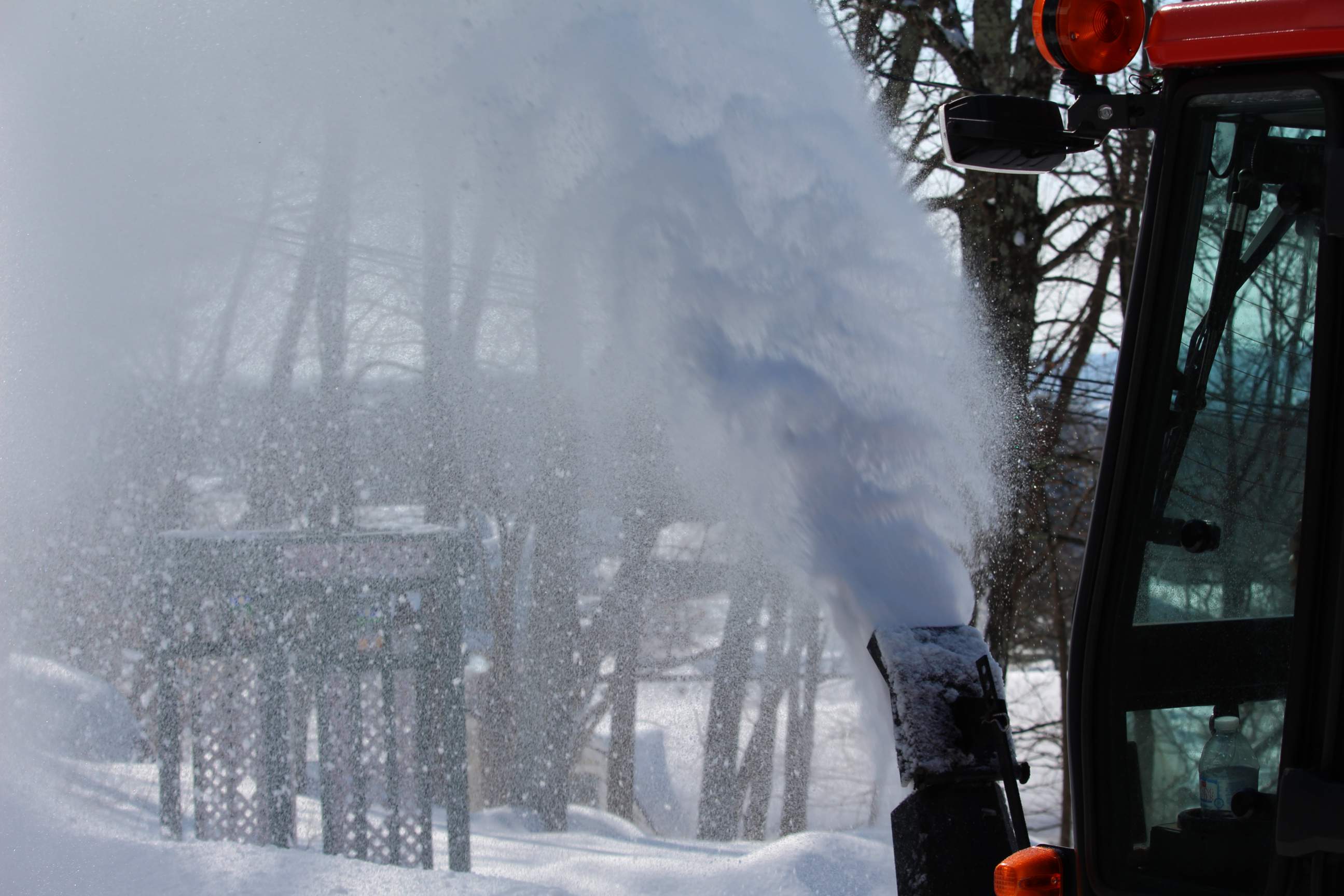

I used 1/4" mild steel plate when I did mine - with four 5/16" through the fan blade. Instead of steel, 3/8" thick conveyor belt would work really well as it is reinforced. I installed my metal plates in 2011 ( I think) and blow snow at 720 rpm ona 540rpm blower. Everything works fine and the blower really pumps out the snow.

I attempted to get a photo today on the snow blower running with the new modification. I think the camera was too close to the tractor. I'll try and get another shot further away.
