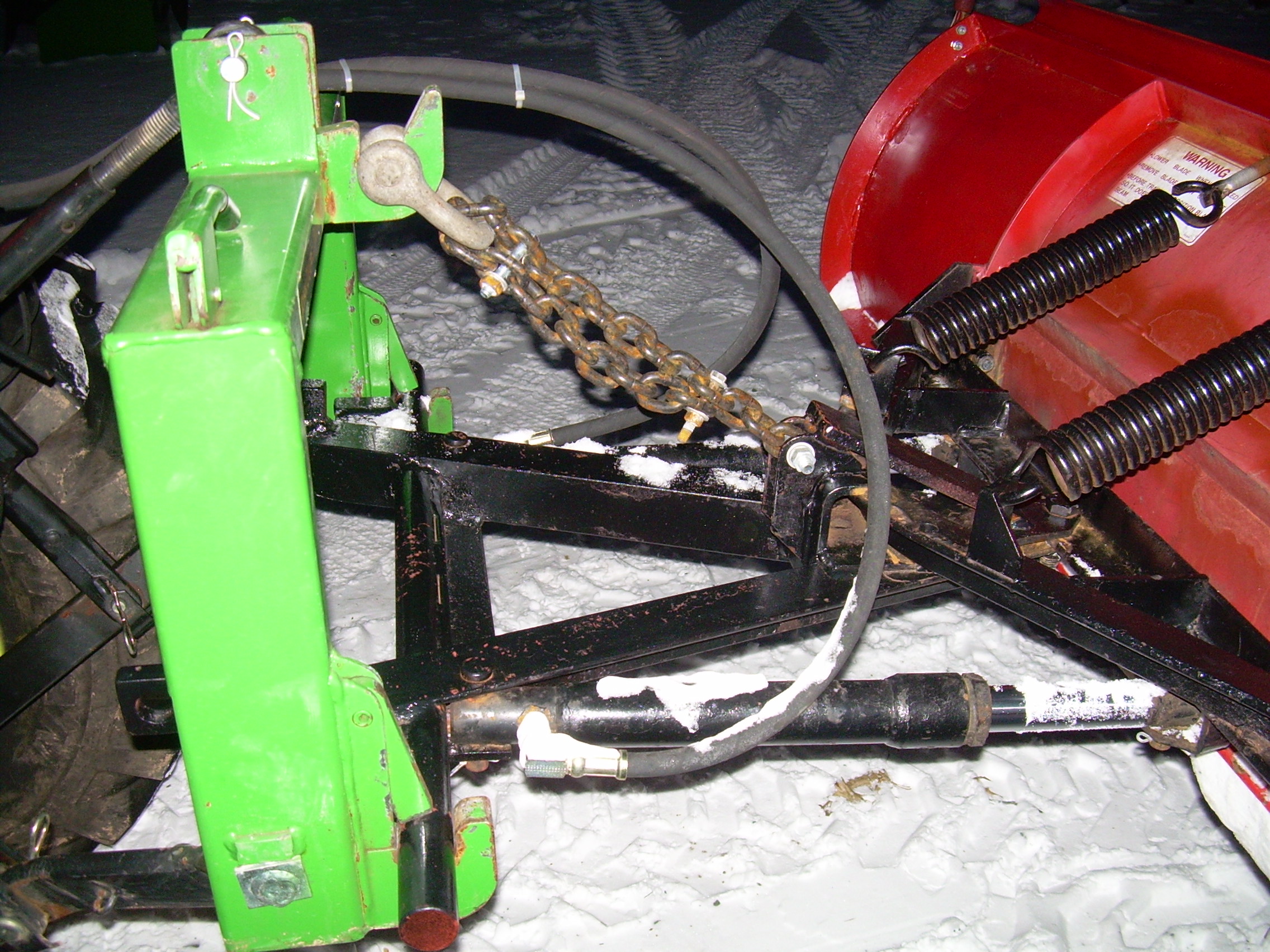

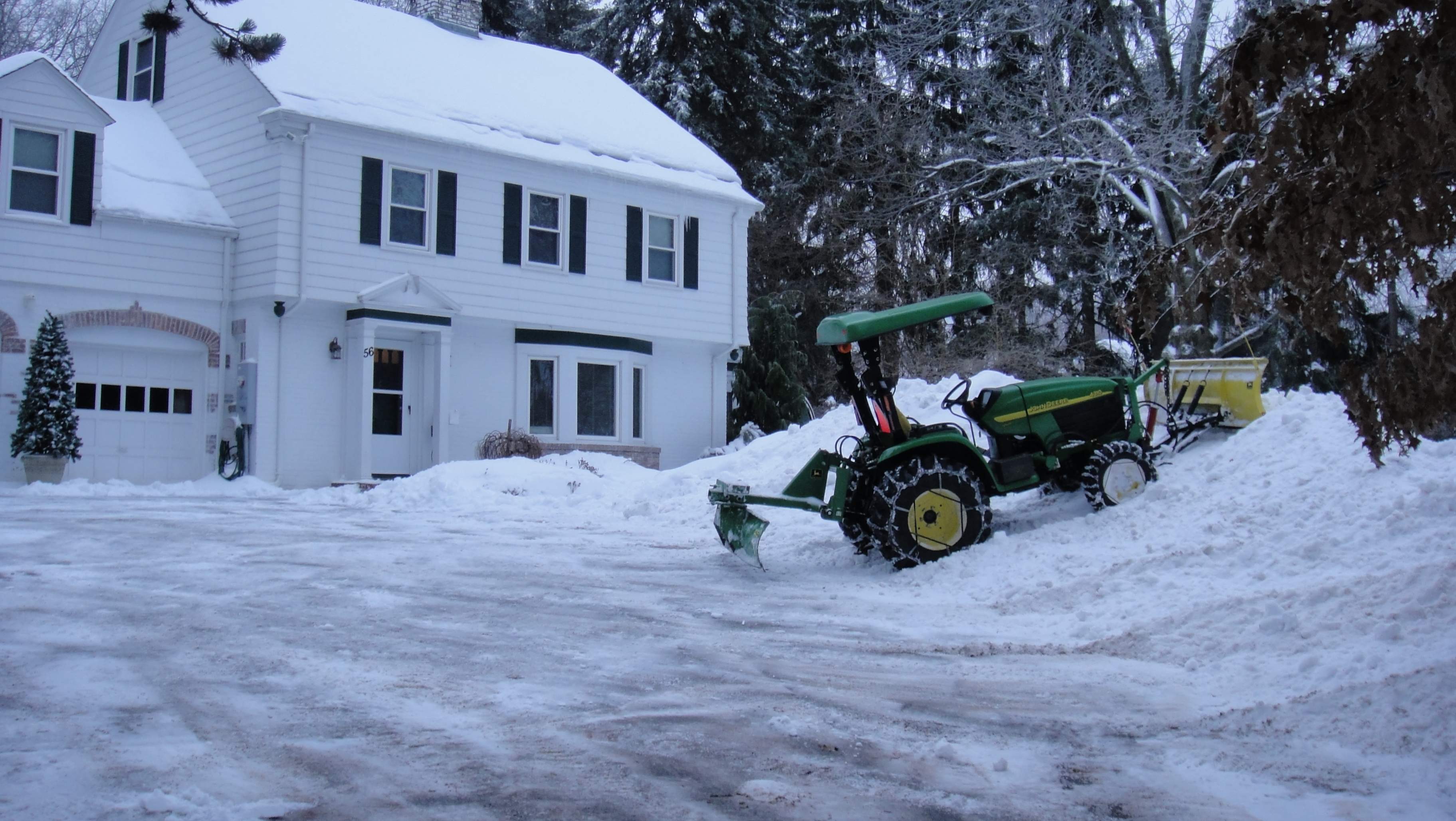

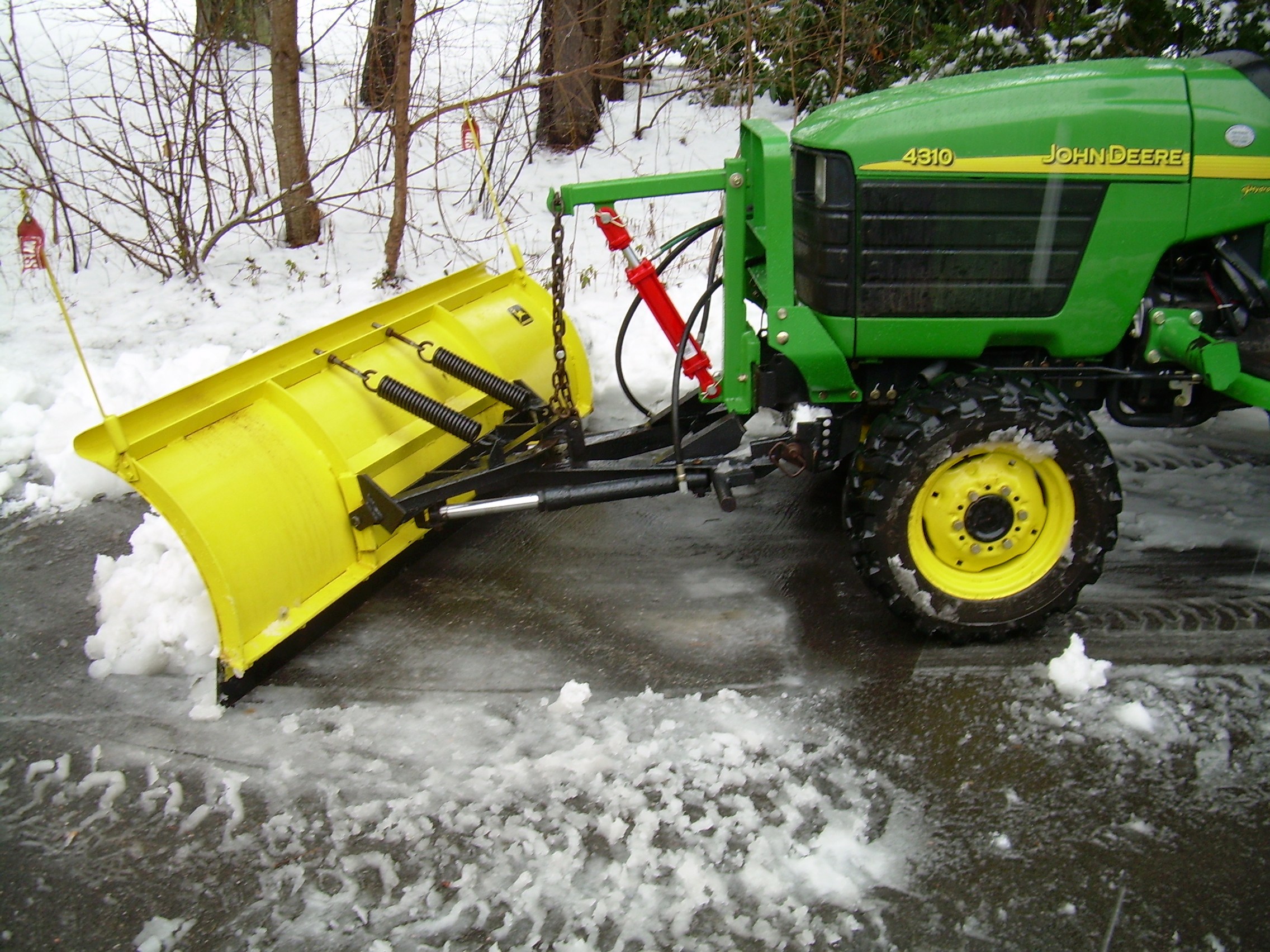

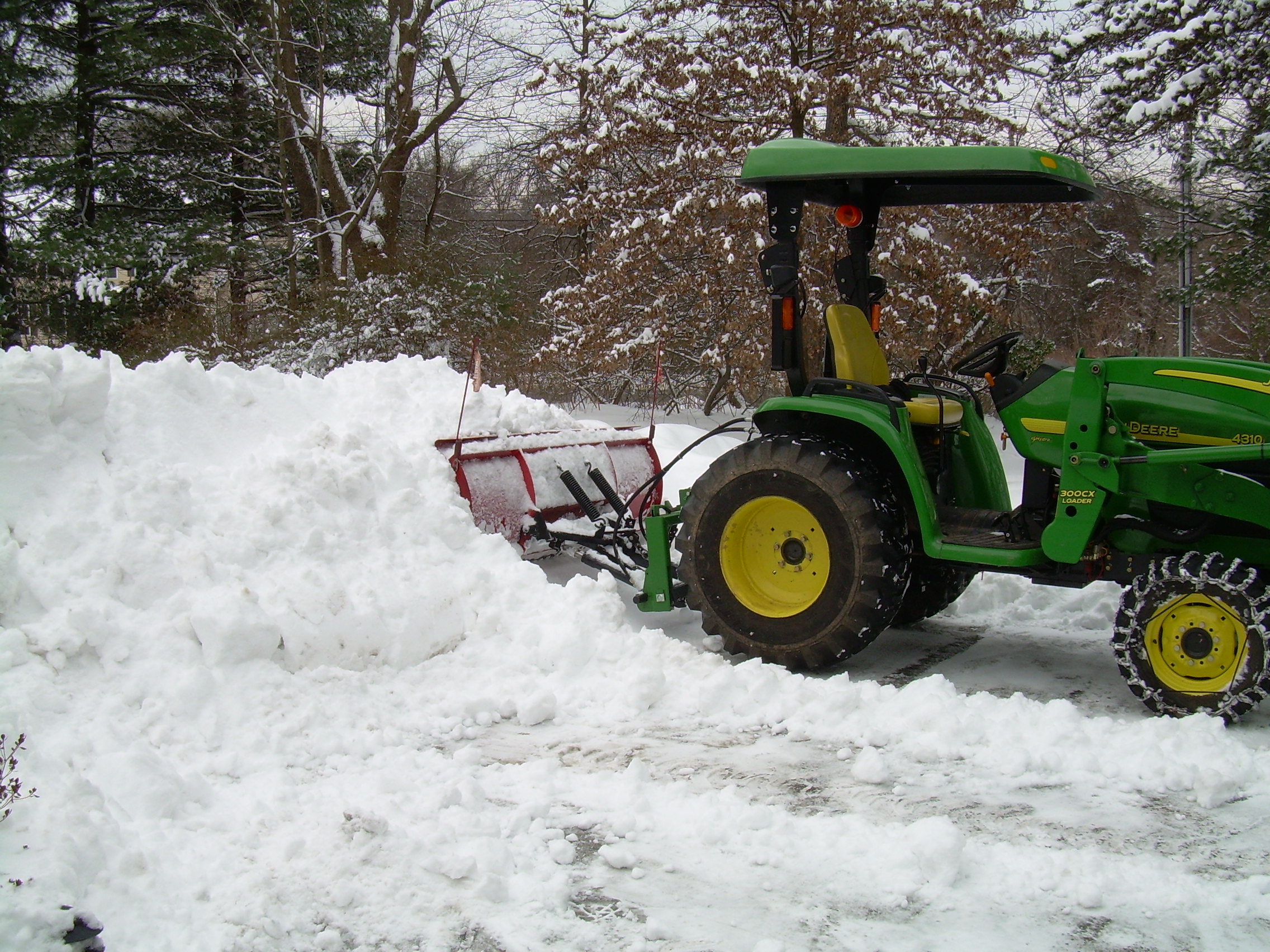

It all depends on the snow fall, I have a snow plow and they are very fast for snows up to a foot or so. if you are in an area of heavy frequent snow a blower would be the way to go.
I'm guessing you are talking about a rear blower?
You can attach a snow plow to the loader like many here have done, most use the existing loader hydraulics. Heck you can even attach a snow plow to the 3 pt like I experimented with for a couple years.
I settled on a frame mount front plow, very fast and efficient, but after banking up the snow from several storms I had to put the loader back on to move the piles back further. With a blower that would never happen.
