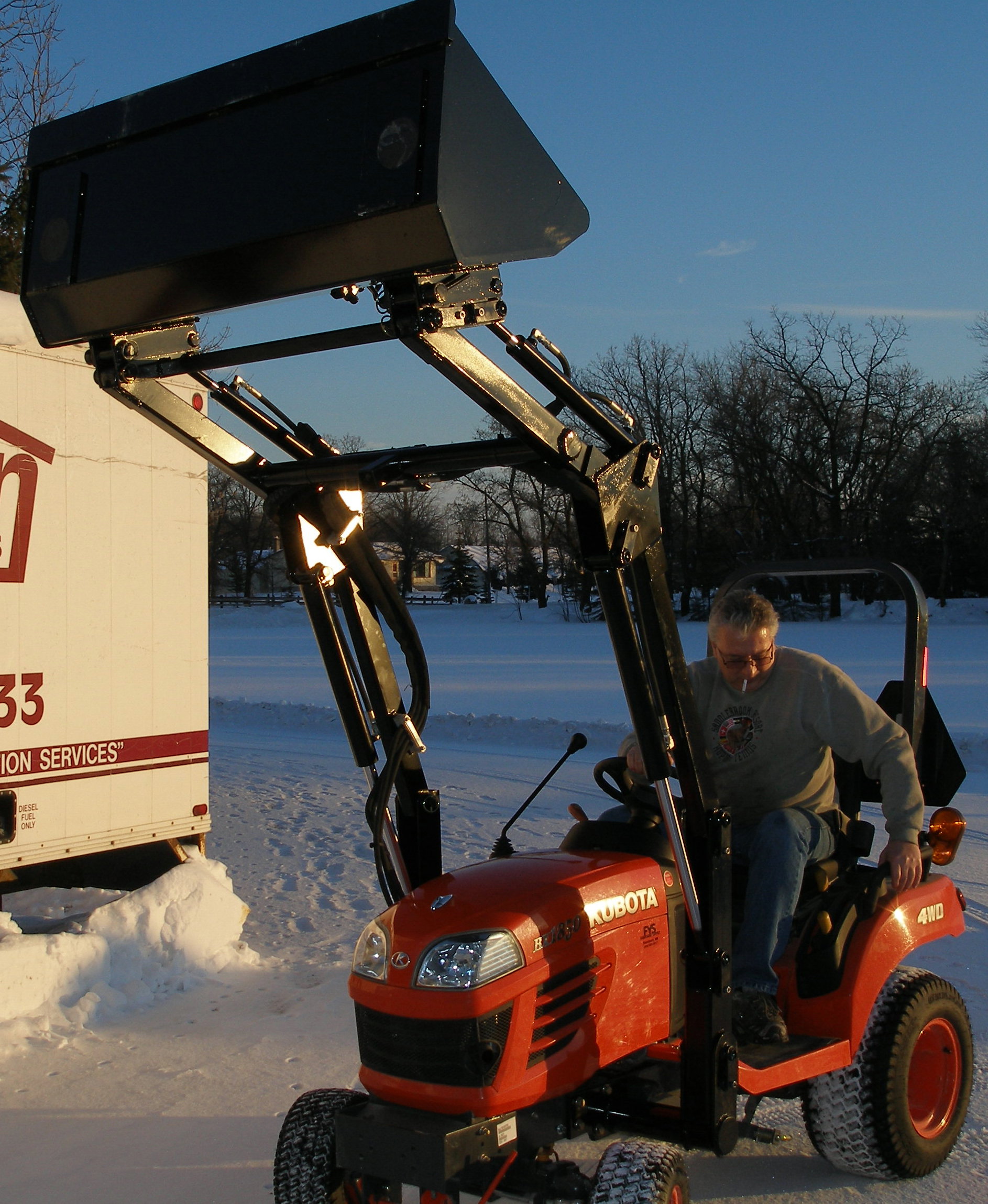

Here is a picture of the loader I built.

Garnet - nice work on the loader! Do the rear uprights sleeve down into the carrier, then get pinned? So when you remove it from the tractor you raise the uprights somehow and reverse out from under? Seems very strong and logical. Or maybe it's not removable?
What is the steel piece just to the right (rear) of the upright in the picture?

Jim I think that peace of steal you refer to is part of my mower deck mounting system. Yes the loader will detach as well as my bucket. As soon as I can I well post more pictures.
