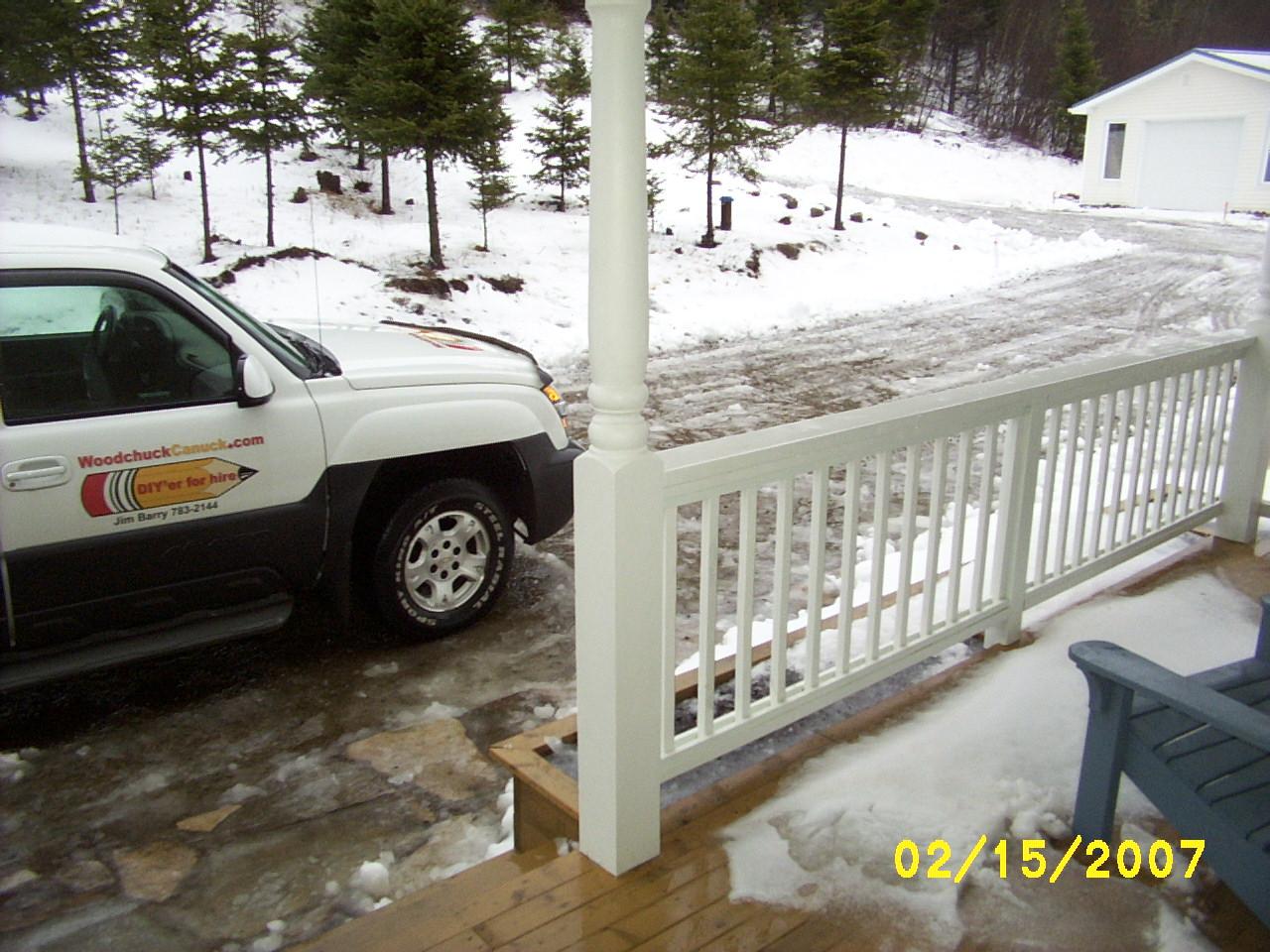

For our specific location we do get snow but never enough to consider hard pack a viable method. The temps fluctuate too much. The driveway faces south so all I usually do is a light scrape with the blade on the quad. Does the job well. Snowblower is really only for those times when snowfall is heavy and drifting snow which is a bear to push with a plow. Of course, can't forget the times where it snows then rains. :mad: By that time, it doesn't matter what equipment you have.

Ive seen your picture all to much:rolleyes: just get a good pack, then a warm spell and have to start again. 10-15 cms is enough for a decent pack. Just enough to cover the rocks. Youll still get some rocks poking through, but with careful control of the blower, you can reduce the rocks you throw into the woods.
as far as slipperiness goes, its worked out good for me. Rubber tires on the skiff of snow or frost is surprisingly grippy. The Pack doesnt really turn to ice, just hard snow.
