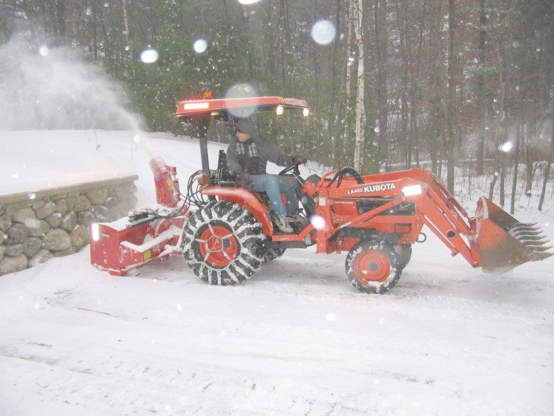

BTW, the snowblower my son is using in the picture is a Puma with hydraulic chute and deflector.
