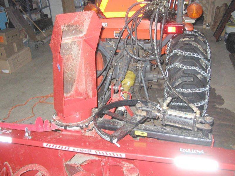

What is the good info on chute drive - I see on the Puma website they have a new gear drive. Does the older cable drive work ok ? Some dealers have leftover 04/05 models.

I had the same question. I saw a new blower with the cable that worked great but was heavily greased. Then I saw others not greased that wouldn't even turn. It seems grease is the key.
   / Snowblowers, opinions, good ones and bad ones. #23
Grease is the key for both types of chute rotation. If the swivel surface is not greased it will quickly rust and bind. You just notice it more w/ cables. Use a good water resistant grease, a marine product for example.

</font><font color="blue" class="small">( What is the good info on chute drive - I see on the Puma website they have a new gear drive. Does the older cable drive work ok ? Some dealers have leftover 04/05 models. )</font>
Mine works just fine, even after being loaded up with snow. The is a white plastic like swivel base that the chute rotates on. You can see it in the picture.
I only lube my cable with with lithium spray on lube at the start of each season.
