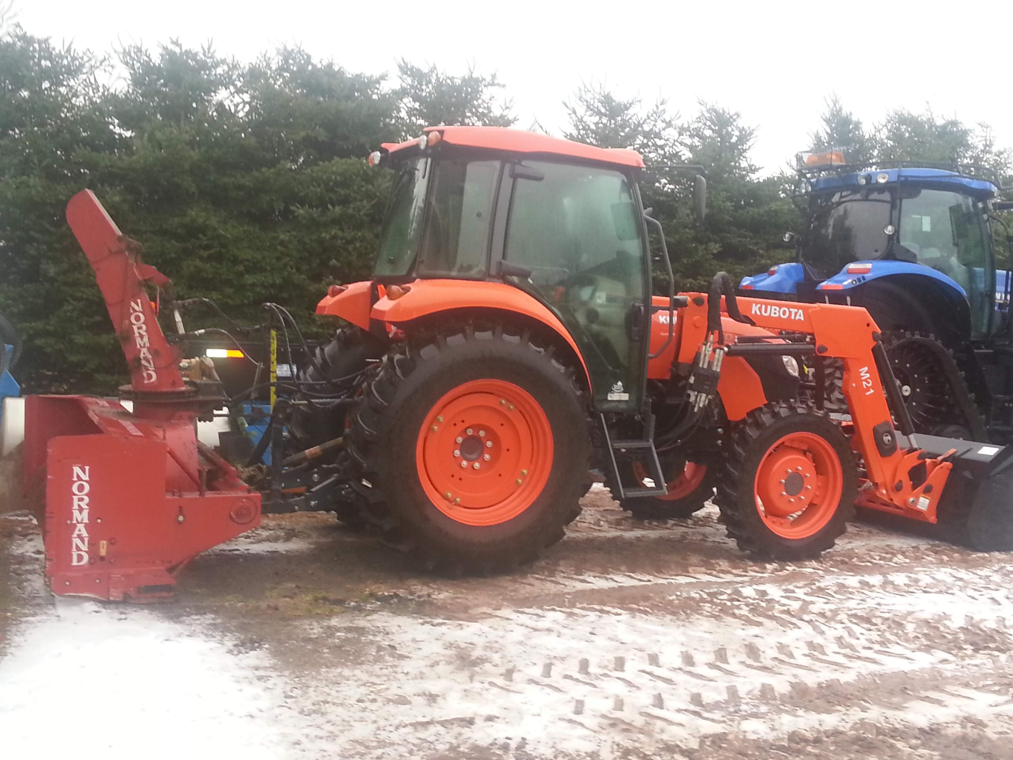

I've got a 82" normand blower on the back of my kubota l4330, 34.5 pto hp according to the specs. Bogs down some depending on the snow but all in all it works quite well, and I clear 60-70 driveways every snowfall. Having said that though, I have a new M7060 coming this week and with 64hp at the pto I'm sure it will put the old L series to shame.

It is a standard rear blower. An inverted wouldn't work in my area because of the extreme drifting we get. During a "normal" 4-6" snowfall it's not unusual to have drifts form that are 3-5 feet in height.
I am also very interested to see how the different transmissions compare, unfortunately there is no snow in the forcast in the forsee able future. But I'll be sure to post my findings when we finally do get a storm.

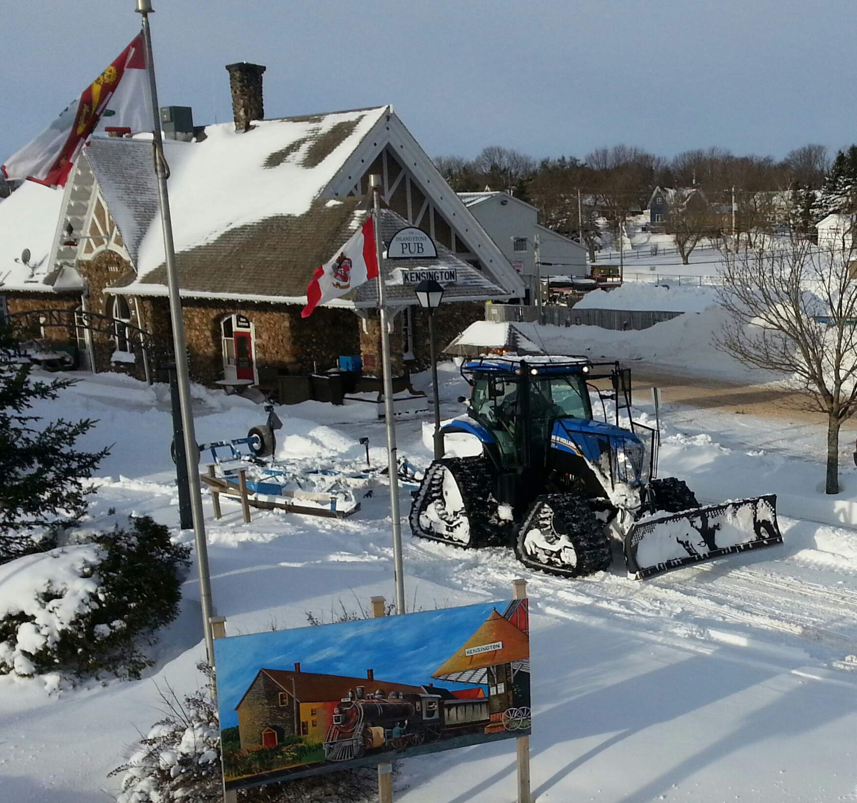

Oh, and, you can't post a picture like that, without telling us about that NH in the background! How bout a pic of that bad boy? What do you use it for that you need those monster tracks on it? Front and rear, or just rear tracks? That looks very impressive.
   / Snowblowers vs PTO HP #116
Thanks Toxic!
Oh, and, you can't post a picture like that, without telling us about that NH in the background! How bout a pic of that bad boy? What do you use it you need those monster tracks Front and rear, or just rear tracks? That looks very impressive.
The new holland is a 2013 T7.185 with auto command Transmission. Has a soucy 4 track system and a 10' six way front blade. My snowmobile club bought it last winter to maintain our trail system. It replaced a a 2001 bombardier BR180. The tractor is by far a better machine for grooming trails, more comfortable, better pulling power, compacts the snow more. The only downside would be that its not as manuverable.
