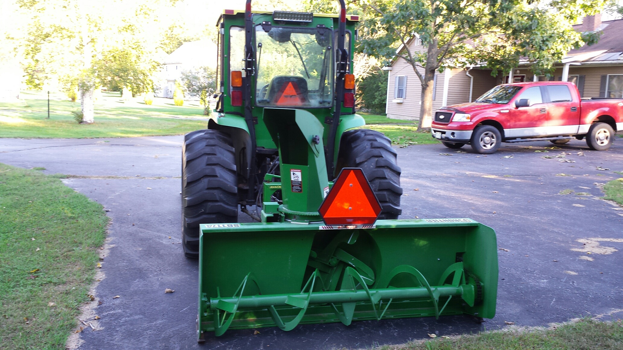

Dealer said a 72 " would fit my 2816hst. I bought a second hand one the other day, I didn't see it in person yet. At the time I thought it looked big. But he said that's what they run them with. Tractor is one foot narrower.
You do want the snow blower wider then the tractor's rear wheel track...you can see the blower on my 4520 is pretty big. It's also pretty heavy (about 800 lbs). I can't recall the PTO HP specs for a 74" Frontier snow blower, but I do recall the Woods equivalent recommended 20 PTO HP, minimum. Your Mahindra has, per TractorData.com, 21 PTO HP. I'm sure it will work OK...but probably pretty slow. If the blower is a 60" unit...well, no problem! If you don't have a loader, you might need front weights. You'll know the first time you raise the 3PH.
Good luck and enjoy your snow blower!
