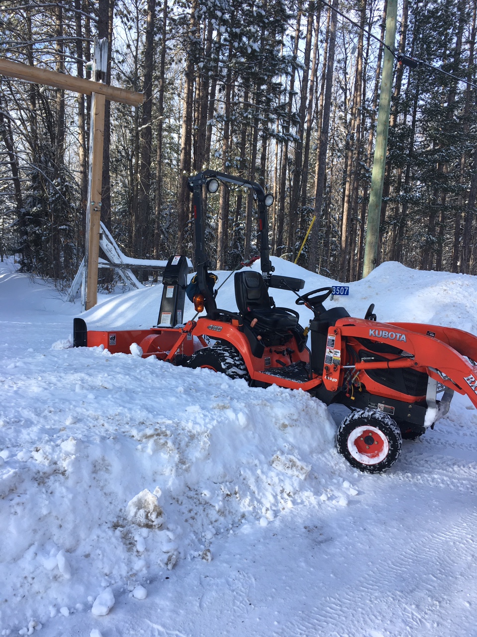

Those who have a cabbed tractor and a front mounted blower will never know the true joy of blowing snow.
   / Snowblowing rules of thumb #106
Good Lord, check. Your cup runneth over. That condition is almost BEYOND joy. THAT one picture makes my neck & shoulders ache - like in the good 'ol days. There is no question about your need for a blower. I'd have to be able to go at warp speed to get my rear blade to curl the snow over that berm.
The nice thing about an open station and 3-point blower. You can again experience a snow storm - long after Mother Natures has gone - ha, ha, ha.
