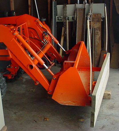

If I were to do my setup again, I wouldn't put an angle on the wooden "blade". Just straight. Normally I pull the snow away from the garages/outbuildings with an RB angled then just use the FEL pusher to do LIGHT cleanup of what's left. My kids call it Dad's "Snow-Dozer".
I used wood to keep it light, cheap and also to minimze surface abrasion. This will be the third winter, hopefully with no problems. The stuborn stuff gets the RB.

   / snowplow for a bx ideas #35
THat looks like a great idea!! WOULD a frozen icey banking break it or do you use float on the stick?

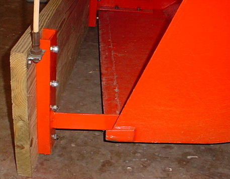

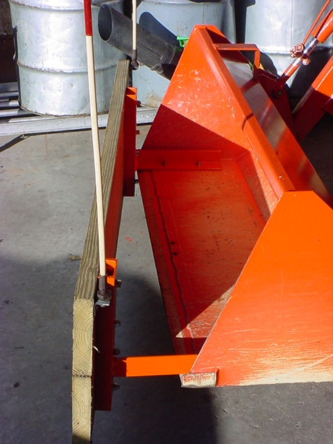

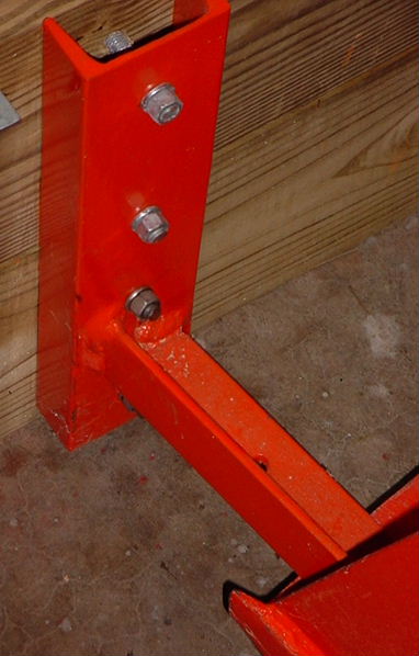

   / snowplow for a bx ideas #39
bigdad, looks like a nice simple solution. Just wondering, how far below edge of bucket are the 2x's ?
   / snowplow for a bx ideas #40
Page2,
The 2X's extend about three inches below the lip of the FEL. I did that to keep the pressure applied to the center of the bottom 2X. That three inches can help if you want to back drag a little like say away from a structure.
I do use the float feature all of the time on this pusher. Down pressure isn't really needed for such a light duty situation and by floating it the blade automatically falls off of edges of concrete/asphalt and skids over grass.
It's handy for crumbing those little ridges of snow and pushing the tops of snow piles farther away. Not made for any type of momentum snow removal. (Disclaimer..Ha!)
