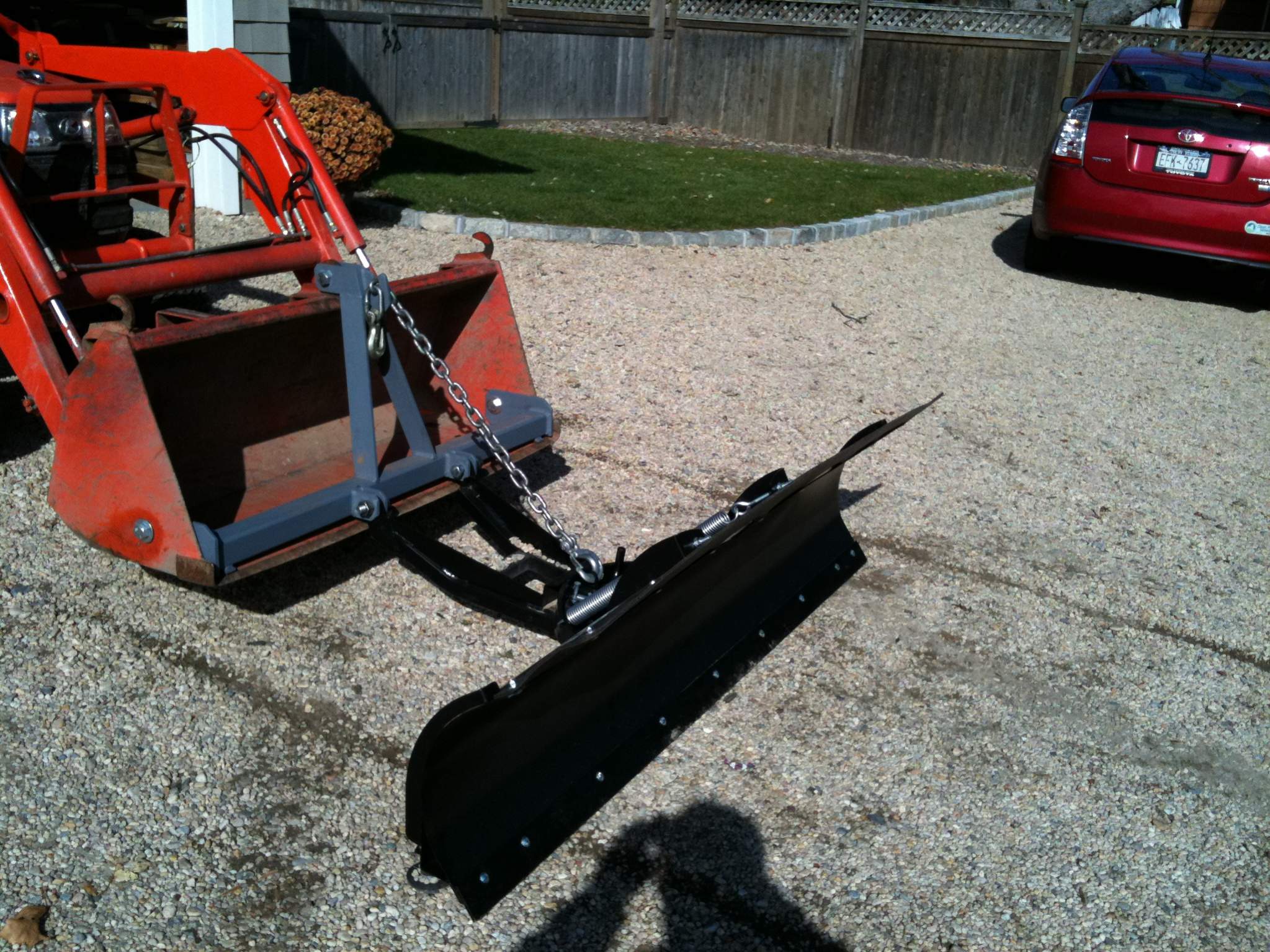

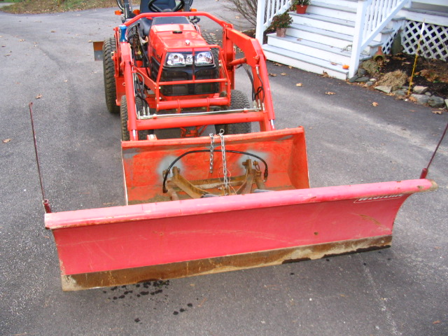

We took an old sears 32" plow and made a mount that slips about 2" into the bucket. We cut out a 61" piece of steel off of an old Diesel tank. We bolted it on and voila, we've got a 61" snow plow. Pretty durable although theres no springs.

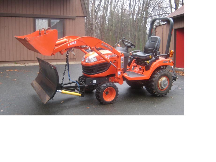

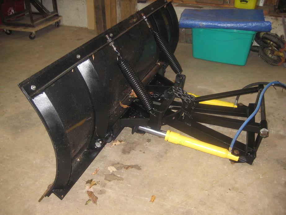

I built this plow for my 2660 from an old 90" Meyers, Cut it down to 67", and replaced the skin with 1/4" HDPE plastic. Made a mount to bolt to the front of the frame so it only takes 1 pin to connect the plow. I use the FEL to lift it and the bucket hydraulics to swing it. This is the third one of these I've built. The first was for my old BX2200 the buyer insisted that I sell him the plow with the tractor or no deal. The second one was built from a 9' Western for the 2660. Worked great but I found the Meyers and it was one of those why not moments. Any way the reason I like it this way is the FEL on a BX size machine can't handle the weight of a big plow attached to the bucket and it sticks out way to far. One pin, hook the lift chain and two hose connections and it痴 ready to plow with. I have a bout $560.00 in this one but it can be done for less.
Plow $50.00
Sandblasting $100.00
Paint $20.00
Plastic $ 109.18
Rams $178.36
Shipping $15.73
Hyd hose's $62.06
Misc. $25.00
$560.33

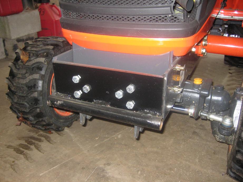

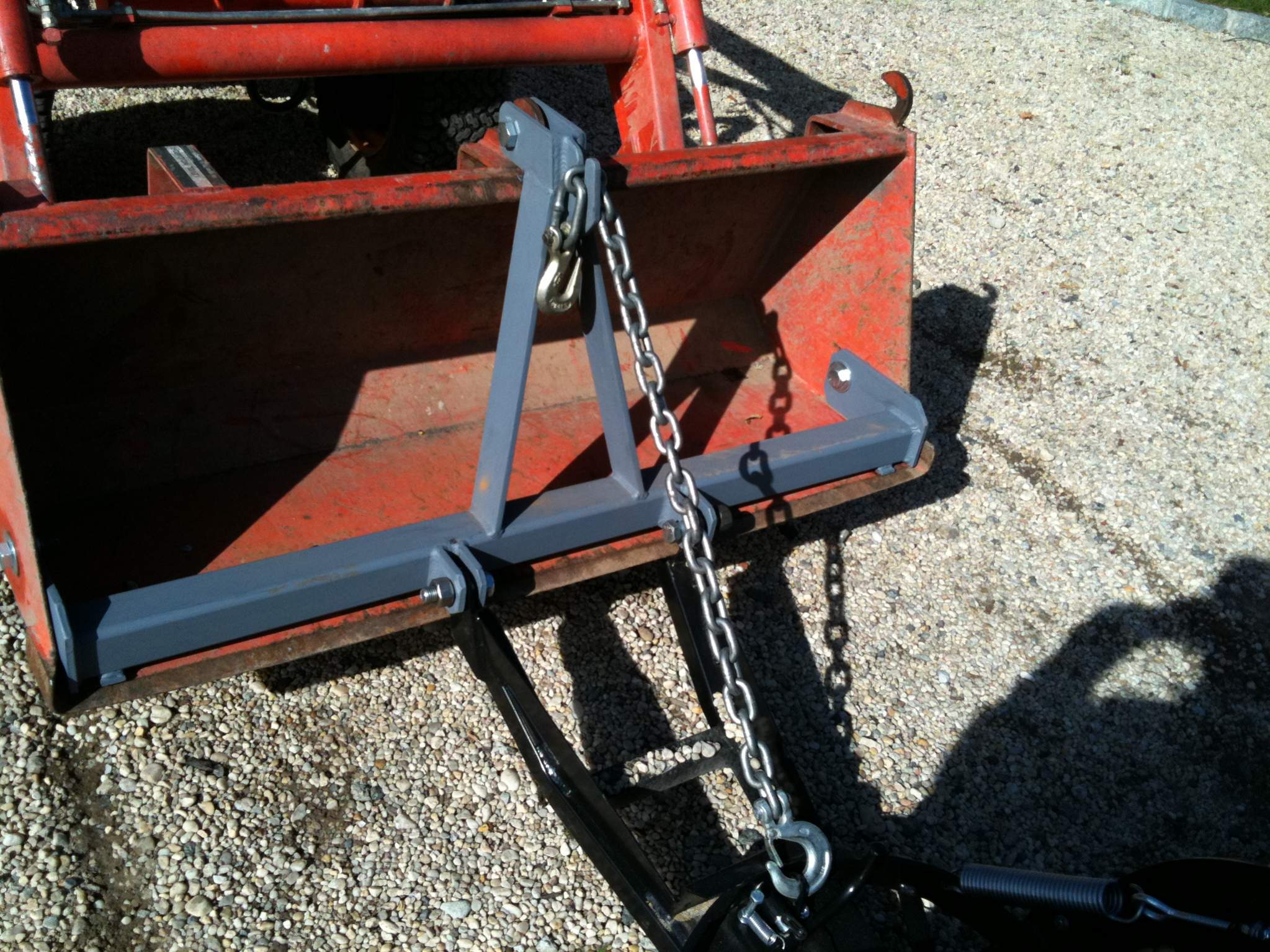

Here is what I rigged up for my B7610 and it works great...I bought a UTV plow for around $400 plus and then fabricated the mount.

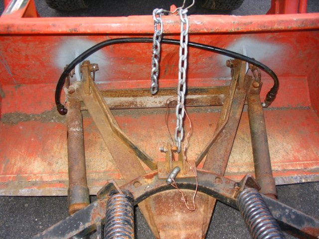

I'll try to take some pics of my setup. I built a front bumper with a 2" hitch receiver tube "nice and low". Last year, I modified an old Snowbear brand plow (cheap, lightweight, sold at Lowes, Home Depot, etc) that was previously on a small pickukp. Welded a piece of 2"x2" box tubing (hitch material) to the plow for mounting. I thought it would be a little weak and I would end up replacing after the 1st snow. We barely got any snow last year, but this year I've used it to plow our 3 big snows (2' twice and 16" the third) and haven't had a problem.
I welded a chain hook on the back side of the FEL bucket to lift and use a pin for angle.
The lightweight snowbear plow is a perfect fit for my little 1830.
