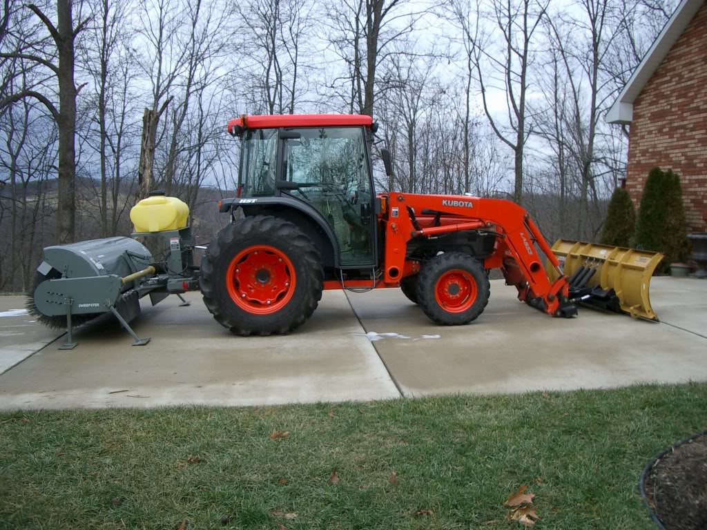

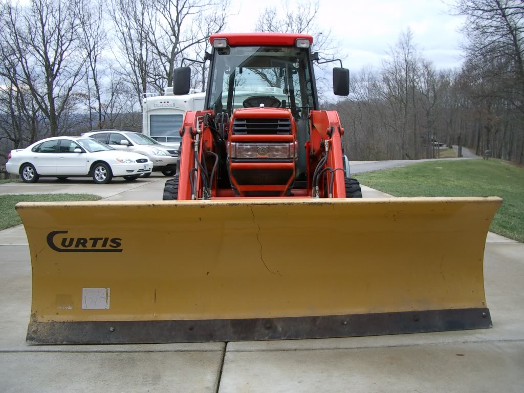

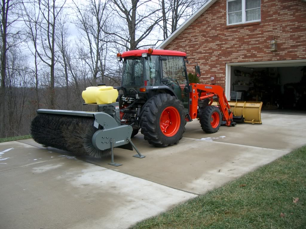

   / Snowplow that mounts on loader bucket? #23
The Ultimate Snow Removal Combination
7-Feet wide hydraulic angle snow plow
7-feet wide hydraulic angle broom with 50% steel wire 50% poly brushes - PTO Driven
All Four Wheels Chained
Cooler Full of Beer
CD Player playin some tunes
Wife retired, plow when I feel like it
