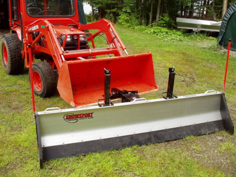

This arrangement has worked very well for 3+ years now:

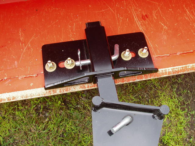

It's a Snowsport plow for a 2" receiver hitch with the angled interceptor (allows manual angling of the blade).
Agricover.com - We Make A SnowSport® For Every Need
Cost is around $1,100
I mounted a truck bumper receiver hitch upside down in the bucket with some extra steel plates. The receiver is also handy for moving trailers or my winch with receiver mount and is easily removed in the summer with 4 bolts.
If you PM me with your email address, I can send larger pix of it on the 2410.

SeymourBota, nice setup.
I had an old 7' truck plow and my quick attach FEL.
I bought a qa plate on the web and welded on the spring pins from the truck's plow mount.
I had my FEL controls swapped out for a 3 spool setup, the dealer cut me a break on the pricing.
**UPSIDE, I have a 7' steerable plow with trip edge on my FEL. I can use the FEL lift to push snow into some nice tall mountains.
**DOWNSIDE, it is too long and feels too heavy for my 3430. I make sure to not bounce it as much as possible.
Traction is fair without chains (burried somewhere by the barn) and 4x4 is a must now as most traction is from the heavily loaded front wheels.
We had a 2 - 3 foot accumulation of snow yesterday. Before dark, in the middle of this blizzard,I charged out into the field and retrieved this snowplow setup. I had hoped to leave it off this winter but after bending my scraper blade (no trip edge,right) yesterday I knew I needed to bring in the big gun!
