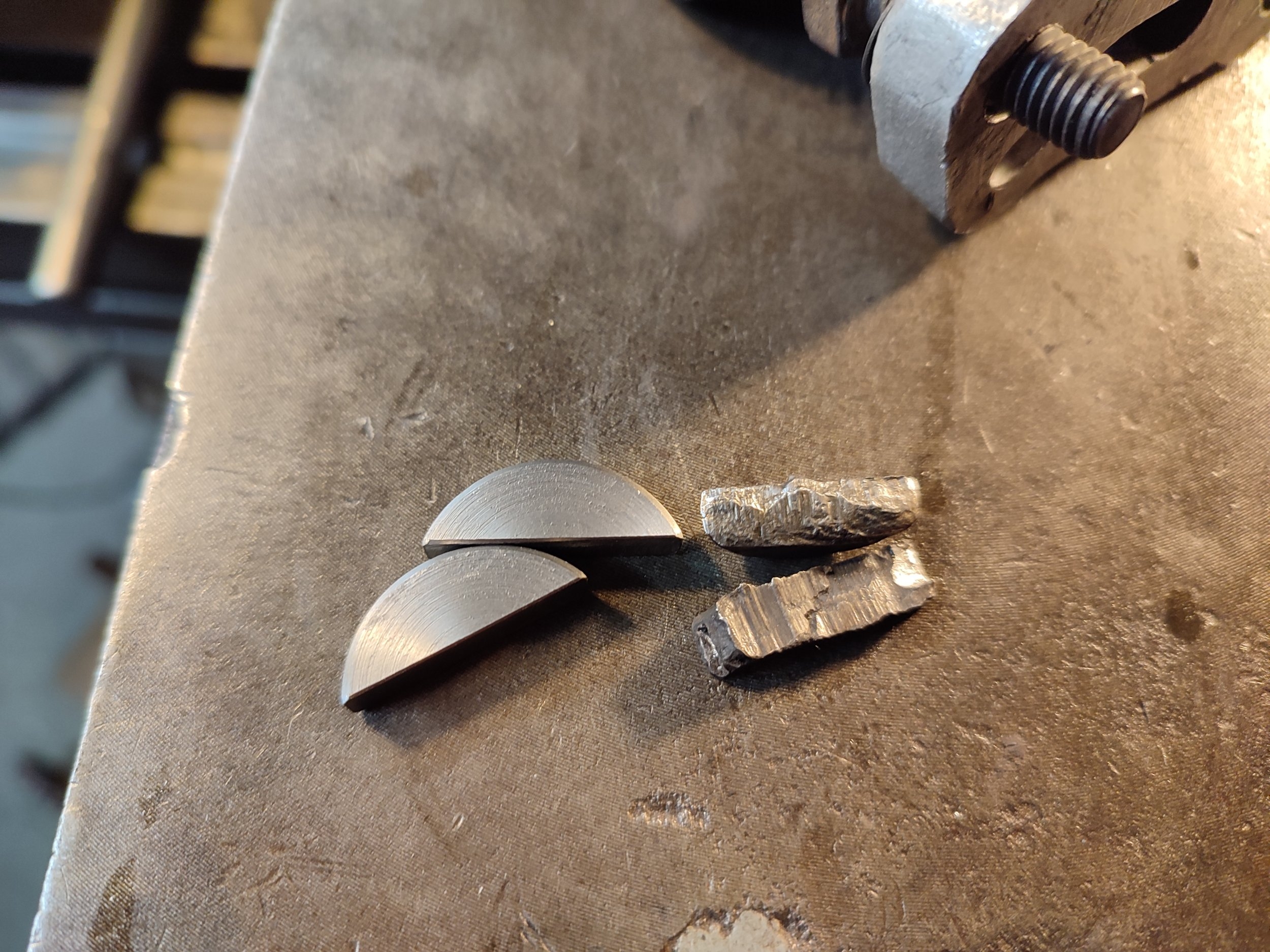

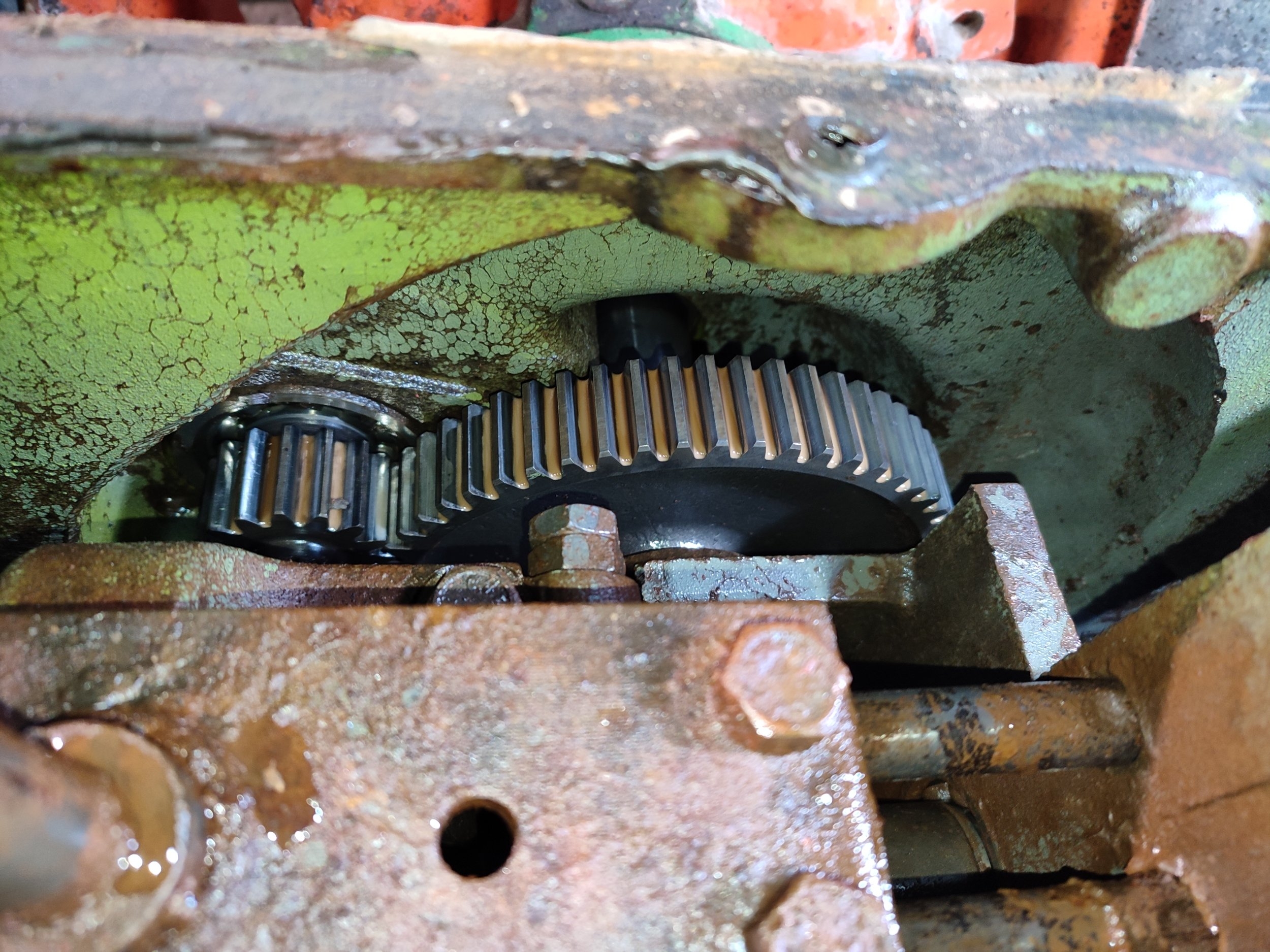

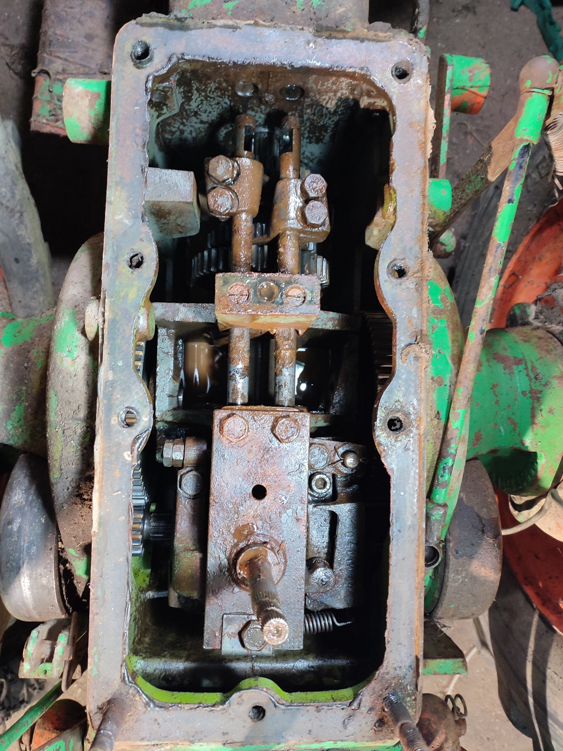

Today I spent some time dealing with the shift handle. It had so much side to side play that you wouldn't know if you're engaging 1st gear or 3rd. Took me an hour to enlarge the holes for the next size up and machine two new oversized pins. It's now perfectly and pretty much 0 play. Much much nicer to use.
I don't even know how they could use this tractor like this. I mean, they lost the clutch pedal return spring. Instead of finding another one to put there, they kept running it till the release bearing lost all the balls from being constantly pushed against the pressure plate. This, eventually, caused the pedal to hit the stop before disengaging the clutch. The solution? Smacking that pedal so hard, it bent the stop out of the way. I can't even imagine the amount of noise it was making when they pressed the clutch pedal. 🤦‍♂️

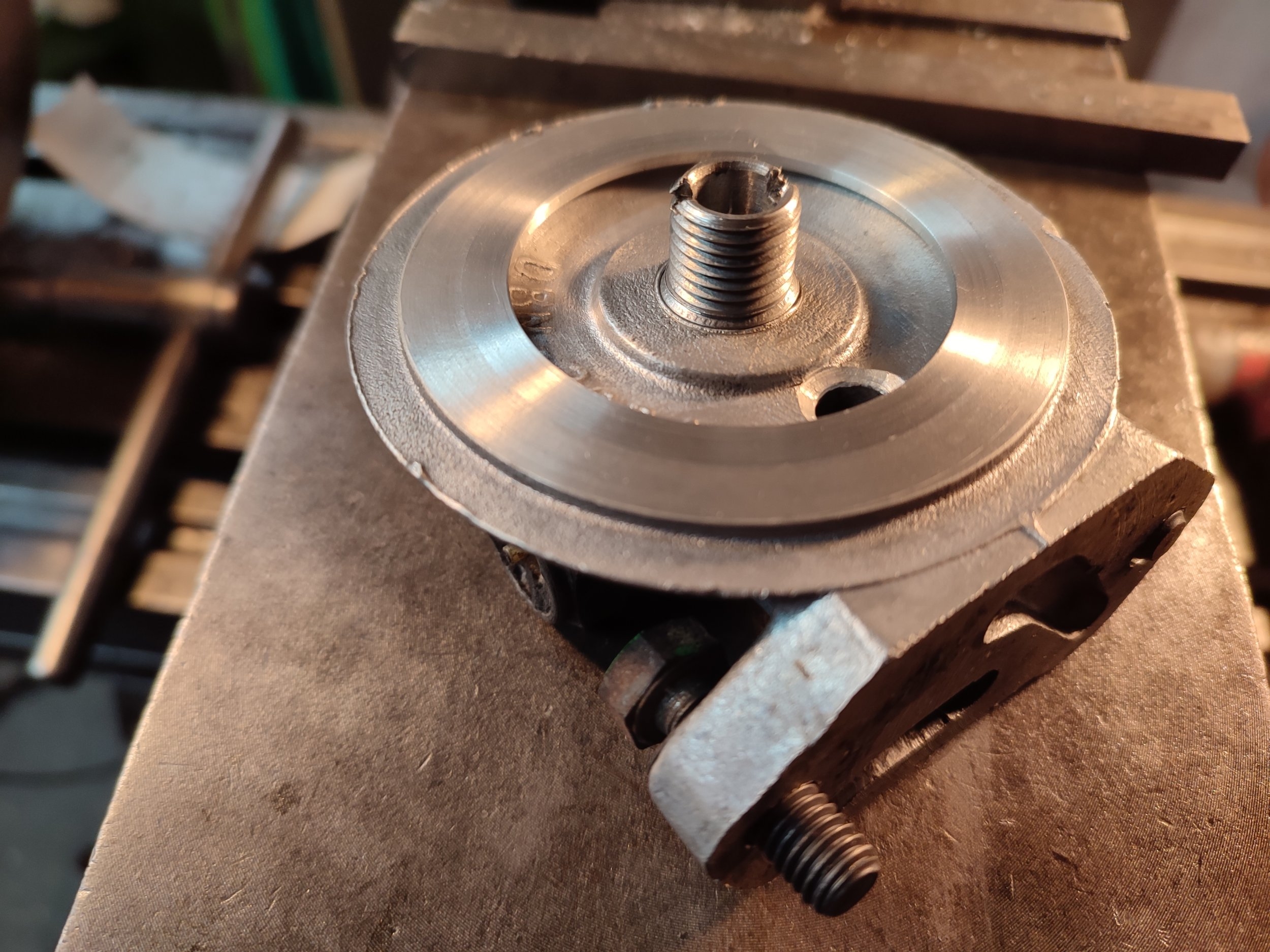

Took a break from all the cleaning, scrubbing, washing, etc and tackled the king pins for the articulated steering. Both had a lot of wear but the top one had some deep scores from the grenaded bearing.
Started by turning down the diameter from what should be 25 mm but wasn't even close to that, down to about 22 mm. Then filled it back up with weld. Finally, turned it back to the proper diameter.

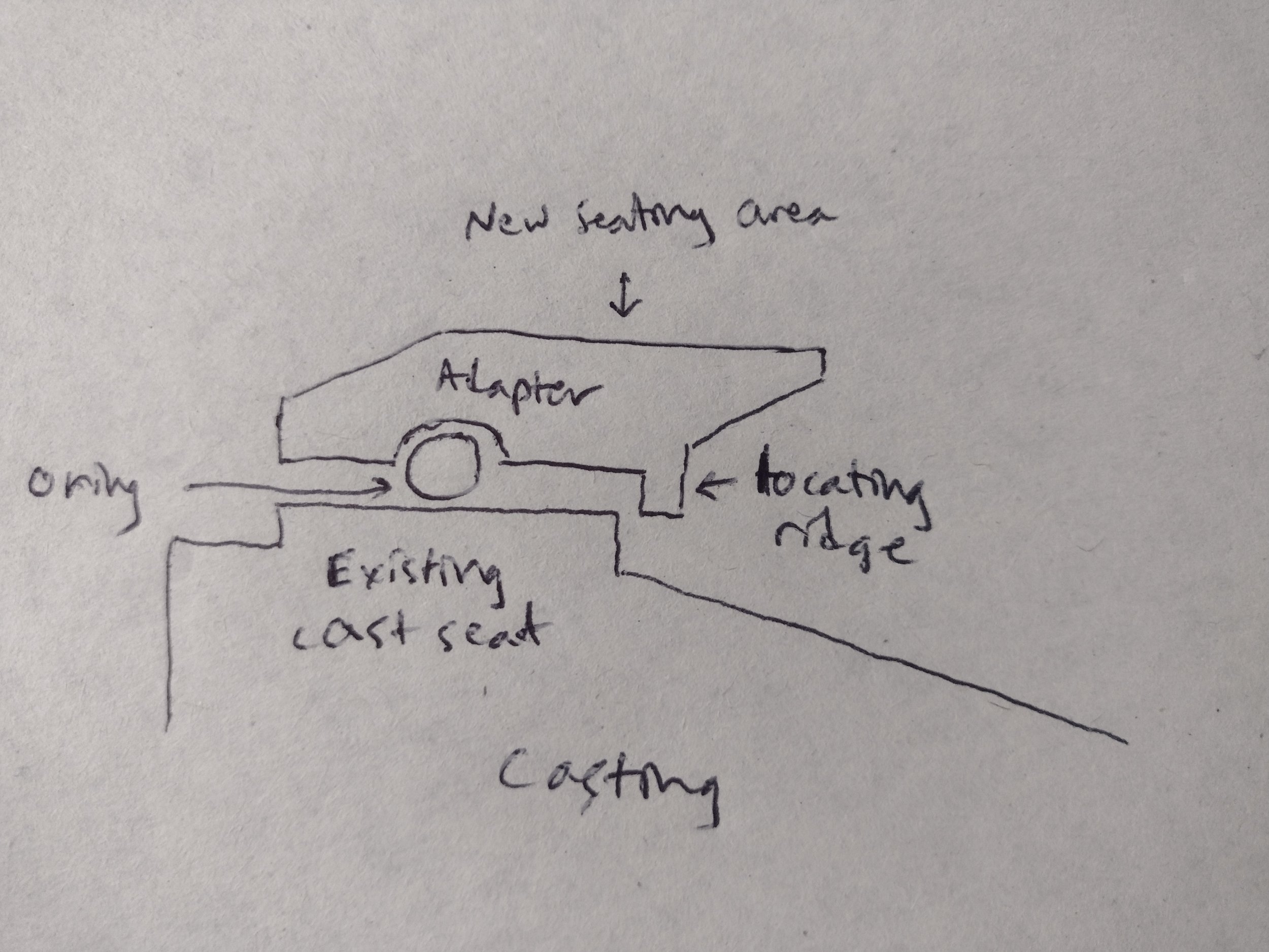

I have some build up work to do on some of the castings for the center pivot. That will be an interesting one too.
