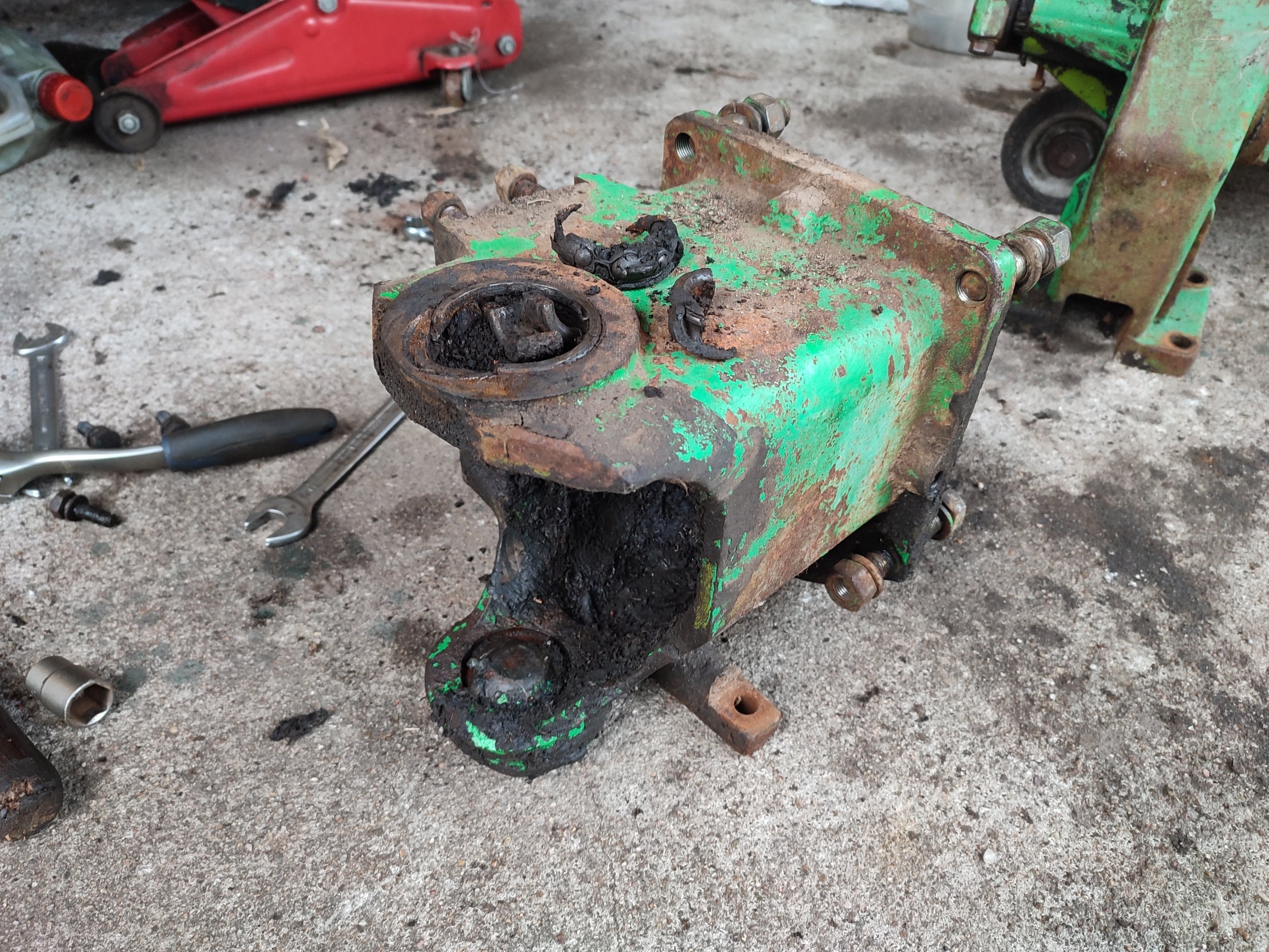

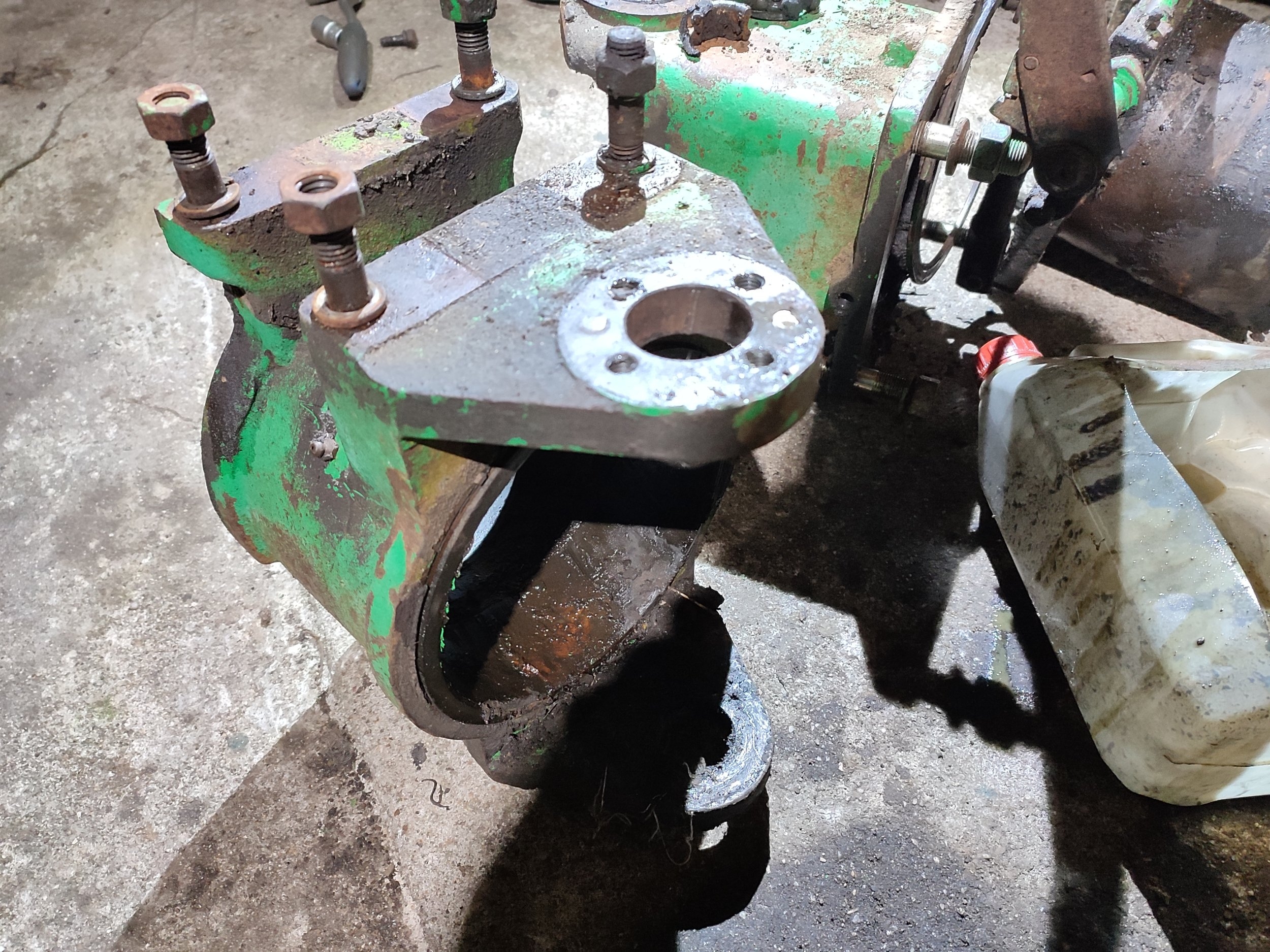

Spent the afternoon taking the center section where all the pivots happen.

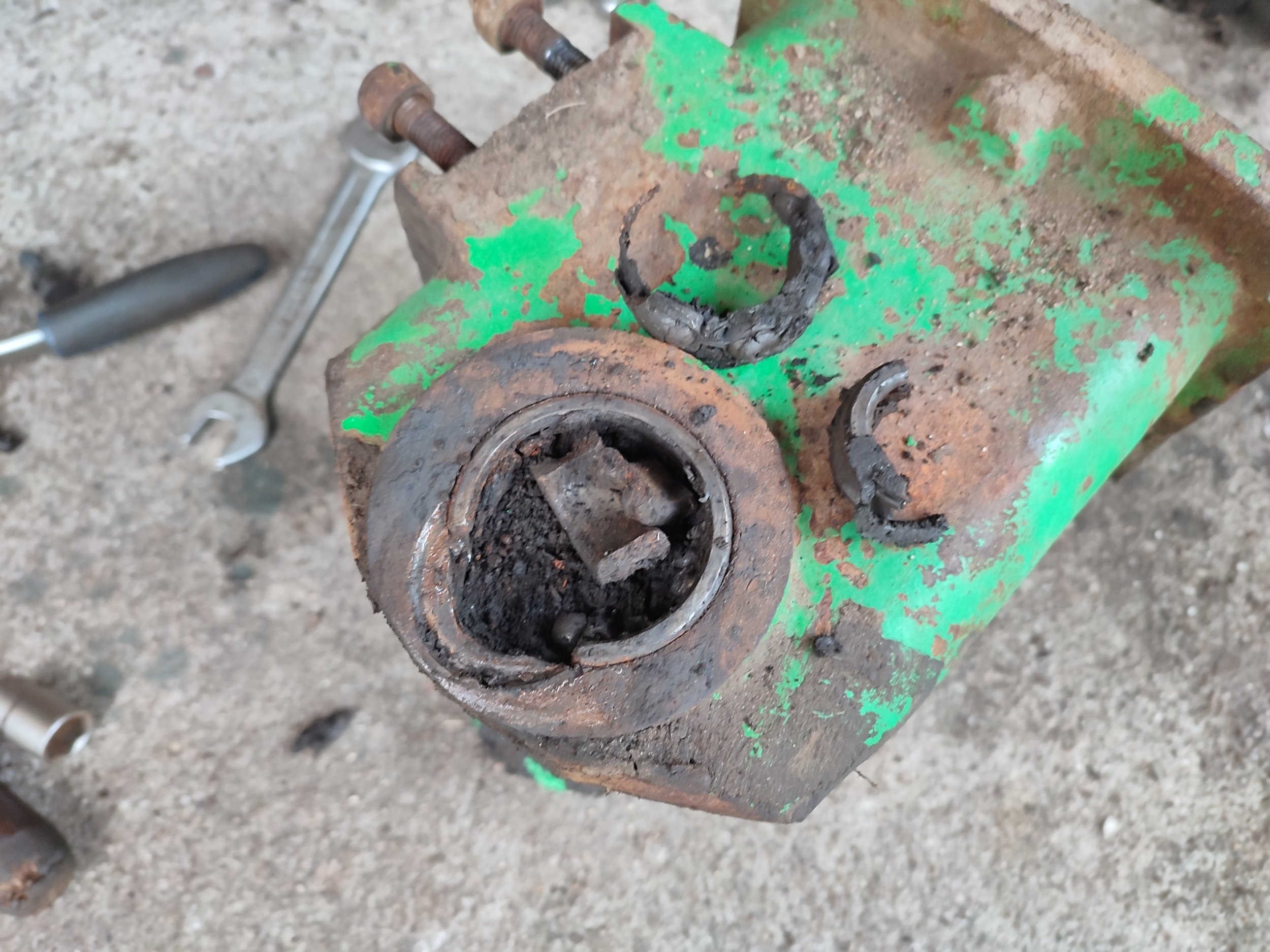

This the pivot points for the steering. Just like the lack of care on the rest of the tractor, this area didn't go unnoticed either. The top bearing gave out a looong time ago, as you can see in the picture, so they just kept on running it till it ate part of the housing. Another thing to fix. I was hoping it was just a bad bearing.
On the other hand, the parts where the front half twists in relation to the back half, like the front axle pivot on a regular tractor, still had the nylon bushings in decent shape. Decent enough to put some shims behind and run it that way. I was afraid the bushings were gone and it had already started eating some material.

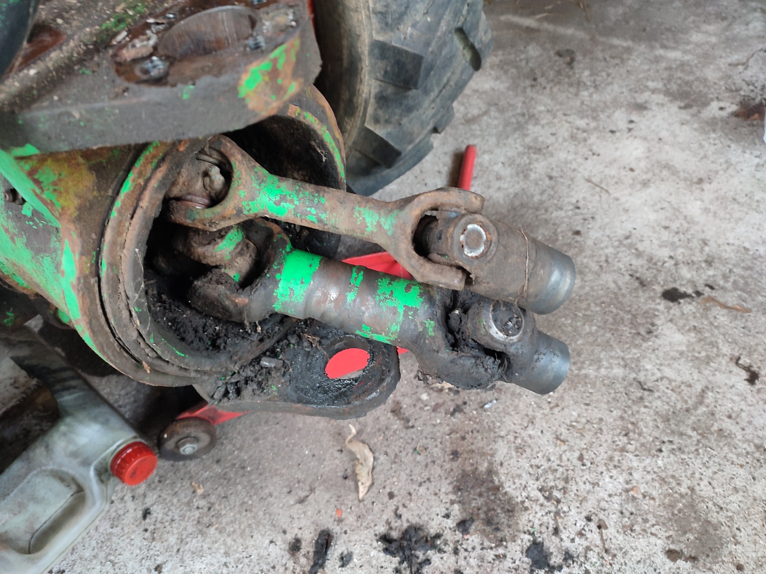

On the bright side, and this was another worry of mine, is that both driveshafts were in fairly good shape. Splines still in nice condition and the U joints, while not perfect, still in good enough shape and very little play.

That top bearing is really something. I hope you have a vertical mill with a big enough table or a large swing lathe to be able to bore and sleeve that.

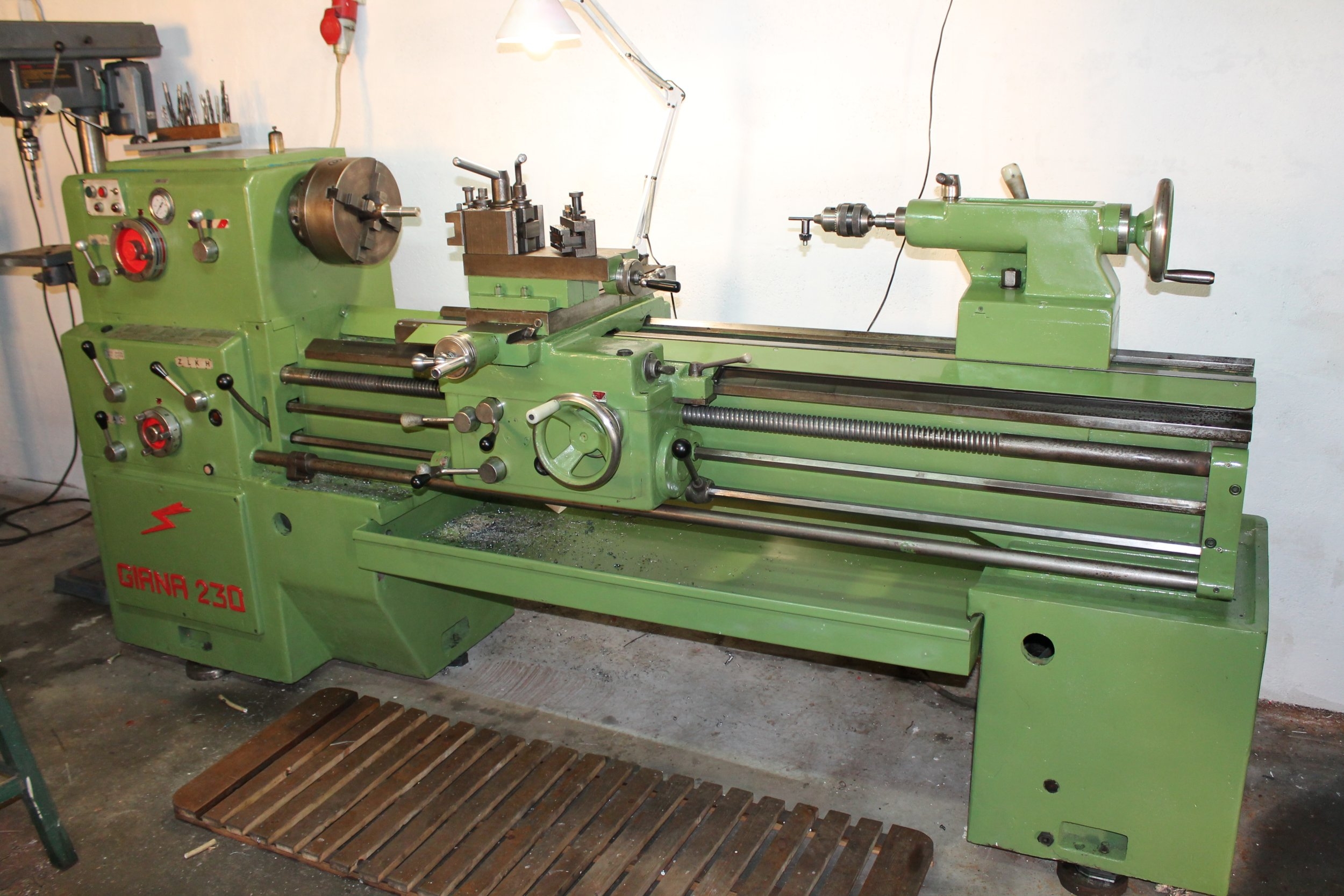

I have the classic Bridgeport milling machine and an Italian Giana lathe, if I recall correctly, about 24" or 25" of swing and about 60" between centers. However, being an Italian lathe, it's, what they call, a double bed style lathe. Basically raised headstock and tailstock. No need for a gap in the bed and huge amounts of swing for the size.
I've swing some big stuff on this lathe.
I've noticed a lot of factory welded parts to cast iron on this tractor, so I suspect it should weld relatively well. My plan is to fill the wore out part with weld and then machine it back to spec. Either on the mill or, preferably on the lathe if there is enough room.
