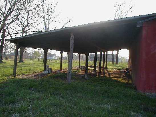

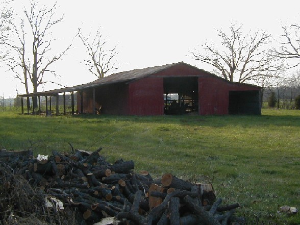

...and I'm not really sure what I should do with it to fix it up.
It's pretty big to me at 65' deep by 45' wide plus a 65' x 25' lean to. The floor is some mix of dirt, straw, gravel, and nearly fossilized horse manure. It's full of old lumber, windows, siding, a few rusty old bicycles, carpet, pallets, an old 240v rotisserie, 5 cats, and a couple of pigeons. The doors on one side of it are gone and the doors on the other side are being held up by a metal pole braced against the ground. There are currently no utilities run to it but it looks as though there was electric service to it at one time running a single light bulb. As you can see by the picture, it's a low barn with no hay loft.
My plan is to have a couple of horses on the property with a couple of horse stalls to match. I'll need a place to store some hay, horse gear, etc. I will also have a CUT and associated implements to store. I don't have any sort of workshop right now either, so it could possibly go out in the barn or could be a separate building.
I'm looking for thoughts and ideas from this experienced group of how I can best refurbish and use this big building to it's fullest potential. So...hit me with your best shot...

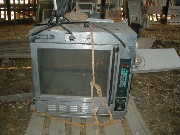

Anybody want a rotisserie??

Actually, it looks to be in pretty good shape. The two things I'd look at first are the poles and the roof. Whack each pole at the base with a hammer -- not too hard -- and see if the wood sounds good. If it does, then decide if the roof needs replaced. That can be costly, but the rafters and such look solid from the pics. From the looks of the barn, I'd clean it out, paint it and rehang the doors.
Not sure exactly what you want opinions on, but I think that's a pretty nice barn.
If you want a workshop, you can cut out a section inside and put down some concrete without doing the whole thing.

Don't be too quick to discard that kitchen equipment. The commercial grade stuff has good value as long as it's not to beat up, an ebay search might give you an idea of what you have. At least it may not cost you anything to dispose of it.
An awl or screwdriver is also a good way to test wood, neither one should penetrate more than an 1/8" is good wood. If the structural members are solid and the roof doesn't have too many leaks, it's a keeper. How to restore it depends on how much you want to spend and if you want air tight or just rainproof.

I didn't notice an sags in the pictures. In fact, I was impressed by how nice it looked. Is it dry in there? A new roof could be price, by metal roofs patch pretty easily, just not pretty.
First thing I'd do is check every single post in the ground. This is your anchor point and the most likely to have rot and decay.
The hammer is a good tip. Hit them hard!! Don't be shy. I also like to have a long, skinny tipped screw driver and see if I can penitrate the wood by stabing it.
Look aroud on the ground for sawdust. This could mean bugs!!! Look for dirt tubes going up the posts. Especially at the base. Termite build tunnels to get to the wood when the come out of the ground.
Especially look extra close at those posts outside in the lean to. They look like cedar, but what ever they are, they don't look like they have been treate.
Look up and down each post. Look to make sure it's straight and the perlins are solid. Look for gaps in the siding.
Do this at every post. Develop a routine to do the exact same thing in the exact same order for every post.
Carry a notepad and something to mark what needs fixing. Don't rely on your memory. Too easy to forget something. Especially if you find a list of issues.
After you do your inspection, either fix it, or post what you found and maybe somebody here will have a simple solution that you might not have heard of before.
It's a good looking barn that has allot of potential.
