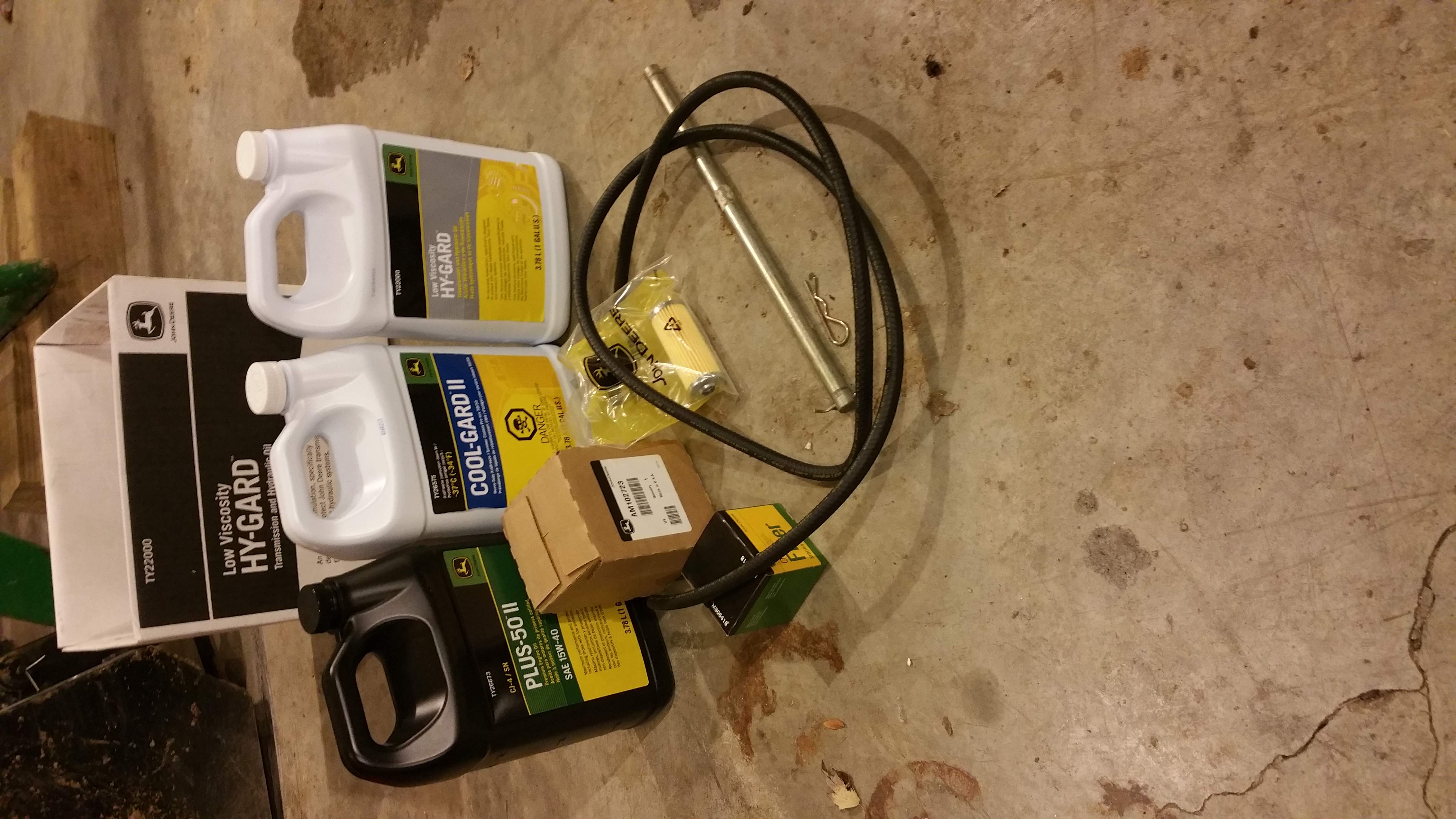

I ended up just ordering a new sender/pickup with screen.for 80.00 bucks I just figured what the heck
I got the tank pretty clean.I was able to get all of the gunk out other than a thin film stuck to the sides about half way up where the tanks opens up to another cavity
I also didn't care the way the inside of my radiator looked so I am dropping the fuel tank and radiator off at a rad shop to be steam cleaned this week
Bought all new fuel lines,filters for all fluids and of course I'm gonna change all fluids while I,m at it

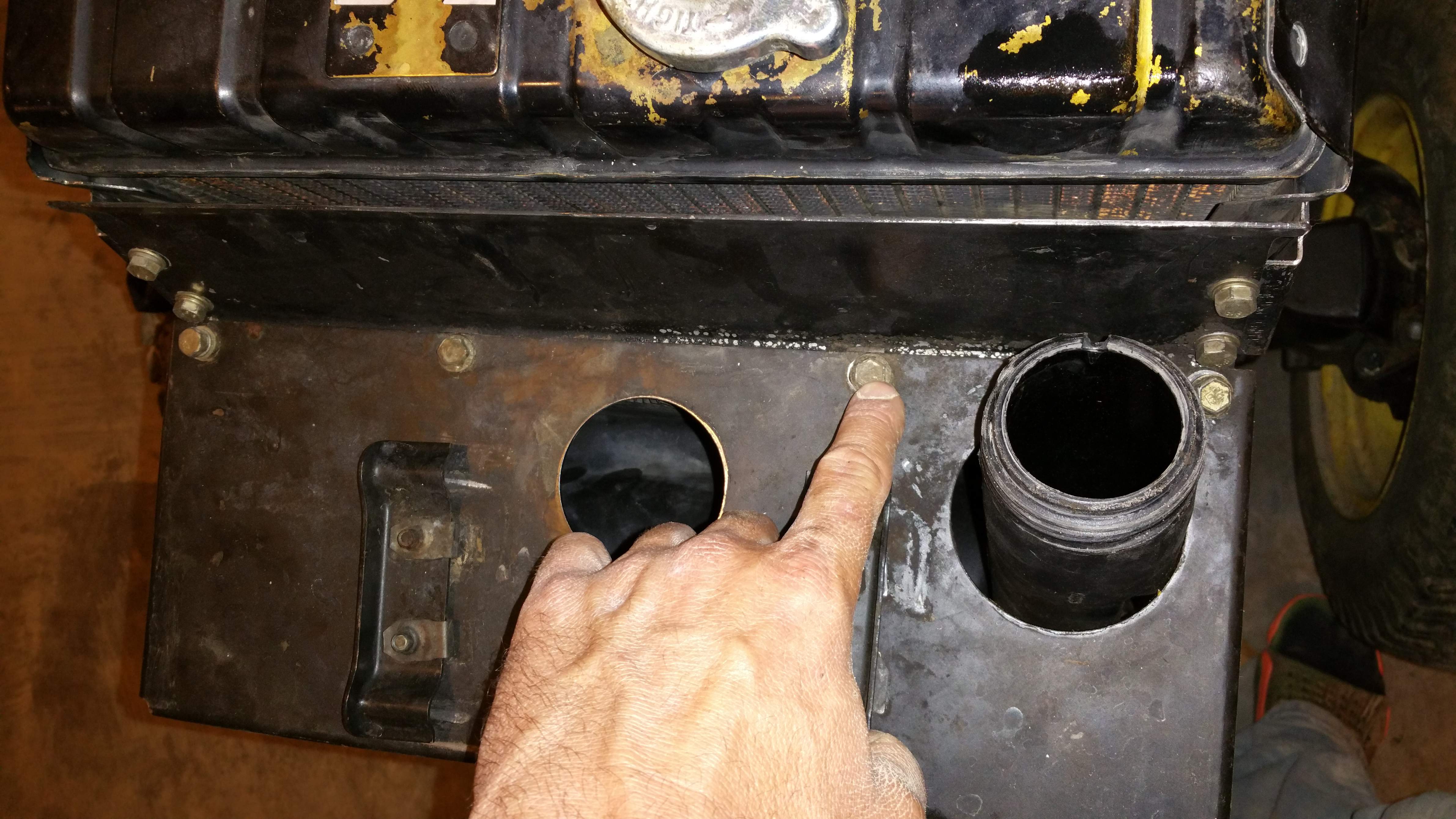

#14

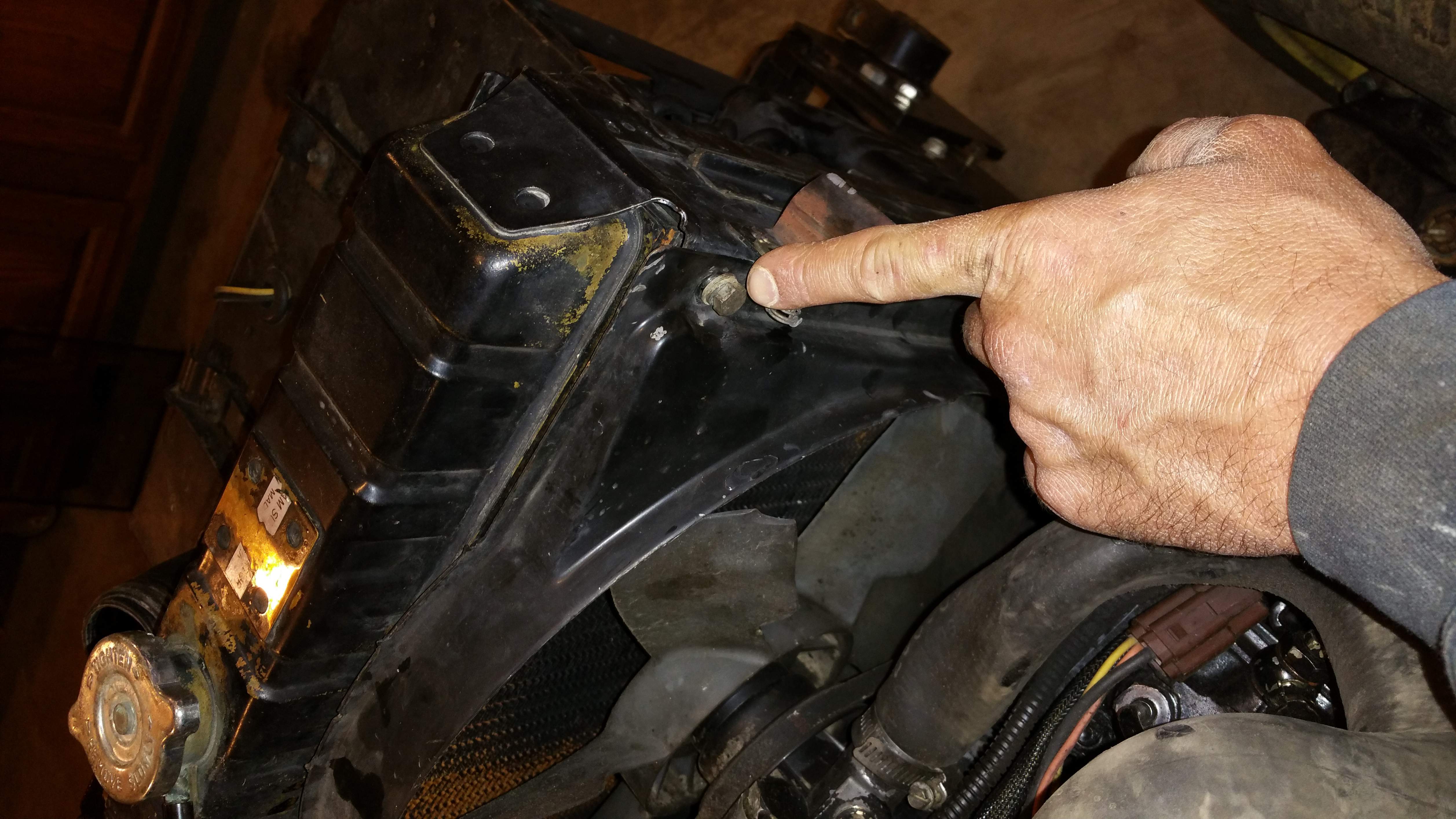

I just went out in the garage and reassembled the parts....well most of them to give you a better visual
we will skip past the side covers and grille removal

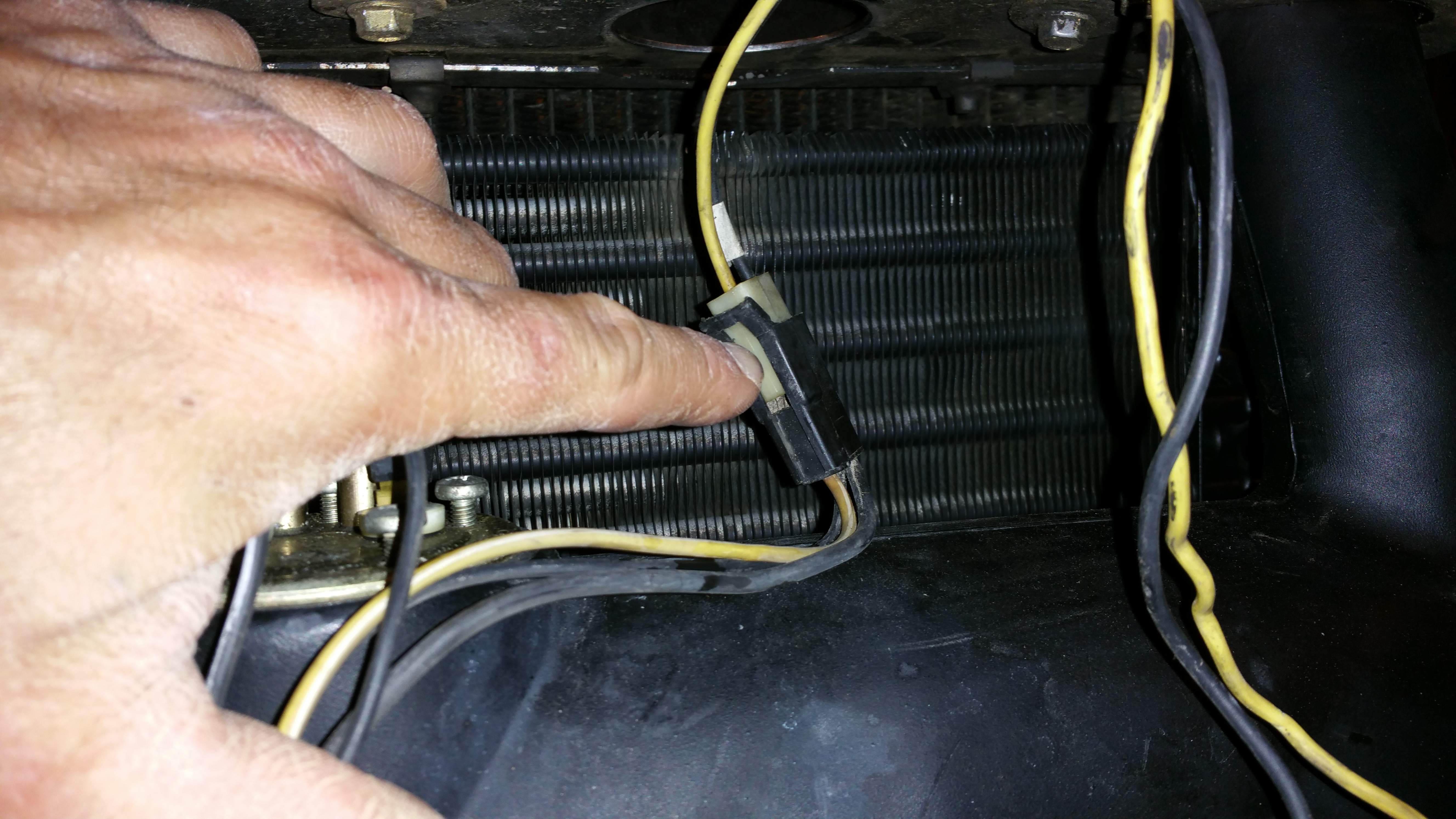

loosen the 4 10mm bolts holding the hood hinges to the radiator housing bracket.disconnect lights from hood.remove hood
remove 4 10mm bolts holding the fuel tank shroud to the radiator bracket

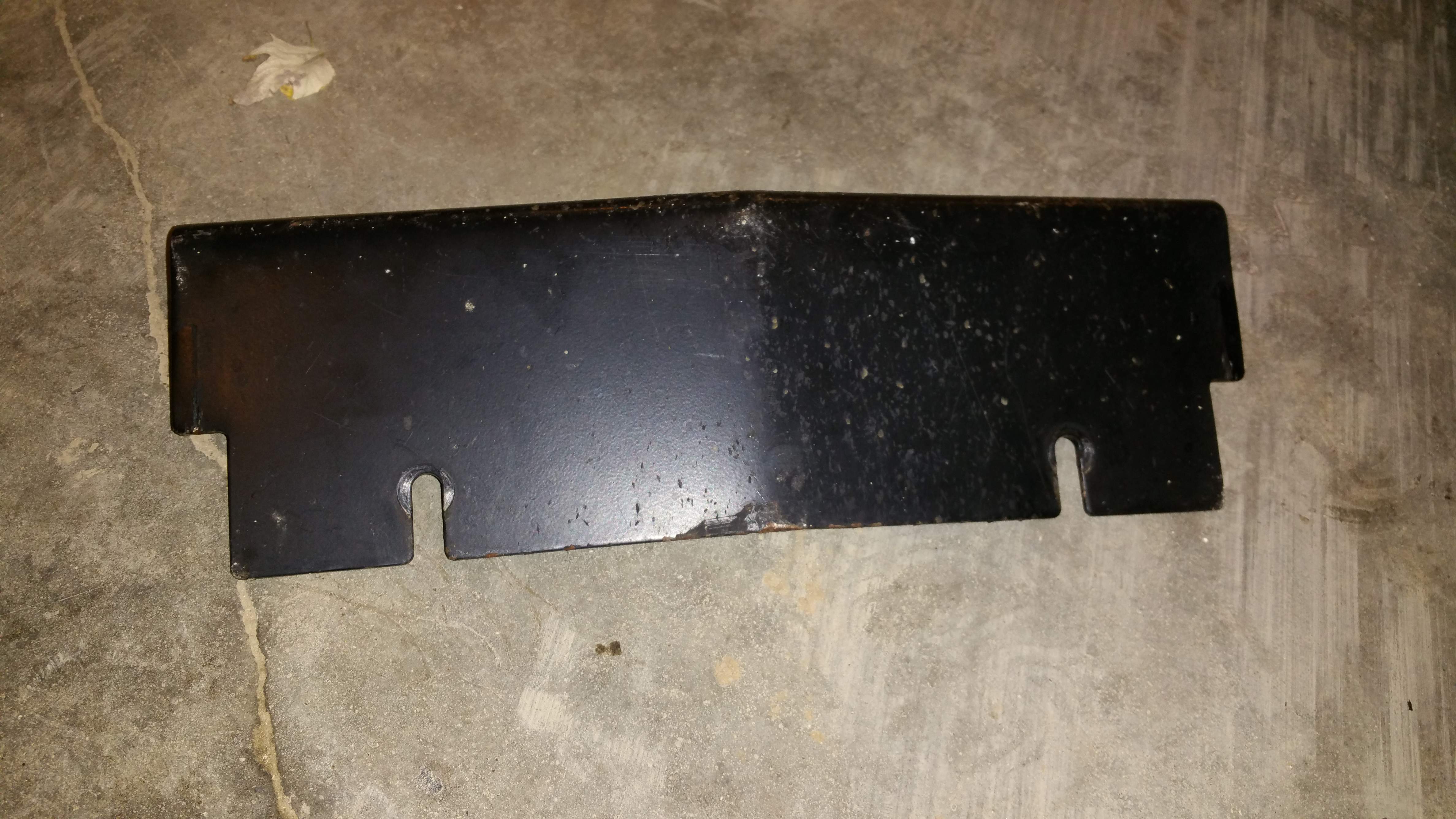

remove 4 13mm bolts from the fuel tank shroud attached to the frame.disconnect lights harness.remove tank shroud

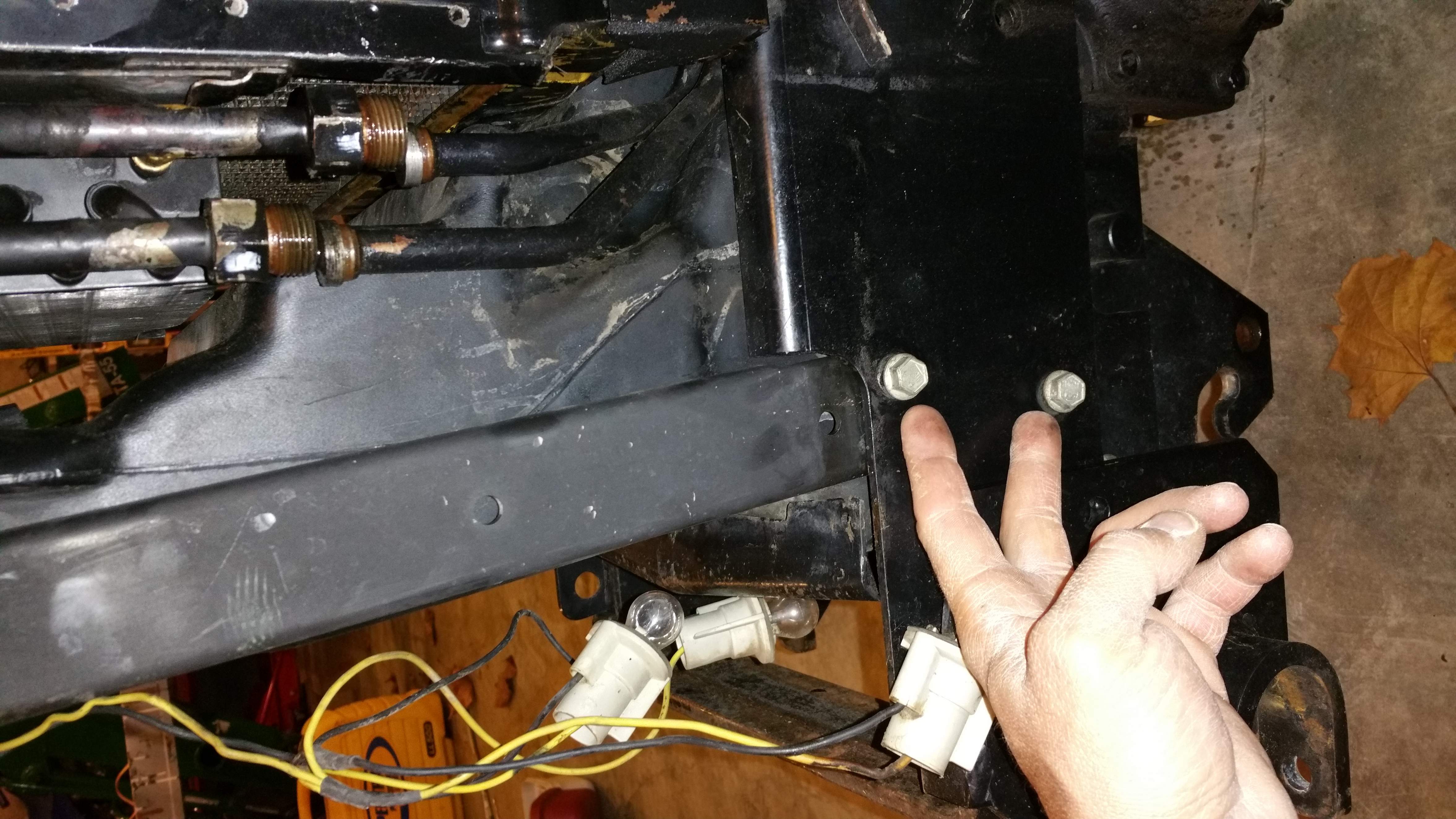

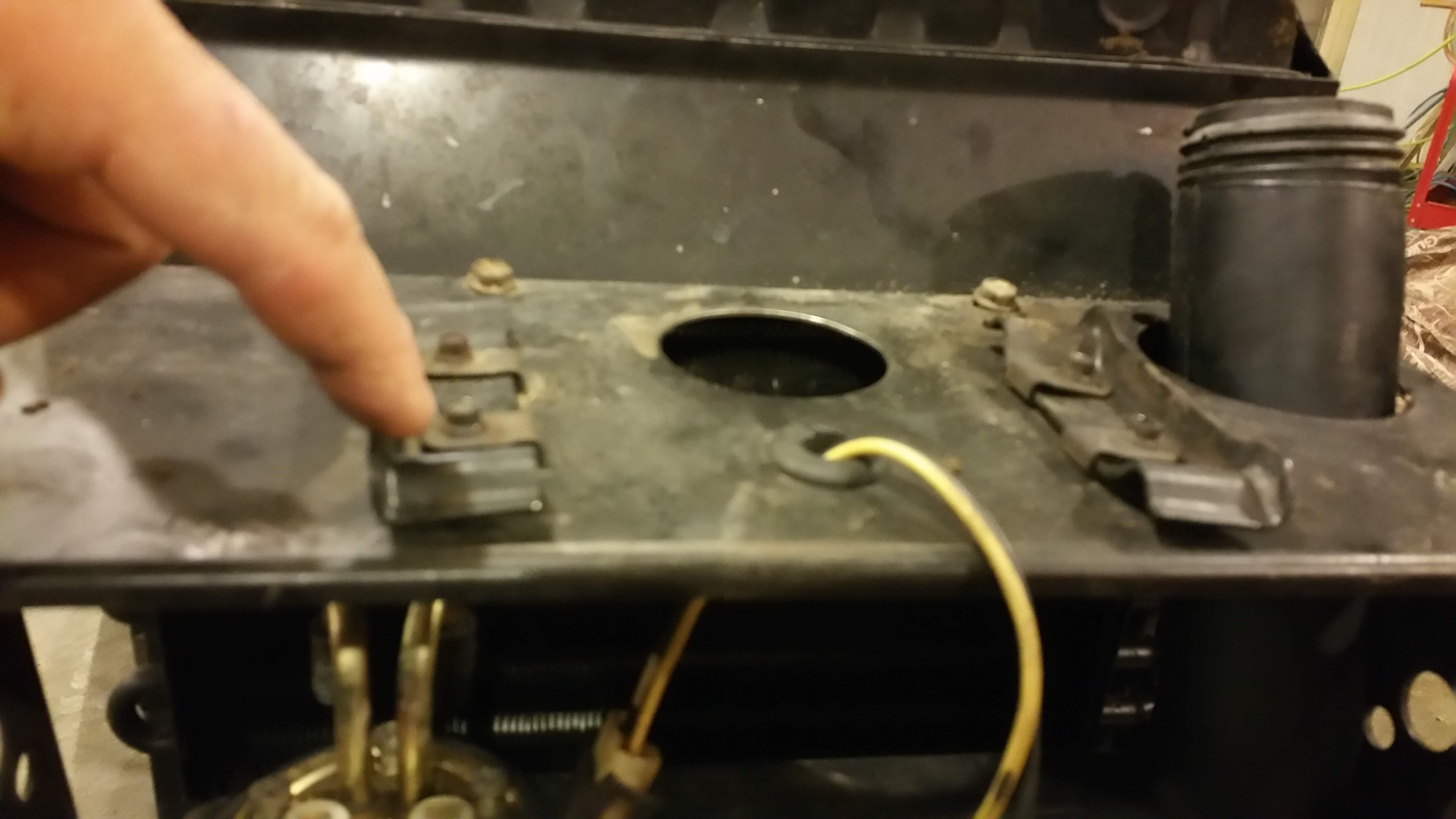

remove 2 13mm nuts from the bracket in front of the fuel tank

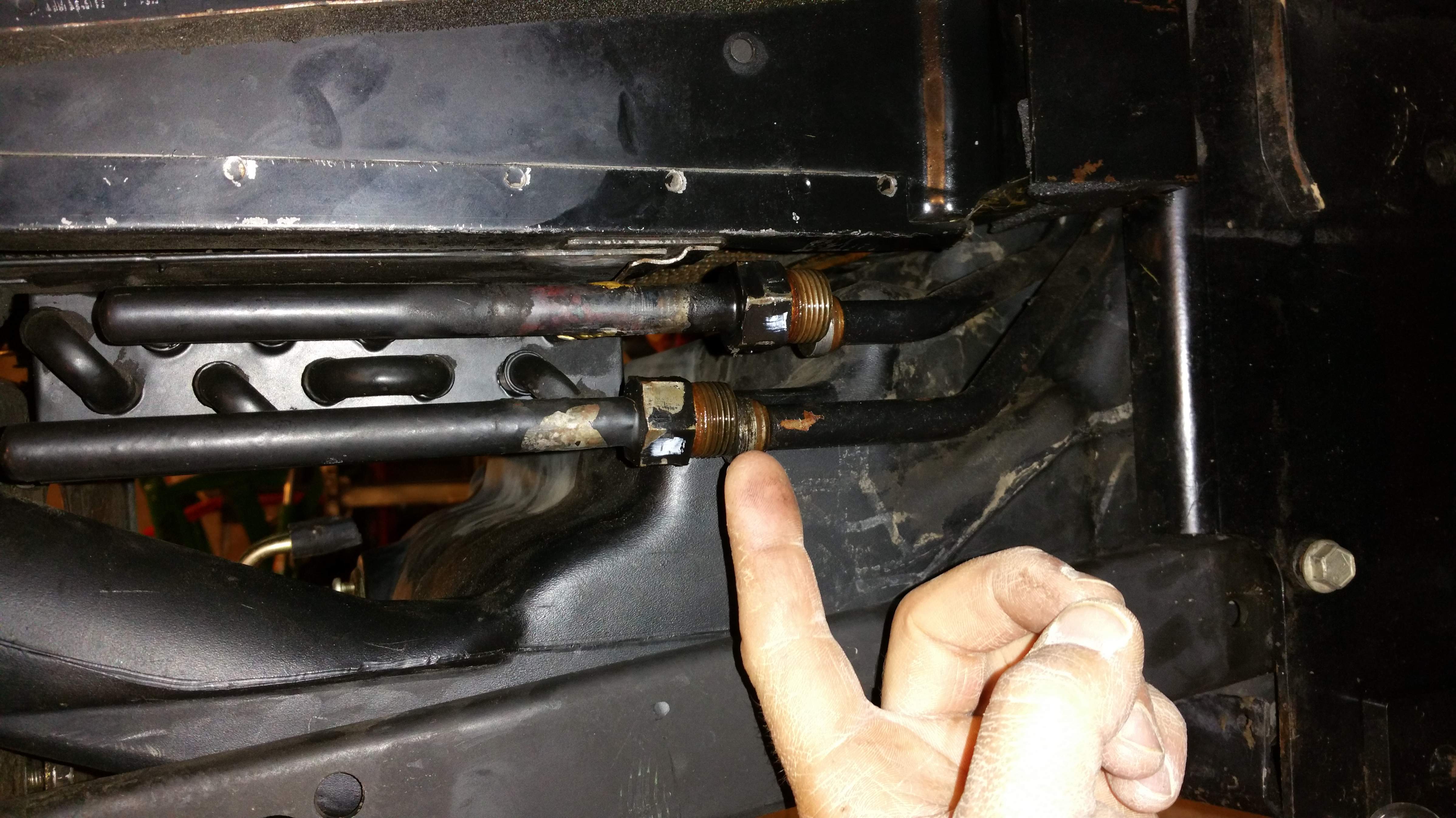

disconnect the two oil cooler hard lines next to the radiator.you will need a 15/16 and 7/8 wrench.I took my time here;) you may be able to skip this step but it didn't feel right leaving them attached

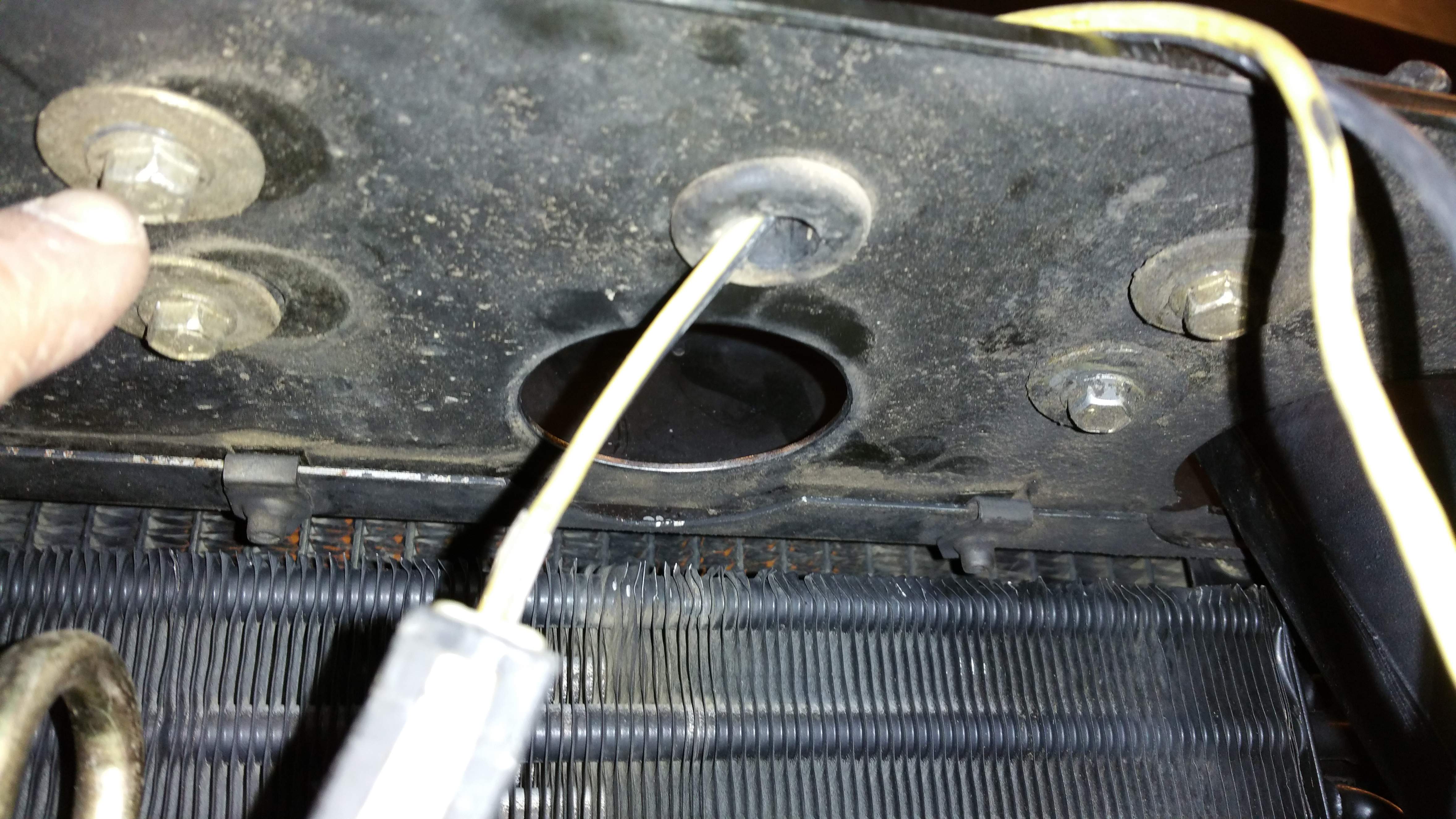

remove the 4 10mm bolts holding the radiator fan shroud to the radiator.slide shroud forward and rest it on the fan

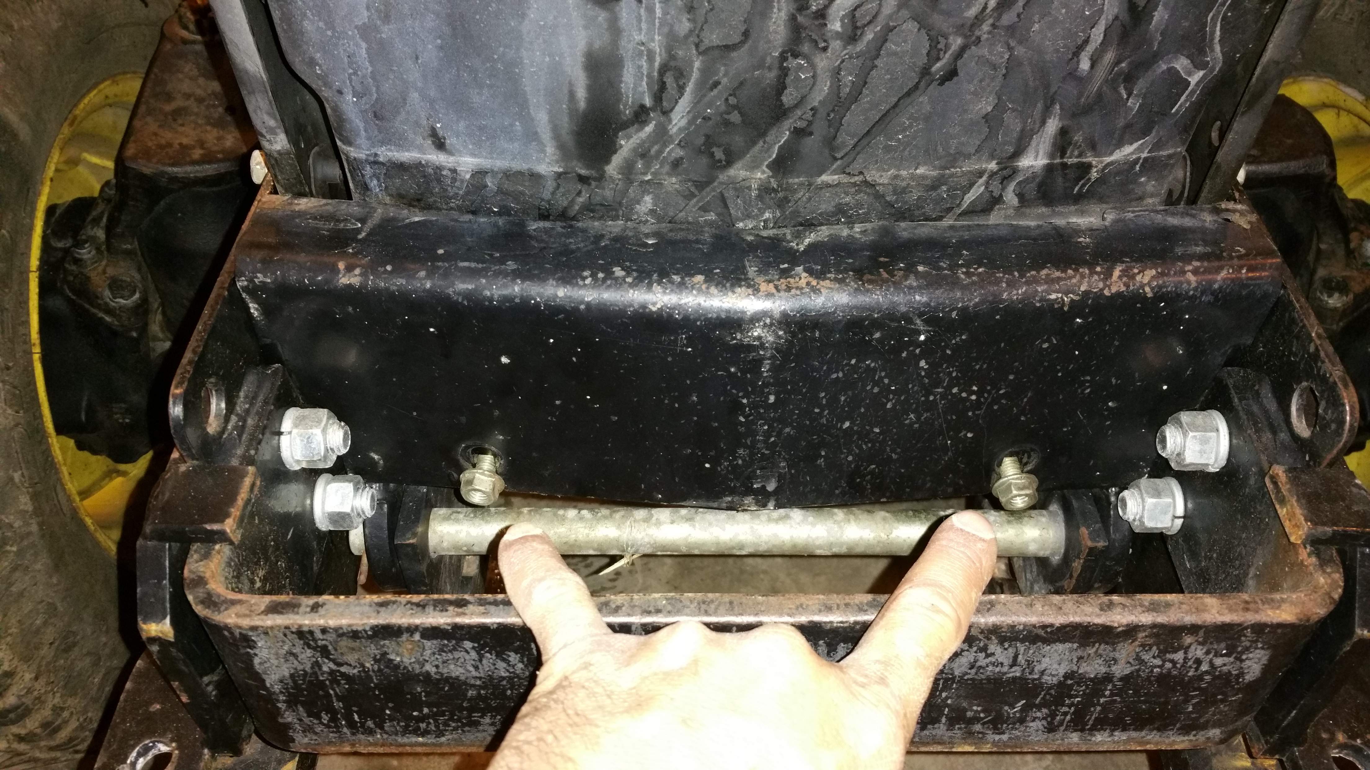

remove both fuel lines from engine side
slowly raise the radiator up about 1'' while pulling the fuel tank outward.that should get you where you need to be.
I went one step further and pulled the radiator to inspect/clean it and replace the fan belt
I have never posted pictures in on how to do anything so I may have skipped a step or you seen something different as i just reassembled it real quick to make a brief tutorial for you
if you have any other questions regarding removal feel free to ask:D
