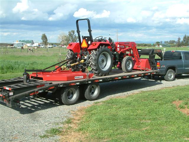

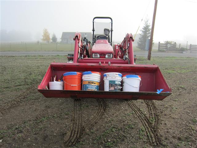

I'd look for something in the 35-45 hp (pto) range with 4WD, hydrostatic tranny (HST), power steering, FEL with 6-ft wide bucket with three chain hooks welded onto the top of the bucket, dual rear hydraulic remotes. There are several dozen models from various manufacturers that would fit the bill.
My everyday tractor is a 2008 Mahindra 5525 (54 hp engine, 45 hp pto, 2WD, gear tranny 8F/2R, power steering, triple rear hydraulic remotes) with the ML250 FEL (6-ft wide bucket, 2950 lb lift to 10.5 ft height at the bucket pins, 3 chain hooks, skid steer quick attach feature). Cost: $19K (new).
DSCF0051 (Small).JPGIMG_0904 (Small).JPGRemotes 5525-1.JPGRemotes 5525-2.JPG5525 SSQA.JPG
My 5525 doesn't have all the features I recommended for your needs, but it'll give you an idea of something that's pretty close.
Good luck.
