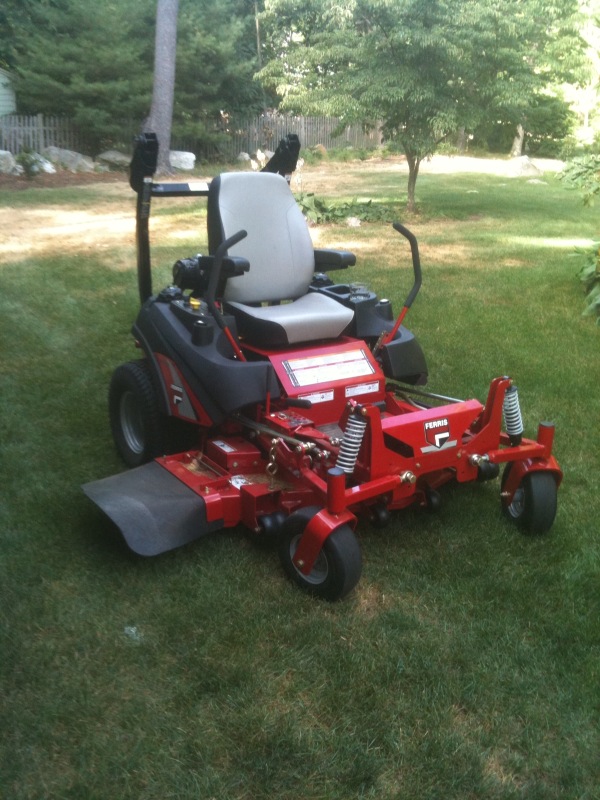

Pappy,
I have the IS2000 like you drove with high back seat, and the Kawasaki 25HP which has a full independent suspension on the front meaning the front forks connect to the deck and separate steel frame for a full independent setup. The IS700 has the rear wheel and front articulating (mostly up/down suspension)
I mow a lot a lot of rocky and rough terrain and love the ride and the cut is good too. I use gator blades on the 52" deck. If you can get the Ferris for a reasonable $, then it will serve you well.
BTW, the IS2000 weighs in around 1150Lbs so its not a lightweight, and I would imagine the Grasshopper with the diesel is about 1500 - the water cooling, and extra diesel engine weight, and I am not sure the CG is greatly different on either machine.

Yep, that looks just like the one I drove except it had the 61" deck. I trust that the Kawasaki FX730V has plenty of power to run the 61" deck. It's supposed to be a strong, dependable, commercial grade motor. I hear they have been having some trouble with their FX1000V big block motor, but any ZTR with that motor would be out of my price range anyway.
Kawasaki rates their motors as FR (residential), FS (entry level commercial) and FX (commercial). As far as I know, they made FR, FS and FX versions of the 730V motor.

Yes Pappy, you are correct - the FX is Kawasaki commercial line of engines, and the Ferris IS2000 will have the FX commercial engine with the dual carbs, HD Starter and Canister air cleaner. The FS as I understand does not have the HD starter or canister type filter but all other specs are similar.
My engine is the FH series- the predecessor to the FX, with the canister filter, dual carbs so its commercial grade. It starts on the second or third crank every time and runs great. Fuel consumption as Gary mentioned is almost half that of my cub cadet 18HP Kohler Magnum.
The closest I can figure on fuel, its about 3/4 gallon per hour and I do 2.5 acres with lots of turning due to planting beds and trees in 1.5 hours . Straight runs, you can cut 4 acres an hour I easily.
