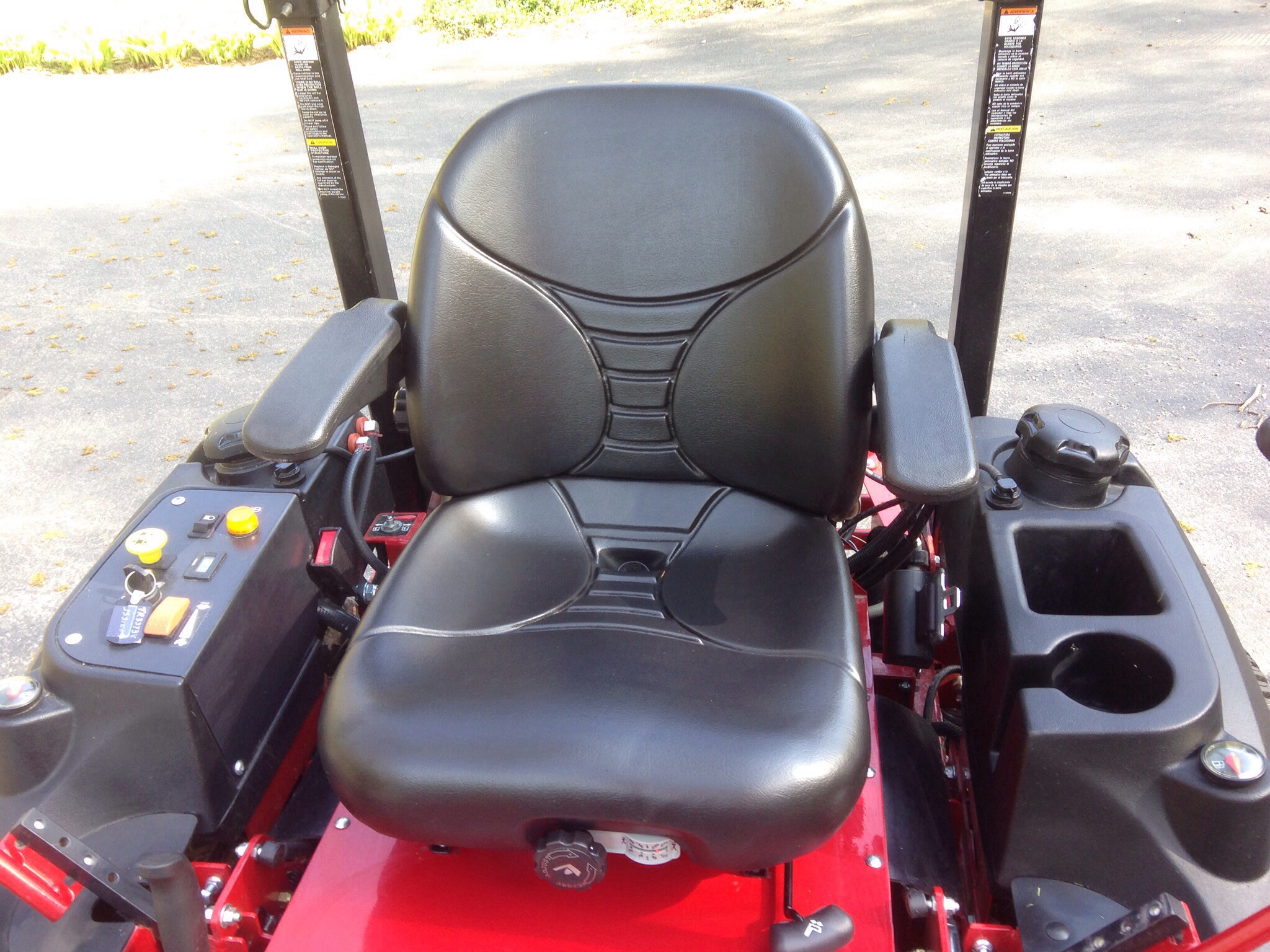

That looks like they stole the seat off my Kubota B26 and put on the Ferris mower.
   / So the search begins . . . for a new ZTR
#32
I mow a couple of miles of trails, around 150 newly planted trees and about 2 acres of lawn, all except the lawn is pretty bumpy. If your mowing area is pretty flat I don't know if you would see tons of difference between the Ferris and others with some sort of suspension. Where I did notice a difference was in the rough areas the Ferris was noticeably better.
I tried out a Super Z on my property and it was a little bit faster and the ride really wasn't that different in the smoother parts of the lawn. But there was a marked improvement in the ride with the Ferris in the rough areas. I did also purchase the upgraded suspension seat so it made it even nicer.
My dealer took the Ferris in on trade with 103 hours because the previous owner wanted a 72" deck. I really wasn't looking to go with the 3100 but it was one of those deals I couldn't pass up.
It does drink the petrol though. I guess that's why it has two tanks! :)
Good luck in your search!
That is a fine looking ride you've got there. I'm jealous.
