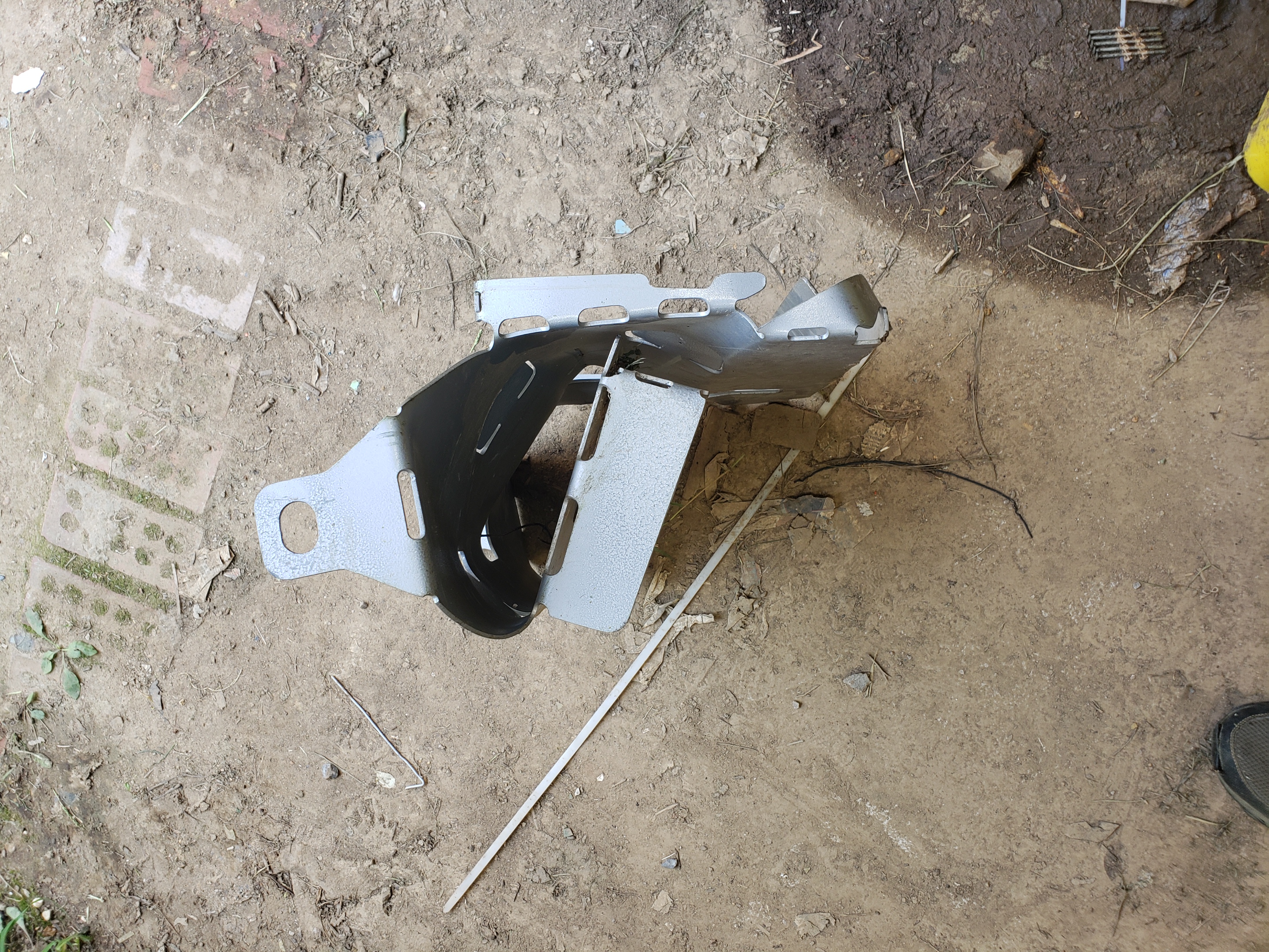

So, the very first time I used this protection plate it end up getting folded. I had the mounts on it perfect. It was in top position so it wasn't hanging down from the frame and somehow, someway, my brand new armor plate ended up folding like a burrito.
Anyone else have this problem? Would this be under warranty at all? This sucks. I was clearing brush and was being careful. I kept my bucket lower than the frame to push down brush so my flail mower could finish it on the other end. I pull up on my driveway and hear this aweful scraping noise and look under to find my armor destroyed.
Has this happened to anyone else? Am I pretty much on my own with this? I mean I don't see anything about warranty from BXPanded so I'm seriously upset about fishing out another $160 for a new one. I only want to use this kind and every single other thing I've gotten from them has been so awesome I want to keep loyal.

Think you may need to upgrade to a dozer with a set of forestry guards. On my BX2230 rarely take the mower off and have bent parts of the deck before but saved the fan.
Now on my Outlander 800MAX and RZR800S I have Ricochet Skid plates and have bashed those hard skidding over logs in the brush and had to beat them flat again.

Before I bought another "skid shield" I'd want to know EXACTLY what I did to cause that. Without that knowledge you are most likely to have it happen again. There HAS to be evidence - out where you mowed - that will tell you how it happened. EXACTLY what caused this.
It is strange that you didn't notice this the moment it happened. Good luck.
/ So this happened. BXPanded Underarmor destroyed. #4
The driveway is probably what did that. Did the bolts pull through the shield? Fall out? and was hanging down when you got to the drive.
A lot of times when you push a tree/bush the root ball will pop up behind the blade, in this case your bucket and roots will drag underneath whatever pushed it over.
So when ever you push over a good size ___ back up and look before running over it..

Ouch. I managed to do something like that with a BroTek belly plate. Not that bad, but had to drive over it with the pickup to straighten it.
In my case it was a problem with "the loose nut behind the wheel". Reminder to me to leave the equipment alone when sleep deprived.

It looks like the mid-mount was lowered, which drops the front of the under armor for removal. That would act like a plow and catch an immovable object and fold it back similar to how yours looks.
/ So this happened. BXPanded Underarmor destroyed. #7
On the BX, it's the rear of the under armor that's raised and lowered by the deck mounts. The only way I can see this occurring is if either A) One of the four mount points on the armor (two tabs in front that slide over bushings you bolt to the frame as part of the initial install; two holes near the rear that the MMM deck lift pins engage) wasn't correctly engaged; or B) the deck lift wasn't at "TOP" like you intended, but instead maybe one click off at "0" and you backed up with the armor down.
I'm not saying it's impossible to do what you did with the plate correctly installed, but it would be tough, I think.

With some heat, a crowbar and a sledgehammer I got it straight again. I had to bend some spots but eventually got it to a snug fit again. I double checked that the top position was correct and raised and lowered the implement and it stayed up in place. I guess it was just a freak accident because I was seriously just going through brush which was mainly thorns on top of thorns which was being nice and ripped up with the Pirahna tooth bar. So I am so confused with what happened unless the front arms were made too short and somehow one side fell off and got caught, or it twisted and one fell off.
There isn't really a big retaining washer on that front mount the two arms rest on, so I wonder if I add a big washer to it, if it was a small amount of sway that dropped the front it would keep it up on the frame. I don't know. I didn't stall or hit anything while working in the field. I did it for sure obviously but wow I wish I knew. Glad I was able to get it hammer and back to almost new and flat.

Good - you got it back into shape and back on. I guessed you would need a new one. I would recommend, now, that you use LokTite or similar product on all bolts.

Wow, not sure how that could happen, and not feel it, on a BX! Those plates are pretty stout, I have the same thing on my 2380.
As to the warranty, I can't see how this would be covered. What ever happened, it's unlikely the "fault" of the part. Never hurts to ask, tho.

Wow, that definitely did not do it's job. Is that aluminum or steel? Also, what's the thickness. Almost looks like thin aluminum that has been painted.

It's 1/8" steel. I can't imagine not feeling/hearing that happen on a 1500 lb machine! :shocked:

I cant think that 1/8" steel would be much of an armor. I would look for at least 3/16 and 1/4" would be even better.
Maybe a stiffener or two welded to the bottom of the armor would help, something like a piece of 3/16" x2" thick flat bar would work to stiffen up that plate.

+1 .125 mild steel is minimal for such an application on even a 1,500# tractor.
I've been using the BXpanded under armor on my BX for three years now, and I think it's more than adequate for the purpose--keeping sticks and brush from getting into the wiring, fuel line, driveshaft boots, and the HST fan underneath the frame. Will it dent if you high center on pointy rocks or angled stumps? Yeah, it probably will, though it will still do it's job. But a BX isn't a log skidder, and shouldn't be used like one. I don't know what went wrong with the OP's, but that's not something I can imagine happening to mine, even when driving over brush and overgrown, uneven trails (which I have a lot of on my property).

For the intended use/purpose of the shield, and the BX, it is completely adequate. When you start doing things you shouldn't be, or accidents happen, all bets are off. But that is neither the fault of the part, or the tractor.
