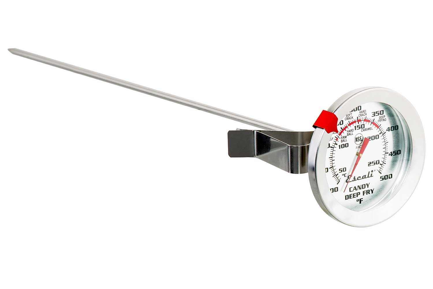

SNIP........ Kubota UDT is between 9 and 10 cSt at 100 degrees C so one could consider that to be the internal oil temperature limit - but where can you measure it? Easiest is using an I-R thermometer on the filter but that is the oil going into the hydro, the coldest part of the loop. SNIP.... .
Kubota says the high end temperature for their HST oil is between 40 to 60 degrees C.... Which is between 104 & 140F. I'd say that means keeping the fluid below 140F is going to be difficult when working in the summertime.
If I were going to use mine hard in the summer I'd certainly go for a high quality full synthetic oil. That wouldn't be a bad choice in any case.
Interestingly, John Deere - who makes and sells the very reliable JD310 loader/backhoe all over the world - has recently changed from recommending their Hy-Gard trans/hydaulic fluid to recommending that straight motor oil be used in their hydraulics. Recommendations are a minimum of 10W-30, with a 5/15W - 50 preferred. Those machines have a torque converter rather than a HST transmission, so they don't have the peculiar swash plate type sliding friction that HSTs do.
For measuring temperature there must be someone who makes a simple remote sensor that can be either inline or taped to a hydraulic hose. Anyone know of one?
Or you can do pretty much the same thing by using an old-fashioned $5.00 candy thermometer, a wad of insulation, and some tape.
rScotty

Knowing the hydraulic/trans temp would be valuable bit of information. Measured from a good reference point even better. Line, filter, cooler inlet, pump suction??? There might even be plugged port somewhere made for a temperature sensor? Next step if you have a reliable way to measure the HST temp, what must it be from cold startup to operation? Normal operating temp? High temp? How to interpret is the next hurdle. Started a separate post on measuring HST temperature.
