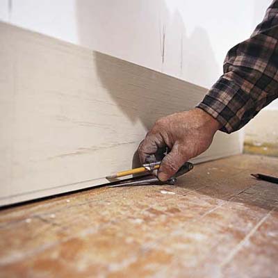

   / So what's the easiest way to square off this pipe? #32
then measuring from the base up all around the pipe will make for a square end. The other way to do it is to level the pipe horizontally and do the same thing on the ends.
or transfer the straight base to the pipe wall using a compass set to the size of the gap.
