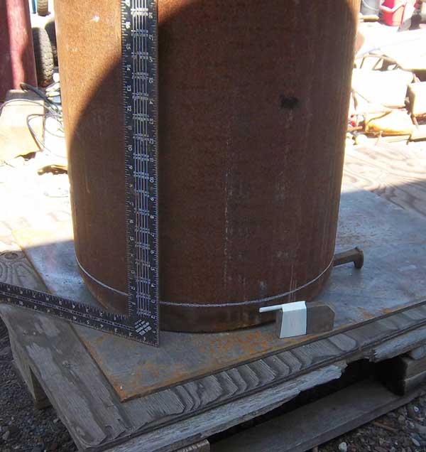

So what's the easiest way to square off this pipe?
   / So what's the easiest way to square off this pipe? #21
place pipe on upside-down furniture mover dolly and spin, mark it, then spin it into an affixed angle grinder ?
   / So what's the easiest way to square off this pipe? #22
Your looking for some "Pipe Wraparound" to mark your pipe. Then it's on to the cutting method of choice:D
As mentioned a shop with the proper pipe cutting torch may be your best bet. They can also bevel the cut if you wish.
But patience and an angle grinder will get you there.:D
Just for interest there are a number of pipe cutout templates on the market.
   / So what's the easiest way to square off this pipe? #23
I see enough material in the pic of the pipe and stove to make your wrap around. Those blue banding straps will work as a wrap around. Or you can take the lumber from the top of the new stove and nail them into a t square and lay it with the T hanging off the edge of the square end of the pipe and just slide it around the pipe while marking off the other end. An abrasive wheel on a skill saw can be used to make the cut, just follow your line. You might have to take your grinder with a cutoff wheel to get the cut started, but once you have a slot big enough for the saw blade to drop in, it will cut pretty fast. It will get plenty hot as you are sawing too, so it wont hurt to take a few breaks while you doing this. You will probably need the break time before your saw does
   / So what's the easiest way to square off this pipe? #24
How about a circular saw with an abrasive blade? (Free hand or in a roller jig)
   / So what's the easiest way to square off this pipe? #25
A roll of adding machine paper makes an ok wrap around. With pipe sitting up rite, level, make mark and use 2 foot level going around pipe marking every couple inches at desired height. Once 1 end is done simply measure from that line to other end of pipe and mark around. Next way level pipe up rite on floor, measure up from floor every couple inches alway around.
   / So what's the easiest way to square off this pipe? #26
The wrap-around needs some width proportional to the diameter or it won't square up. A straight-edged strip about 10-12" wide cut out of the stove box would probably work as long as the corrugations are parallel to the pipe and you get a tight wrap. A roll of aluminum flashing would be perfect. Take your time and tape it in place to make an accurate, clearly visible mark. Use a black or silver sharpie, whatever gives the best contrast.
   / So what's the easiest way to square off this pipe? #27
I saw there was a response and had a light bulb moment!:shocked: Stand the piece of pipe up on the flattest surface you have. Then shim it so a 2' square lines up all the way around the pipe. Then you can measure up to get a straight cut. If you shimmed the flat surface so it was level in all directions, you could use a 2' level on the side of the pipe to do the same thing. If the base is level and the pipe is standing level vertically, then measuring from the base up all around the pipe will make for a square end. The other way to do it is to level the pipe horizontally and do the same thing on the ends.
   / So what's the easiest way to square off this pipe? #28
The 2 methods to mark mentioned will work.
The wrap around using felt marker or even rattle can spray paint.
Flat surface and block + felt marker.
To cut, skill saw with abrasive blade and hand held would work pretty well. I also have cut 1/4" with a VS jig saw at low speed with a bit of cutting oil.
Might be easier/faster to cut the circle ends to a tight inner fit and weld the ends finishing with a grinder.
The fastest is probably the skill saw method.
   / So what's the easiest way to square off this pipe? #29
See Picture.
I would think by now you would have pipe cut & be 1/2 done with the build???
