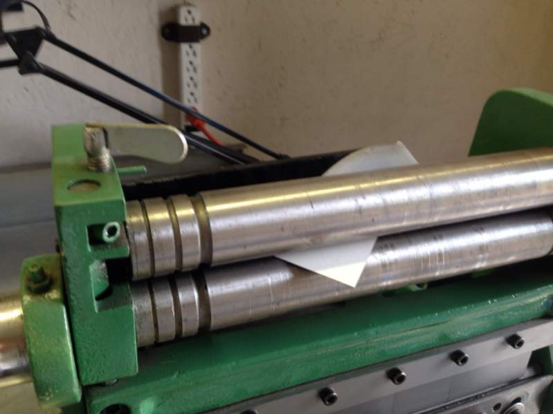

Here Carl. I got the dumb ***** behind the camera to take the cover off the 12" slip roll. Piece of 20 gauge in the pic for example.
Terry
