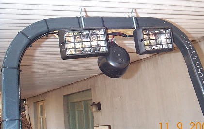

It cost me less than $50, and it took an evening to put a light bar on my tractor.
It meets all the concerns expressed above by Woodlandfarms and Schism.
I can light up about an acre with the new lights, plus I can see behind me. I don't even use my headlights anymore.
A set of adjustable off-road lights were about $18. A rear tractor light was about $9. A wiring harness, with weather-proof switch, fuse, and relay was about $10. Other miscellaneous, like cable ties and splices were about $10. All came from Wal-mart.
I mounted the lights to a pressure treated 2 x 2, which I mounted to the ROPS with U-bolts.
On my tractor, there is an auxilary line that runs from the fuse panel to the ROPS. It has voltage whenever the key is turned on. I used it to control the relay through a the new switch. The voltage to the lights runs through the relay.
I mounted the fuse directly to the battery (+) terminal. The other side runs to the relay, mounted at the bottom of the ROPS. I got ground (-) at my tail lights.
Knute

only thing about that is the fact I have a backhoe and I think I will smack my head on anything hanging down off the top of the ROPS. I might try hooking some on the top of the fenders though.

Turning the lights around around would be very easy. Aslo, if the occasion arrises where I would rather mount them to the fender, loader arms, behind the seat (or anything metallic :D ) it takes two seconds. When I am doing anything in during the daytime (mowing) I canm just pop thhem off and stickem to the beer fridge in the garage.

I'm an idiot when it comes to electronics. I know what positive, negative and ground mean. I know where the battery is and where the fuse box is....but that's about it. I think I could wire a switch.
My tractor still has a good bit of warranty on it. Messing up the electrical system worries me. But, it seems to me that the easiest approach (for a dimwit like me) would be splicing into the wires that go to each of the existing headlights and running them back up to the lights on the ROPS. Is there a special connector for this type of splicing?
Someone who mentioned this approach said I might need a larger fuse. I have no idea what amp fuse the headlights run off of, but how do I know how much larger fuse I need? Do I double the amps? I'm assuming the existing headlight circuit is grounded. Would I need to add additional grounding for the additional lights?
Also, under each fender, just below the warning/turn lights, there is a small wiring connector hanging down with nothing plugged into it. I wonder if I could run some lights off of those. My primary concern is that they would blink like the warning or turn signal! :eek: Anyone have any idea about these? (Its a Kubota L4400).
Thanks for the help and the patience. This is something I'd really like to do and there really isn't anyone nearby for me to pay to do it. So its me or no one.
   / So... why are the headlights in the front? #20
You shouldn't just tap off of the headlights. Chances are the wire is too thin to handle any more current. Don't change the size of the fuse, more than likely you will overload the wire and cause the tractor to burn-up. As far as grounding goes, the headlights is grounded - not the circuit. You would still have to provide a ground for your new lights - though like I said you shouldn't do that. You could get a wire tape to tap into the existing headlight wire to be the "switch" side of a relay. Then power them directly from the battery via fused link. If you aren't sure how to do this, you really should take it somewhere to someone that knows how to do it vs. burning something/someone up.
