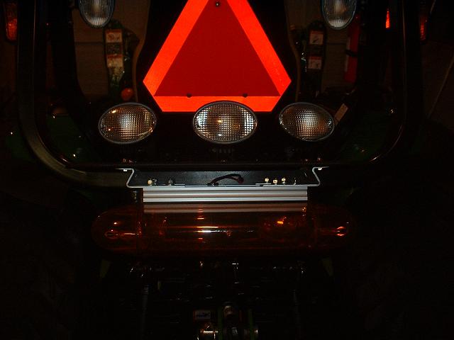

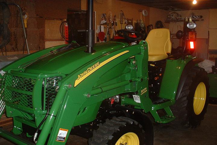

I have installed 3 work lights on my JD 3120.I have the forwarding lights that are mounted over the warning lights but due to them blinding me everytime I look to the back I got good dose of light burn.I mount the 3 lights on the ROPS where I had bolts for my beacon light.They work awsome.
matthew3120
