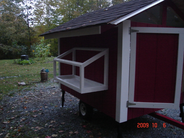

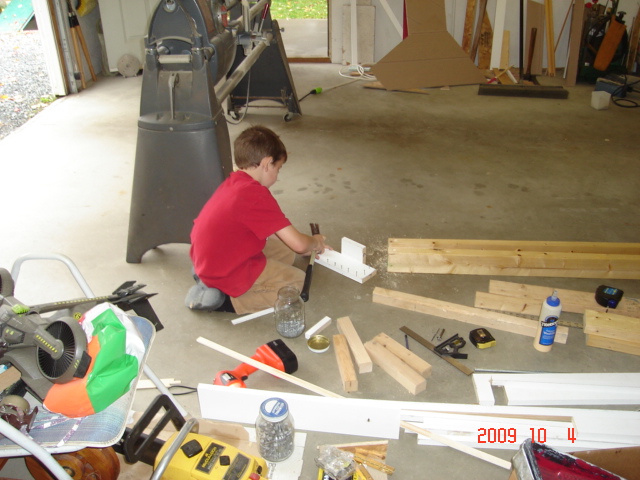

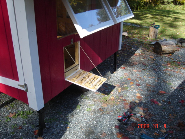

Well, it's been slow progress lately, but I finally finished the nest box frame, primed it, and mounted it to the outside of the "house." It's supported by two 2x4s that go along the length, on the inside, one at the floor of the nest box frame & one along the top. Chicken access door also sorta completed- we'll see how long those chains last!
My idea is to cut access holes into the nest box on the inside, leaving a lip of 3-4", and adding a piece of 2x6 --or similar-- as a "landing" in front of the access holes. It just takes me soooo long to figure out how do to what I can see in my head (once I get to that stage, at least!:eek:).
Meanwhile, the "girls" are getting bigger.... And I'm still getting lots of help & advice from grandson..,:rolleyes:

   / So you wanna have chickens, eh? #29
Are you planning to gather eggs from the inside of the coop or the outside? I made a coop awhile back that allowed me to gather eggs without entering the coop. I simply installed a hinged roof on the nest box. You can even match the coop's roof if desired. Just a thought. Mike.
#30
Exactly the plan, Mike, even right down to the matching 6:12 roof pitch (though I'll admit it doesn't look that way in the photo...):D
