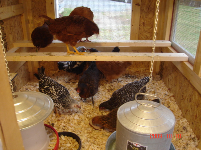

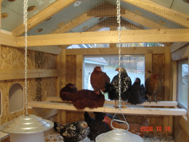

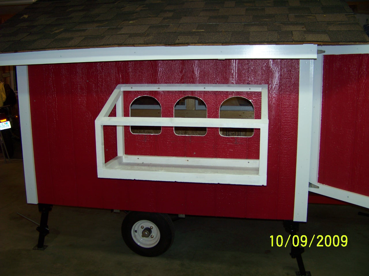

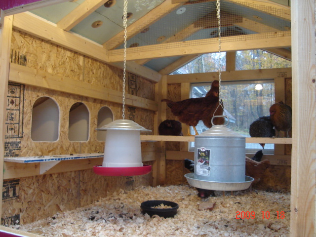

More progress. Actually, chickens are now --as of yesterday-- moved into their new house! Have to take some more pics, but I've been laid up with --the flu? Strep? Don't know.....
They seem to enjoy their new space, with a lot more room. Still have to complete the hinged cover for the nest box(es); right now it's just temporary. Electric is done- a switched (or timered) light, and a 4X outlet in the ceiling for water heater, etc- whatever comes up....
A few problems, though- although some are using the 2x4 roosting area (flat side up, which they seem to like), they're hopping/flying up into the "rafters" to get higher, which puts them within pecking distance of the syrofoam in the roof; looks like I'll have to cover it all up....:(
On the other hand, with the food & water now hanging abover the floor, they're no longer getting filled up with wood chips every night!!:D:D

   / So you wanna have chickens, eh? #32
Irvingj- Your project is looking quite nice and coming along well. Chickens like height at night due to a sense of security. So you will have to devise a way to keep them off the rafters by not allowing them to get a toe hold. They will then move to the roosting bars you designed for them. Perhaps some sort of baffle on each rafter would do the trick. Mike.

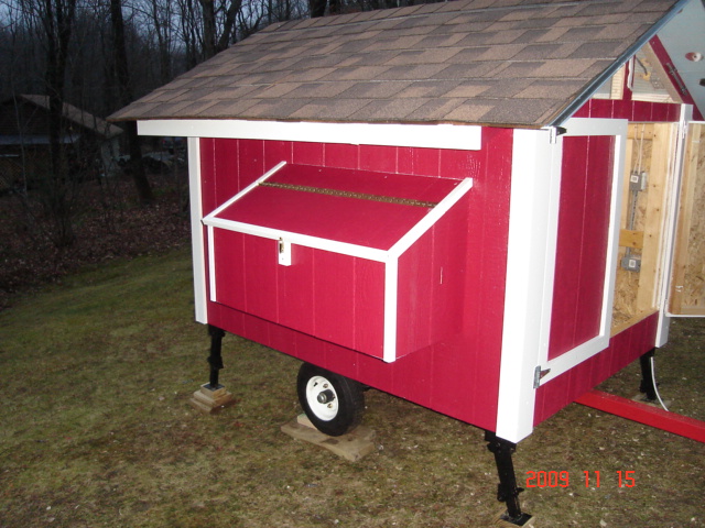

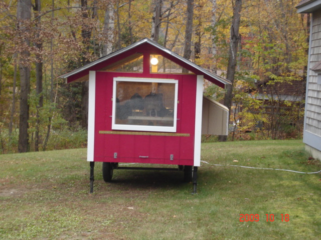

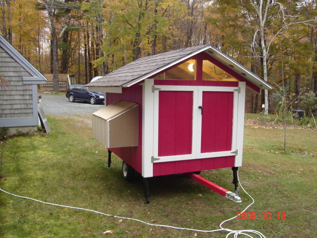

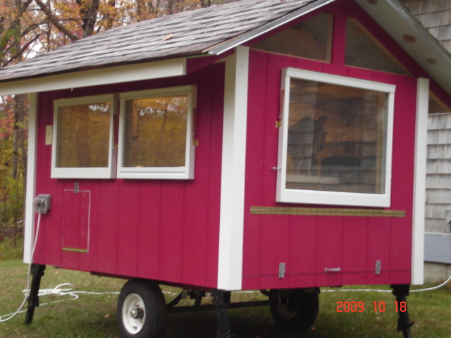

Here's some "final" shots-- all that's left is to fabricate the nestbox hinged lid (and some more red paint!)... and a few other minor finish-up details.
The design idea I had for the windows seems to work well- some cheap slide-type lid supports and some thumb screws, and now I can open the window up to any point shy of 45 degrees and hold it in place there. Because of the foam rubber gasketing material on the inside edges of the window frames, a good amount of pressure applied against the window allows the hook locks to snap in place. Seems real secure, and should shut out any drafts.
Still have yet to devise a way to reduce or block gable vents... the "girls" spent their first night outside last night. They were pretty well huddled together this AM- it was only about 29 degrees here; looks like there's a few snowflakes on the roof, too! "OOOH! Look! Bread!!"
Oh, Mike- A piece of hardware cloth tacked up from the center tie-beam to the rafter has blocked their access to the rafter. Not so much of a problem being up there, but when they came down they were crashing into (and spilling) the water & food dishes. Better to prevent access altogether, I think.

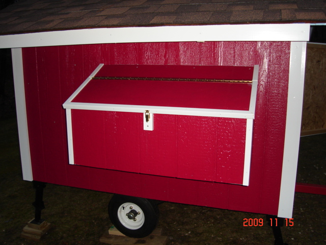

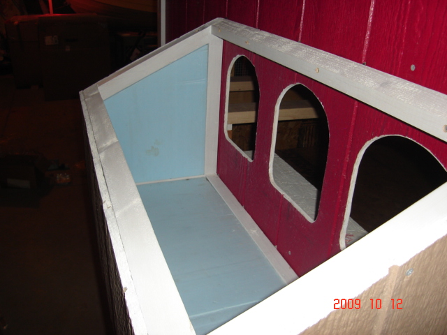

Finally, the hinged nest box lid is on (man, am I slow!!).
One of the girls laid her first egg last week, think it was the smaller of the two Americaunas, as the egg was bluish. Should have a nice supply of fresh eggs soon! Artist grandson had to commemorate the event with a sketch.
So, other than a few details, I guess it's done. Now on to OTHER projects that have been put on hold all summer & fall....
Thanks for all the advice & suggestions! (Now, we'll see how well my work holds up...)

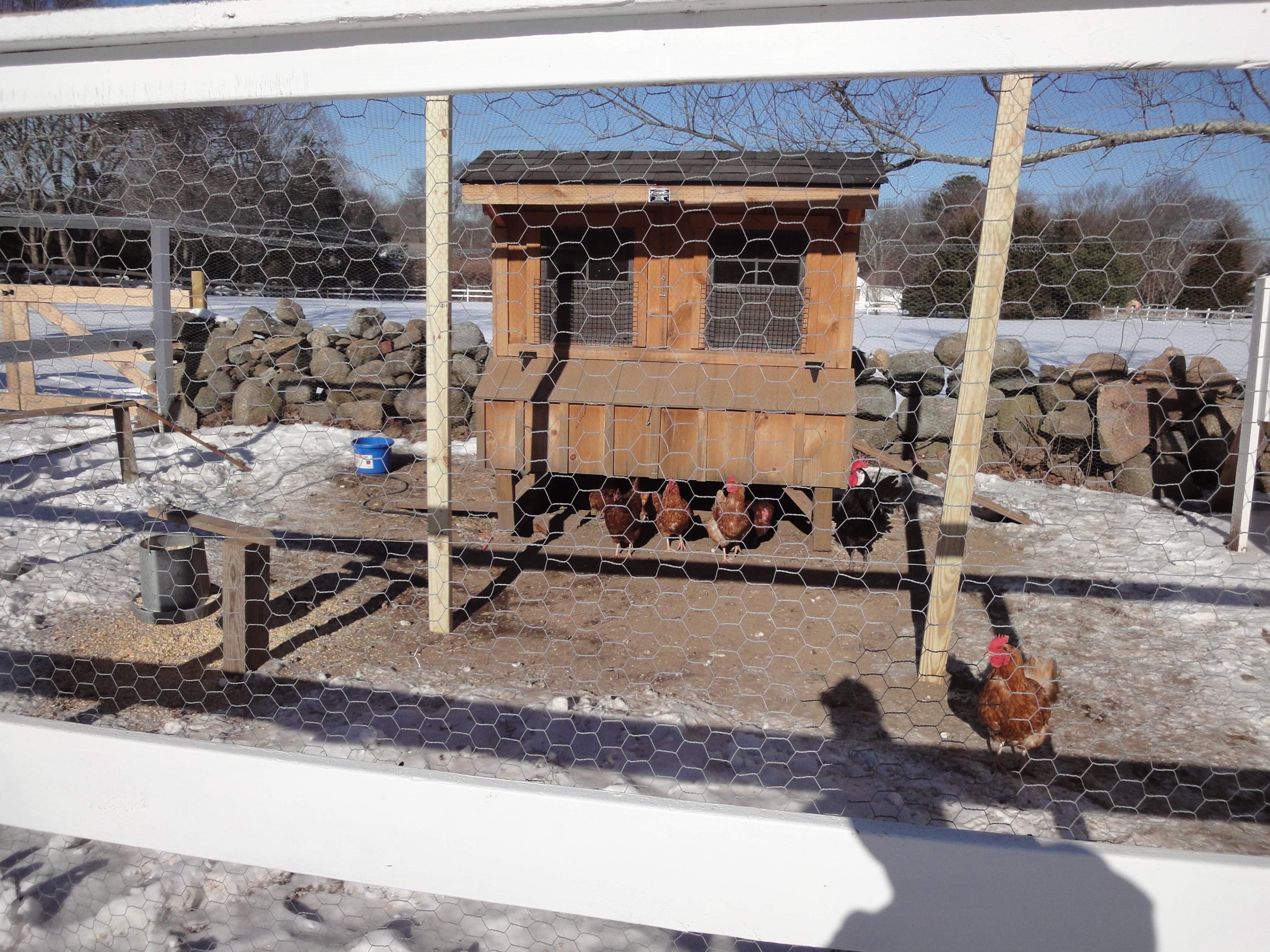

   / So you wanna have chickens, eh? #40

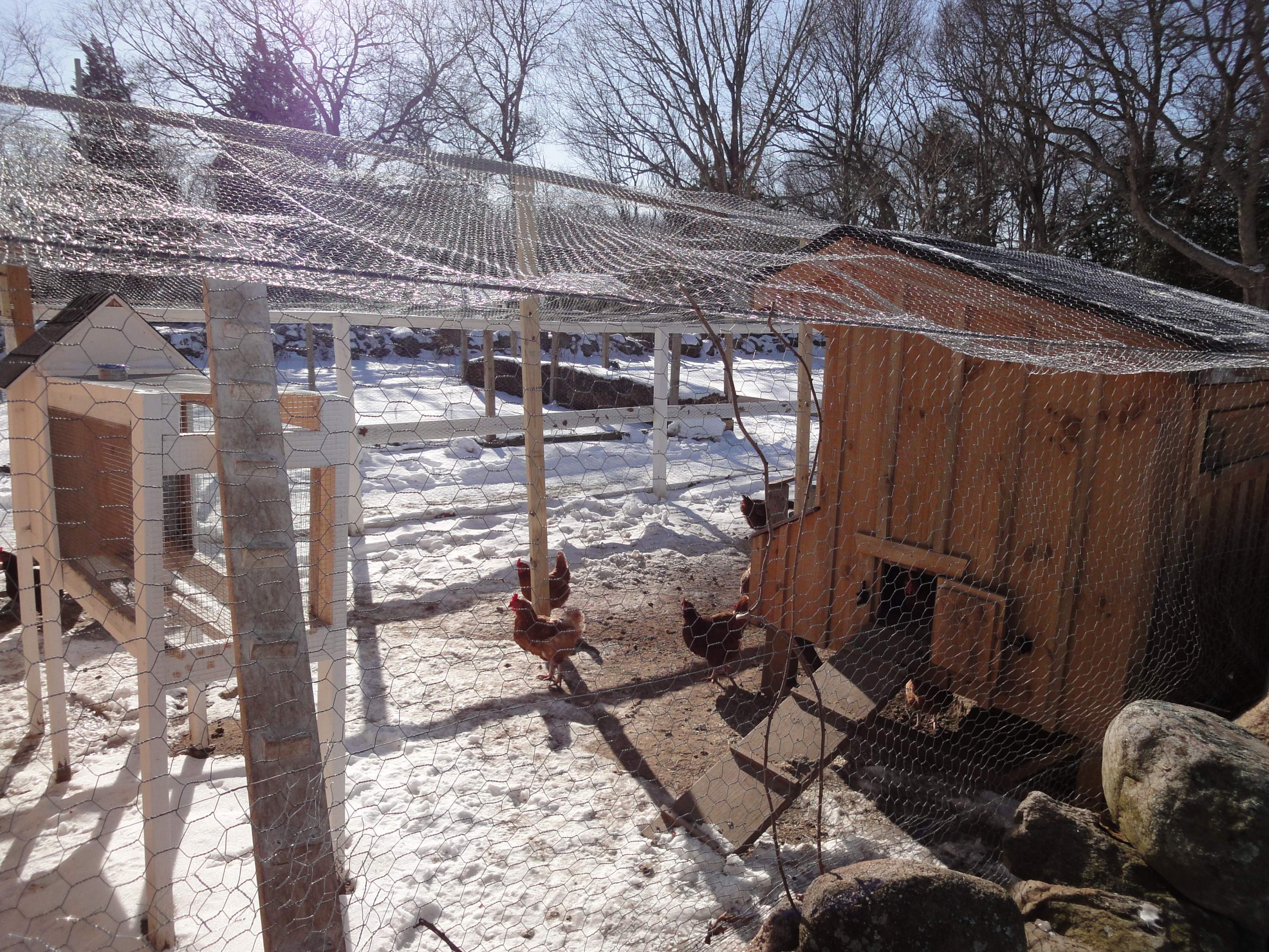

thats a really nice coop you built! i love the idea of putting it on a trailer to be easily moved, the chickens also look very happy;) here is my coop, i just made a top for it and now it is hopefully critter-proof it does not have any bells and whistles, but it works for my 13 chickens:)
