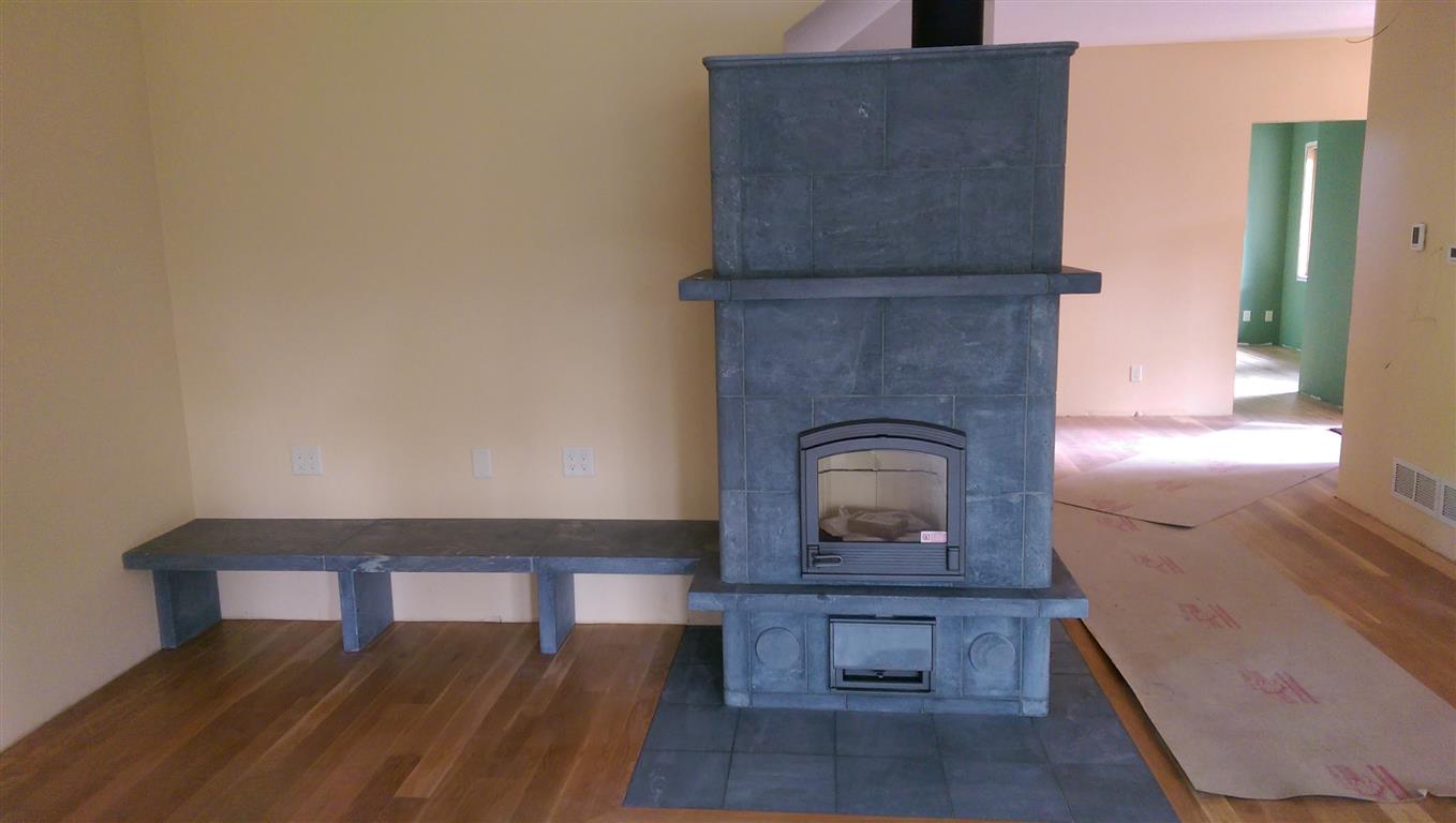

My experience is much different than CalG's. We have a soapstone fireplace (well "masonry heater" if you want to be picky...). It is Finnish from the Tulikivi people. The local dealer builds up orders for several months, and then gets a shipping container's worth of them at once, as they are all build to order. They quarry it locally in Finland, as I understand it. It picks up oil like crazy. If you are sweating and touch it - dark fingerprint. Leave a cordless drill with rubber grip sitting on it - dark spot where the rubber touched it. Anything oily and it leaves a mark. You can remove stains to a degree with soap, water and scrubbing, but that it a lot of effort that you would need to do frequently to keep it pristine. We could seal it, but I think that unwise on something that gets fairly hot. Perhaps it has something to do with where the material comes from. Different quarries may have very different properties - I can't say one way or the other. What I can say, is that ours is far from "unaffected by anything" as it stains like crazy from anything oily at all. Everything stone in the pic is soapstone, and was part of the install. I like it overall, but the oil stain issue is a hassle. Using it in a kitchen without sealing would seem to be pure folly based on my experience. You will probably have to seal it often too. If that works for you, then go for it.
This is why you need to buy good quality soapstone... they are not all apples to apples.

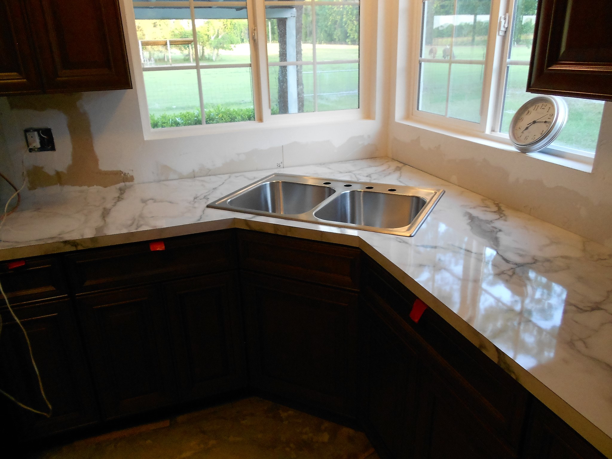

I am finishing up a kitchen remodel/full gut and will add my 2 cents.
With an "L", a large island and a straight section of counter tops needed (92 sq ft) I priced granite. COUGH!! COUGH!!
For what I needed and liked they wanted $7900.00 installed!!!
I ended up going with Laminate, make my own.
Total Cost including partical board, a new router and belt sander- $600.00 !!!
I watched a bunch of utube videos on how to and it turned out great.
Call me CHEAP! But I kept fast forwarding to when I am dead and gone and the new "Latest and Greatest" comes along and they take a sledge hammer to remove that old granite.
Also, to me most granite looks like Vomit.
I know it's not soapstone, just giving an opinion from the cheap seats.

Same here. This was not "cheap stuff". These guys have been around a Looong time and know what they are doing, but this is the reality of soapstone; it picks up oils readily. It sounds like CalG agrees with me on that point, but likes the way it looks with age. That is a personal preference which is perfectly fine. Perhaps that makes more sense on a countertop, but on the FP it makes it looks like there is a spot there that "isn't right"
As for the question on wood use, I can't give you a good answer, yet. I have been so busy building the place that i have not have enough time to stock any real amount of firewood. We used about 1 face cord the first winter and a little less than that last winter. Only because i did not have time to prep any more. We could have easily used a ton more, but my wife does not understand the act of keeping the FP going, and I am too busy building to tend to it.
The one HUGE downside to this FP that I did not realize until install was that it requires 12" wood. Good luck finding that. I have had to chop down 16" wood to 12" (keeping the cutoff blocks, of course) so far. I Have used a crappy chop saw for that. When I get into making my own, i will naturally just cut to 12" from the get go. That is, IMO a MAJOR mistake on the part of the manufacturer. Know your market, and don't sandbag them. Yeah yeah 12" burns "better" but if you can't find it, it doesn't burn at all.
